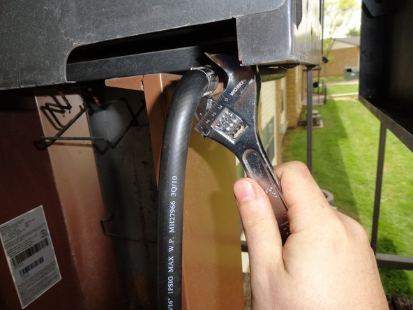

    • Completely close the propane tank by turning the valve on the top clockwise. This prevents propane from leaking during the replacement.
    • Breathing in or swallowing propane can harm your health.
    • Turn the knob on the hose counter clockwise to disconnect it from the tank.
  2. Propane Grill Regulator & Hose Replacement: crwdns2935265:02crwdnd2935265:01crwdnd2935265:02crwdne2935265:0 Propane Grill Regulator & Hose Replacement: crwdns2935265:02crwdnd2935265:02crwdnd2935265:02crwdne2935265:0
    • Find the electric igniter on the grill and turn it counter clockwise to reveal one AA battery.
    • Replace the old battery with a new one.
  3. Propane Grill Regulator & Hose Replacement: crwdns2935265:03crwdnd2935265:01crwdnd2935265:01crwdne2935265:0
    • Locate the orifice that connects the base of the grill and the hose to one another.
    • An orifice is a valve commonly found on gas powered home products. This allows the gas to pass through from the source (i.e the propane tank) and burn properly.
    • Conncected to the orifice should be a nut. Use the crescent wrench to turn the nut counter clockwise and remove the hose from the base.
  4. Propane Grill Regulator & Hose Replacement: crwdns2935265:04crwdnd2935265:01crwdnd2935265:02crwdne2935265:0 Propane Grill Regulator & Hose Replacement: crwdns2935265:04crwdnd2935265:02crwdnd2935265:02crwdne2935265:0
    • Begin hand tightening the new hose to the nut that is connected to the orifice.
    • If you over tighten the bolt or do not hand tighten it first, you could cross thread the orifice and create more problems for the grill.
    • Once it has been adequately hand tightened use the crescent wrench to finish securing it to the orifice.
