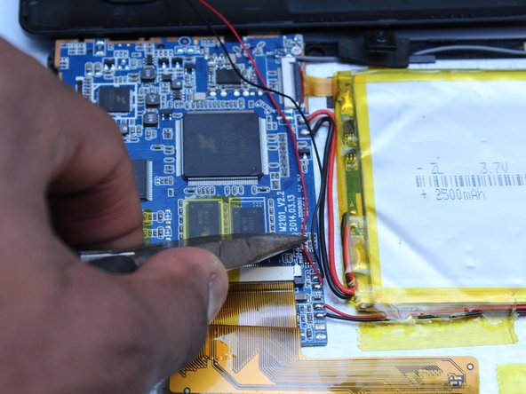

      • Disconnect the red wire connecting the speaker to the motherboard by using a soldering iron to melt the contact point.
      • Once the solder is melted, use pliers to pull the wire away from the motherboard

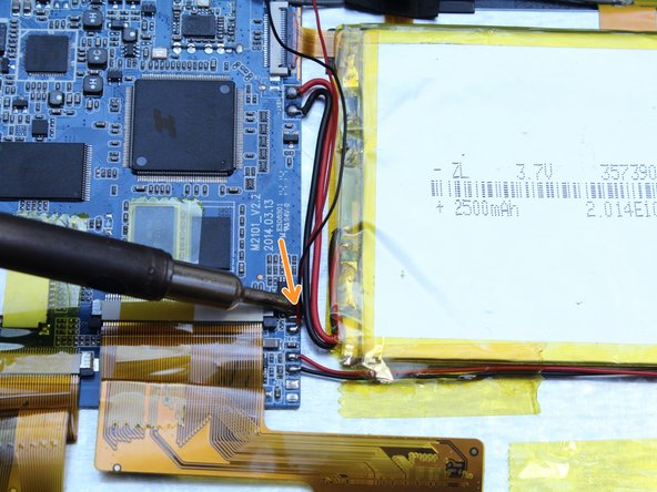

      • Repeat Step 4 with the black wire connecting the speaker to the motherboard.
      • Don't leave the soldering iron too long on top of the wire so it doesn't melt any other component in the motherboard or surrounding the area.
      • If soldering is new to you, check out this helpful guide on soldering and desoldering connections.

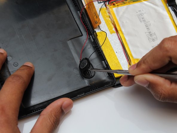

      • Using a spudger gently remove the speaker from the back of the device.
      • When working with electronics, it's important to choose a tool that's ESD-safe to avoid accidental damage to the device. The metal spudger is great when you need serious prying power, but the regular black nylon spudger should be used whenever possible.
