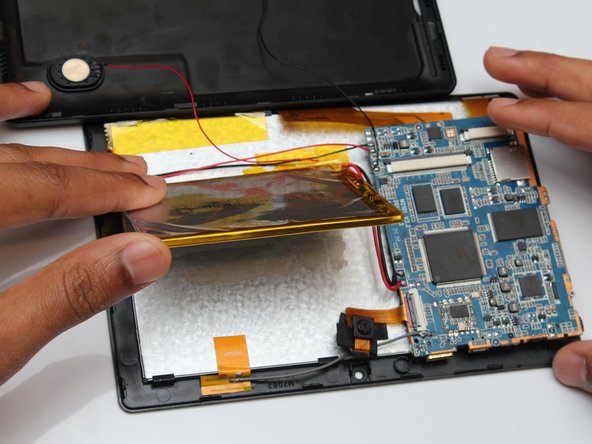

    3. ProntoTec Axius Screen Replacement: crwdns2935265:03crwdnd2935265:01crwdnd2935265:01crwdne2935265:0
      • Gently remove the back case of the device and lay it in a flat surface as shown in the photo.
      • Make sure not to sever the wires (red and black) connected to the speaker that is located in the back case.

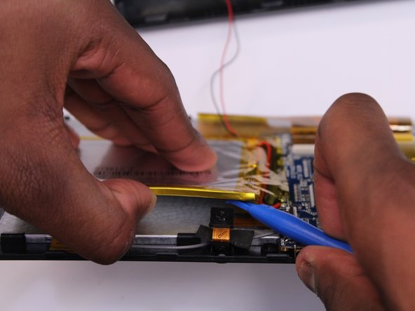

      • Use the flat end of the spudger to gently pry the battery from the back of the screen.

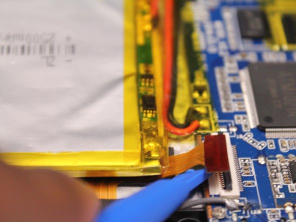

    6. ProntoTec Axius Screen Replacement: crwdns2935265:06crwdnd2935265:01crwdnd2935265:02crwdne2935265:0 ProntoTec Axius Screen Replacement: crwdns2935265:06crwdnd2935265:02crwdnd2935265:02crwdne2935265:0
      • Use a spudger to lift all the ribbon cable clamps
      • Detach all three ribbon cables from the clamps

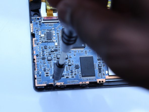

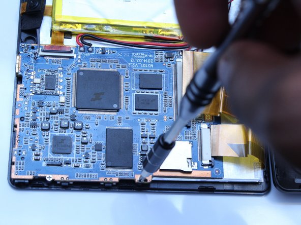

    7. ProntoTec Axius Screen Replacement: crwdns2935265:07crwdnd2935265:01crwdnd2935265:03crwdne2935265:0 ProntoTec Axius Screen Replacement: crwdns2935265:07crwdnd2935265:02crwdnd2935265:03crwdne2935265:0 ProntoTec Axius Screen Replacement: crwdns2935265:07crwdnd2935265:03crwdnd2935265:03crwdne2935265:0
      • Using a Phillips screwdriver (PH00), unscrew the motherboard from the device

      Heavy-Duty Spudger
      • Use the flat end of the metal spudger to remove the battery from the back of the screen of the device.
      • Avoid using metal when prying off the battery. For serious prying power, try using the heavy-duty plastic spudger.

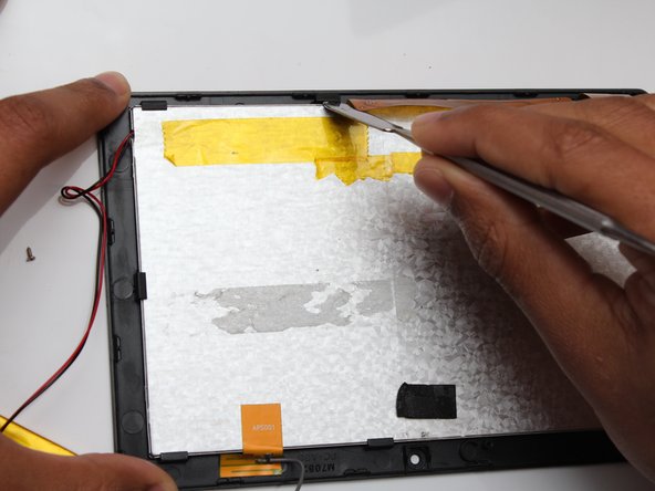

    9. ProntoTec Axius Screen Replacement: crwdns2935265:09crwdnd2935265:01crwdnd2935265:01crwdne2935265:0
      • Remove the orange tab from the back of the screen as shown in the picture
    10. ProntoTec Axius Screen Replacement: crwdns2935265:010crwdnd2935265:01crwdnd2935265:02crwdne2935265:0 ProntoTec Axius Screen Replacement: crwdns2935265:010crwdnd2935265:02crwdnd2935265:02crwdne2935265:0
      • Use the flat end of the metal spudger to unclip and remove the screen from the casing.
