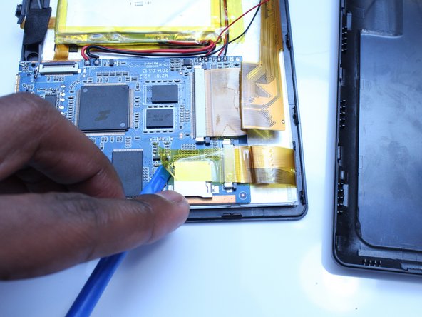

    4. ProntoTec Axius Motherboard Replacement: crwdns2935265:04crwdnd2935265:01crwdnd2935265:02crwdne2935265:0 ProntoTec Axius Motherboard Replacement: crwdns2935265:04crwdnd2935265:02crwdnd2935265:02crwdne2935265:0
      • Remove only the yellow tape that touches the motherboard
      • Be careful not to cut or damage the wires (red and black) that connect the battery to the motherboard.

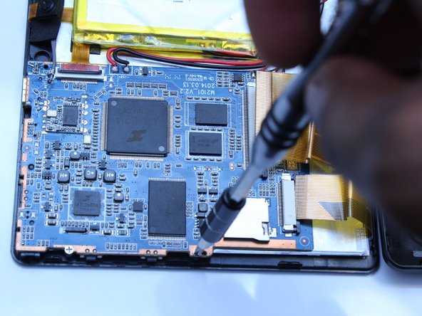

    5. ProntoTec Axius Motherboard Replacement: crwdns2935265:05crwdnd2935265:01crwdnd2935265:03crwdne2935265:0 ProntoTec Axius Motherboard Replacement: crwdns2935265:05crwdnd2935265:02crwdnd2935265:03crwdne2935265:0 ProntoTec Axius Motherboard Replacement: crwdns2935265:05crwdnd2935265:03crwdnd2935265:03crwdne2935265:0

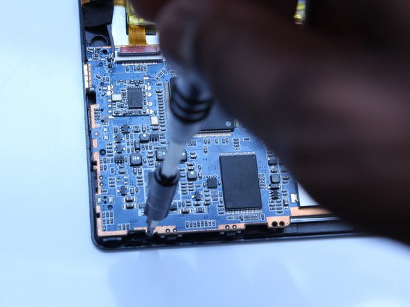

      • Use a Phillips screwdriver (PH00) to unscrew the two screws that connects the motherboard to the device
      • Be careful not to cut or damage the wires (red and black) that connect the motherboard to the battery.

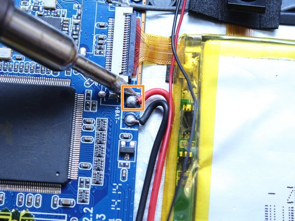

    6. ProntoTec Axius Motherboard Replacement: crwdns2935265:06crwdnd2935265:01crwdnd2935265:02crwdne2935265:0 ProntoTec Axius Motherboard Replacement: crwdns2935265:06crwdnd2935265:02crwdnd2935265:02crwdne2935265:0
      • Using a soldering iron, desolder the contact points of the speaker, battery and screen on the motherboard
      • If soldering is new to you, check out this helpful guide on soldering and desoldering connections.
      • Use pliers to pull the wire from the board

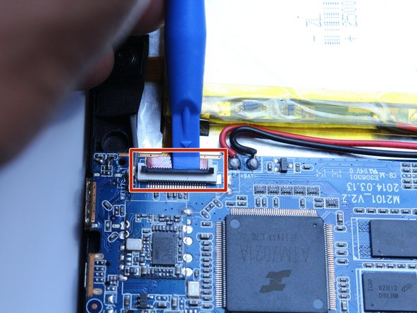

      • Using the spudger, disconnect the ribbon cable connecting the camera to the motherboard

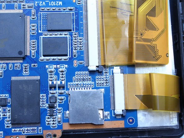

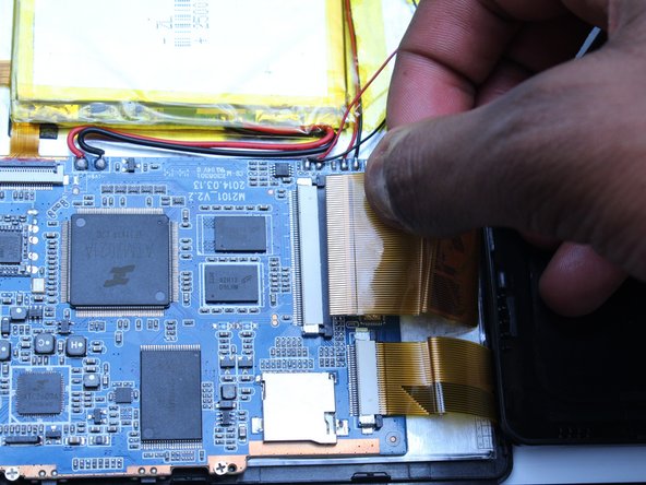

    8. ProntoTec Axius Motherboard Replacement: crwdns2935265:08crwdnd2935265:01crwdnd2935265:03crwdne2935265:0 ProntoTec Axius Motherboard Replacement: crwdns2935265:08crwdnd2935265:02crwdnd2935265:03crwdne2935265:0 ProntoTec Axius Motherboard Replacement: crwdns2935265:08crwdnd2935265:03crwdnd2935265:03crwdne2935265:0
      • Using the spudger, push the black tabs towards the ribbon cable to unlock the ribbon cables that connect the screen to the motherboard.
      • Gently pull and remove the ribbon cables from the motherboard

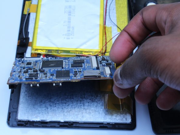

    9. ProntoTec Axius Motherboard Replacement: crwdns2935265:09crwdnd2935265:01crwdnd2935265:02crwdne2935265:0 ProntoTec Axius Motherboard Replacement: crwdns2935265:09crwdnd2935265:02crwdnd2935265:02crwdne2935265:0
      • Using the flat side of the spudger, lift up the mother board to disconnect from the screen.
