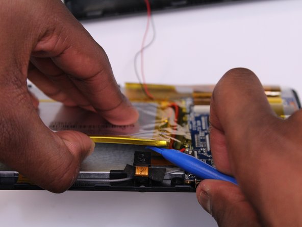

    4. ProntoTec Axius Camera Replacement: crwdns2935265:04crwdnd2935265:01crwdnd2935265:01crwdne2935265:0
      • Remove only the yellow tape that touches the battery.
      • Be careful not to cut or damage the wires (red and black) that are under the yellow tape.'

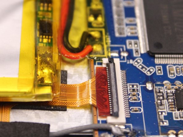

    5. ProntoTec Axius Camera Replacement: crwdns2935265:05crwdnd2935265:01crwdnd2935265:02crwdne2935265:0 ProntoTec Axius Camera Replacement: crwdns2935265:05crwdnd2935265:02crwdnd2935265:02crwdne2935265:0
      • Use the flat end of the spudger to gently pry the top left corner battery from the back of the screen in order to access the camera.

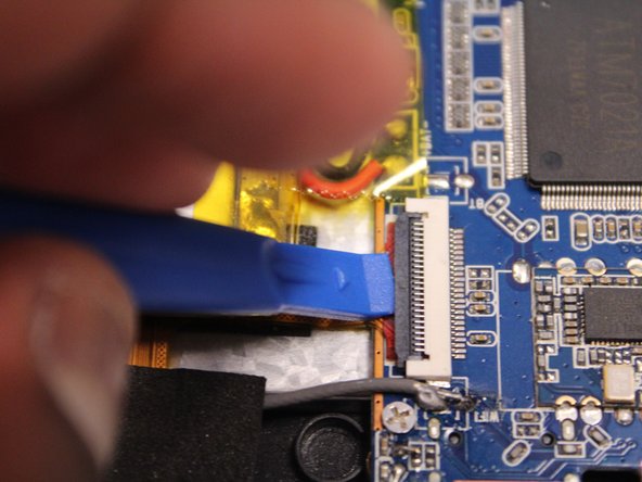

    6. ProntoTec Axius Camera Replacement: crwdns2935265:06crwdnd2935265:01crwdnd2935265:03crwdne2935265:0 ProntoTec Axius Camera Replacement: crwdns2935265:06crwdnd2935265:02crwdnd2935265:03crwdne2935265:0 ProntoTec Axius Camera Replacement: crwdns2935265:06crwdnd2935265:03crwdnd2935265:03crwdne2935265:0
      • Use the spudger to lift the black clamp as shown in the photo to disconnect the camera from the motherboard.

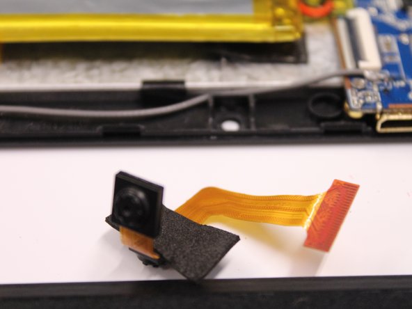

    7. ProntoTec Axius Camera Replacement: crwdns2935265:07crwdnd2935265:01crwdnd2935265:02crwdne2935265:0 ProntoTec Axius Camera Replacement: crwdns2935265:07crwdnd2935265:02crwdnd2935265:02crwdne2935265:0
      • Disconet the camera from the motherboard.
      • Pull the camera from the back of the screen.
