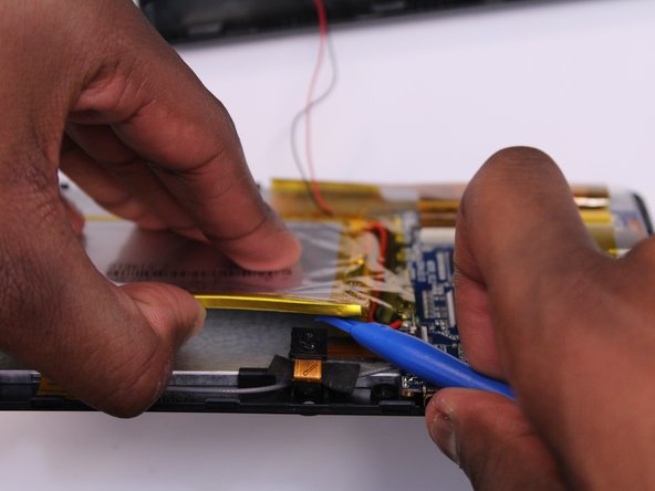

  4. ProntoTec Axius Battery Replacement: crwdns2935265:04crwdnd2935265:01crwdnd2935265:01crwdne2935265:0
    • Using a spudger remove all the tapes that touches the battery.
    • Be careful not to cute any wires that are under the tapes
