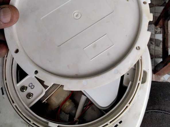

Prolife Airpot Model YTA-538AP Disassembly Only
  1. Prolife Airpot Model YTA-538AP  Disassembly Only, Removing the base from the device: crwdns2935265:01crwdnd2935265:01crwdnd2935265:03crwdne2935265:0 Prolife Airpot Model YTA-538AP  Disassembly Only, Removing the base from the device: crwdns2935265:01crwdnd2935265:02crwdnd2935265:03crwdne2935265:0 Prolife Airpot Model YTA-538AP  Disassembly Only, Removing the base from the device: crwdns2935265:01crwdnd2935265:03crwdnd2935265:03crwdne2935265:0

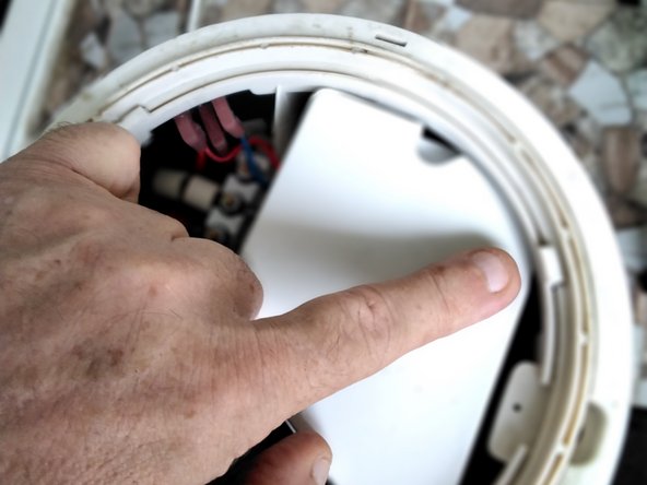

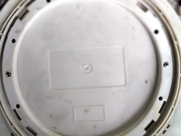

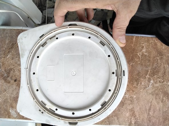

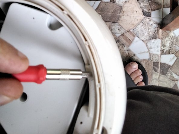

    • Two small Phillips head screws hold the round base plate
    • The second photo shows the screws partially removed as they are not easily viewed in photo 1
    • Lift the base plate and set it aside You may wish to tape the screws to the plate so they don't get lost,

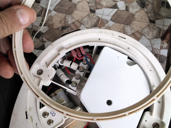

  2. Prolife Airpot Model YTA-538AP  Disassembly Only, Remove the "lazy Susan" Ring: crwdns2935265:02crwdnd2935265:01crwdnd2935265:03crwdne2935265:0 Prolife Airpot Model YTA-538AP  Disassembly Only, Remove the "lazy Susan" Ring: crwdns2935265:02crwdnd2935265:02crwdnd2935265:03crwdne2935265:0 Prolife Airpot Model YTA-538AP  Disassembly Only, Remove the "lazy Susan" Ring: crwdns2935265:02crwdnd2935265:03crwdnd2935265:03crwdne2935265:0
    • Three plastic 'clips' retain the ring
    • use a flat head screwdriver, spudger or other pry tool to pry the clip off the base of the ring and simultaneously lift the ring above the engagement point,
    • Repeat this for all three clips and set the ring aside

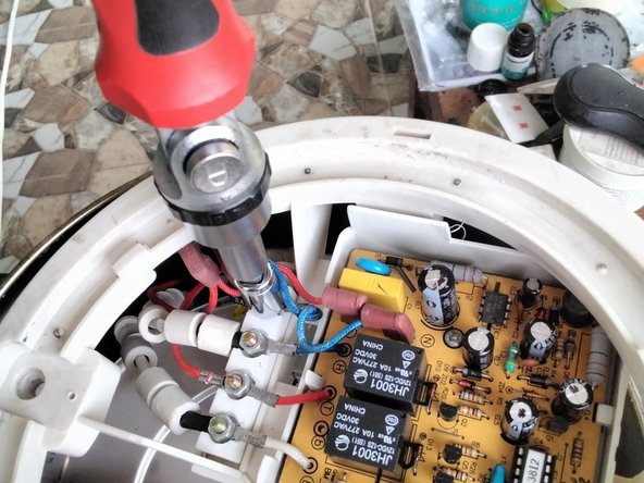

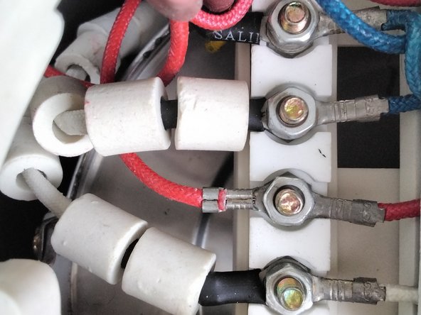

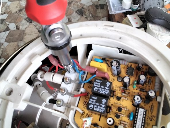

  3. Prolife Airpot Model YTA-538AP  Disassembly Only, Disconnect the wires from the Buss: crwdns2935265:03crwdnd2935265:01crwdnd2935265:03crwdne2935265:0 Prolife Airpot Model YTA-538AP  Disassembly Only, Disconnect the wires from the Buss: crwdns2935265:03crwdnd2935265:02crwdnd2935265:03crwdne2935265:0 Prolife Airpot Model YTA-538AP  Disassembly Only, Disconnect the wires from the Buss: crwdns2935265:03crwdnd2935265:03crwdnd2935265:03crwdne2935265:0
    • Use an 8 mm nutdriver to remove the nuts and lock washers retaining the various wires, take photos or notes to aid in reassembly

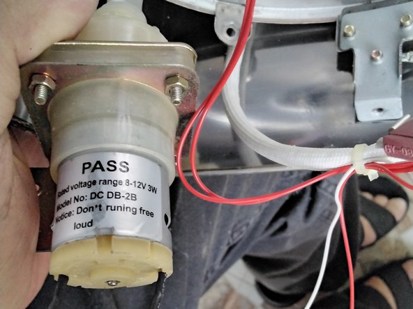

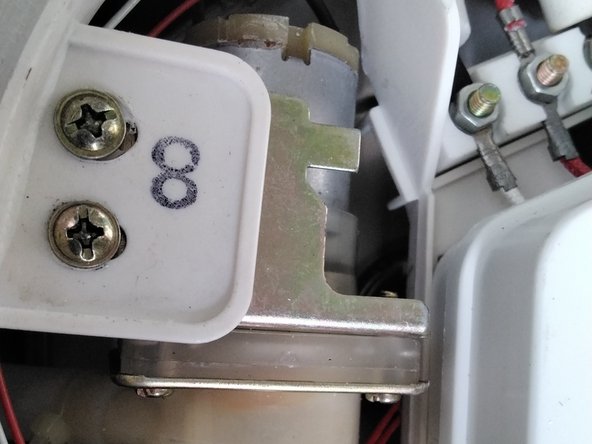

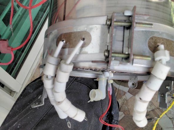

  4. Prolife Airpot Model YTA-538AP  Disassembly Only, Remove the electric water pump: crwdns2935265:04crwdnd2935265:01crwdnd2935265:01crwdne2935265:0
    • These two Phillips screws retain the water pump mount
    • Remove them and set them aside or tape them to the mount

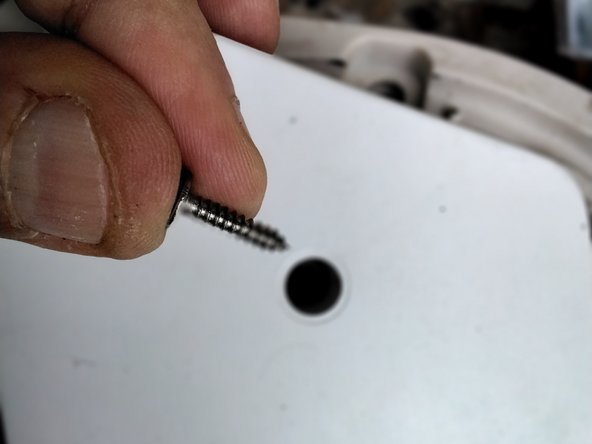

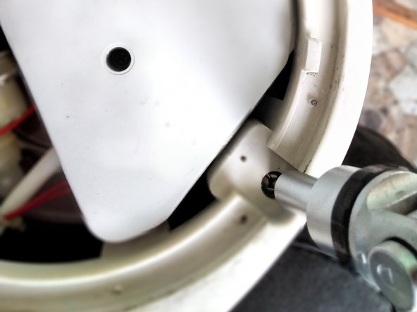

  5. Prolife Airpot Model YTA-538AP  Disassembly Only, Remove bolts securing the plastic base: crwdns2935265:05crwdnd2935265:01crwdnd2935265:02crwdne2935265:0 Prolife Airpot Model YTA-538AP  Disassembly Only, Remove bolts securing the plastic base: crwdns2935265:05crwdnd2935265:02crwdnd2935265:02crwdne2935265:0

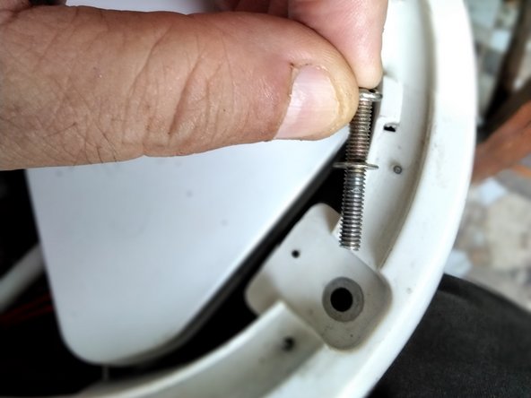

    • Two Phillips head bolts with washers at 180 degrees need to be removed and set aside
  6. Prolife Airpot Model YTA-538AP  Disassembly Only: crwdns2935265:06crwdnd2935265:01crwdnd2935265:03crwdne2935265:0 Prolife Airpot Model YTA-538AP  Disassembly Only: crwdns2935265:06crwdnd2935265:02crwdnd2935265:03crwdne2935265:0 Prolife Airpot Model YTA-538AP  Disassembly Only: crwdns2935265:06crwdnd2935265:03crwdnd2935265:03crwdne2935265:0

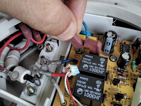

    • Remove the single Phillips screw holding the main Board housing cover
    • Remove and set aside cover
    • gently pull back the rust-colored rubber insulating boots and unplug the two wires from the main BUSS

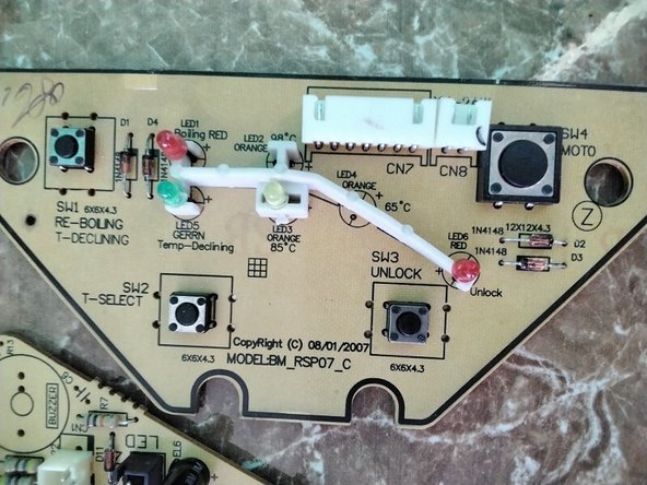

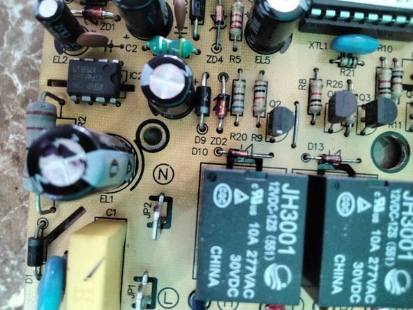

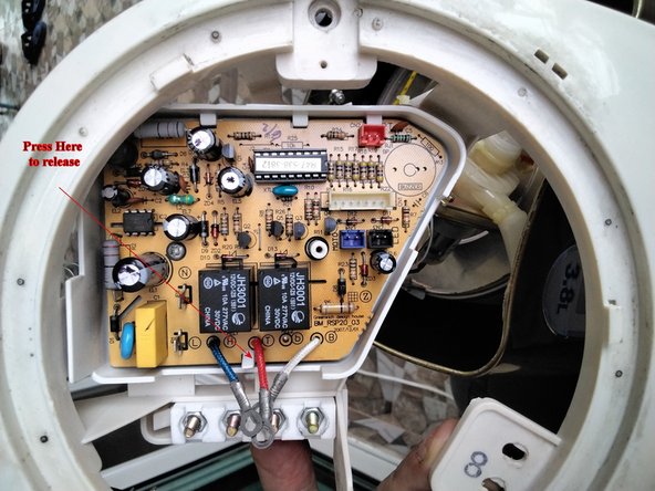

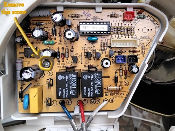

  7. Prolife Airpot Model YTA-538AP  Disassembly Only, Remove Main Circuit Board: crwdns2935265:07crwdnd2935265:01crwdnd2935265:03crwdne2935265:0 Prolife Airpot Model YTA-538AP  Disassembly Only, Remove Main Circuit Board: crwdns2935265:07crwdnd2935265:02crwdnd2935265:03crwdne2935265:0 Prolife Airpot Model YTA-538AP  Disassembly Only, Remove Main Circuit Board: crwdns2935265:07crwdnd2935265:03crwdnd2935265:03crwdne2935265:0
    • Remove the screw indicated by the GOLD circle
    • Press the white plastic tab indicated by the red arrow and pry the board upward while pulling forward to clear the two retaining tabs on the opposite side
    • Lift out the board

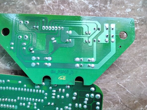

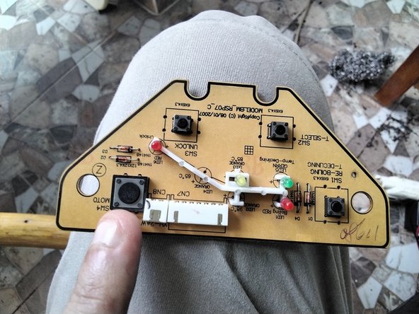

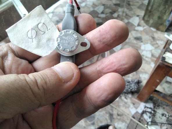

  10. Prolife Airpot Model YTA-538AP  Disassembly Only: crwdns2935265:010crwdnd2935265:01crwdnd2935265:03crwdne2935265:0 Prolife Airpot Model YTA-538AP  Disassembly Only: crwdns2935265:010crwdnd2935265:02crwdnd2935265:03crwdne2935265:0 Prolife Airpot Model YTA-538AP  Disassembly Only: crwdns2935265:010crwdnd2935265:03crwdnd2935265:03crwdne2935265:0

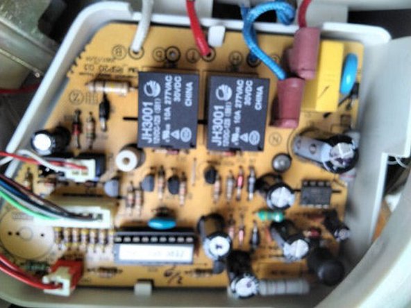

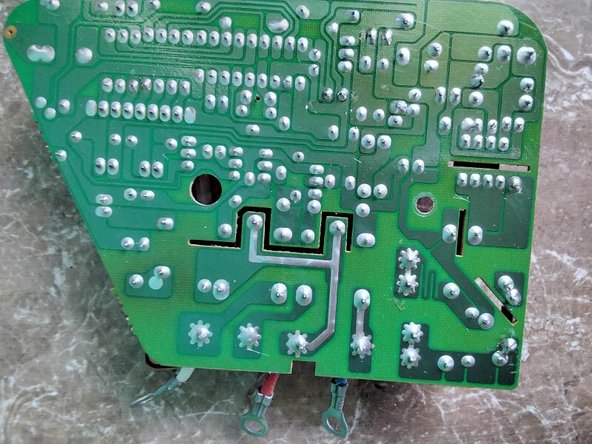

    • More preview. defective switch on control board everything else on that board tested ok
    • close-up of main board info

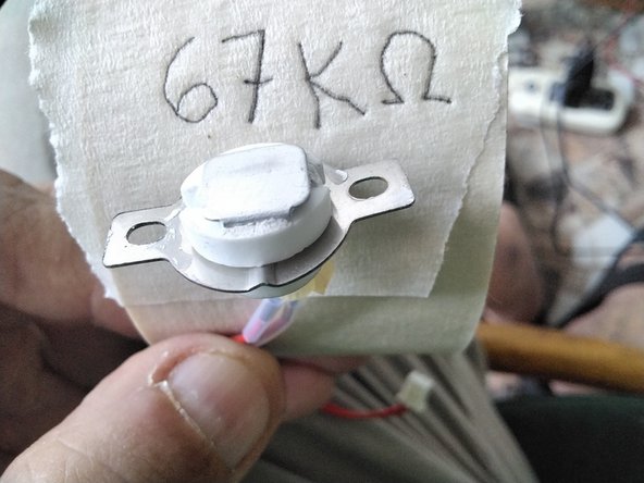

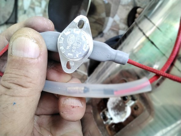

    • value of unlabelled critter that came from the center bottom of the water pot itself secured with what looks to be a thermal adhesive? white chalky, slightly greasy feeling.

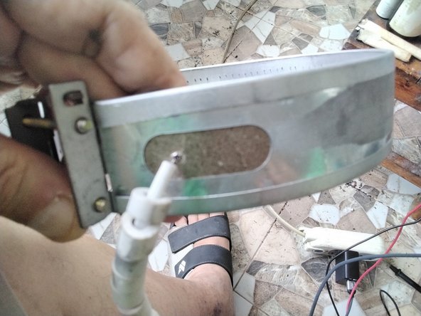

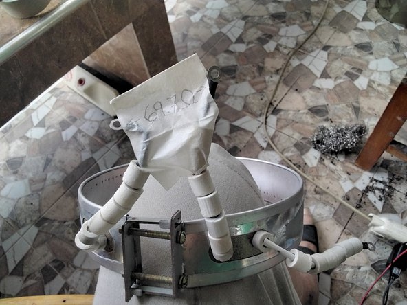

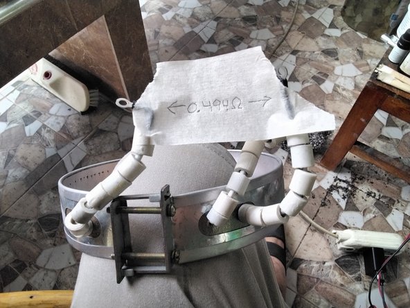

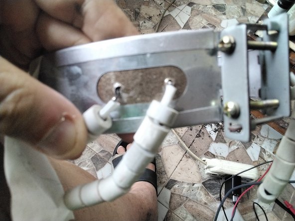

  11. Prolife Airpot Model YTA-538AP  Disassembly Only, Heating element values: crwdns2935265:011crwdnd2935265:01crwdnd2935265:03crwdne2935265:0 Prolife Airpot Model YTA-538AP  Disassembly Only, Heating element values: crwdns2935265:011crwdnd2935265:02crwdnd2935265:03crwdne2935265:0 Prolife Airpot Model YTA-538AP  Disassembly Only, Heating element values: crwdns2935265:011crwdnd2935265:03crwdnd2935265:03crwdne2935265:0

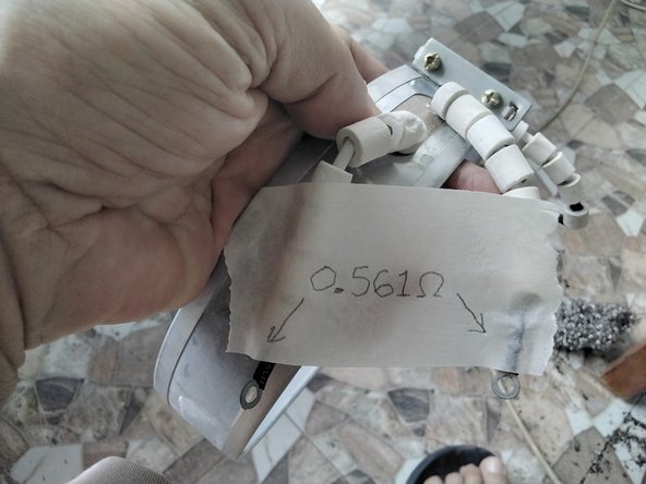

    • resistance in heating element between all three

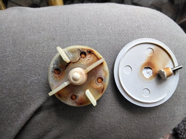

  12. Prolife Airpot Model YTA-538AP  Disassembly Only, heating element closer view no ID #s: crwdns2935265:012crwdnd2935265:01crwdnd2935265:03crwdne2935265:0 Prolife Airpot Model YTA-538AP  Disassembly Only, heating element closer view no ID #s: crwdns2935265:012crwdnd2935265:02crwdnd2935265:03crwdne2935265:0 Prolife Airpot Model YTA-538AP  Disassembly Only, heating element closer view no ID #s: crwdns2935265:012crwdnd2935265:03crwdnd2935265:03crwdne2935265:0
    • just a closer look at heating element

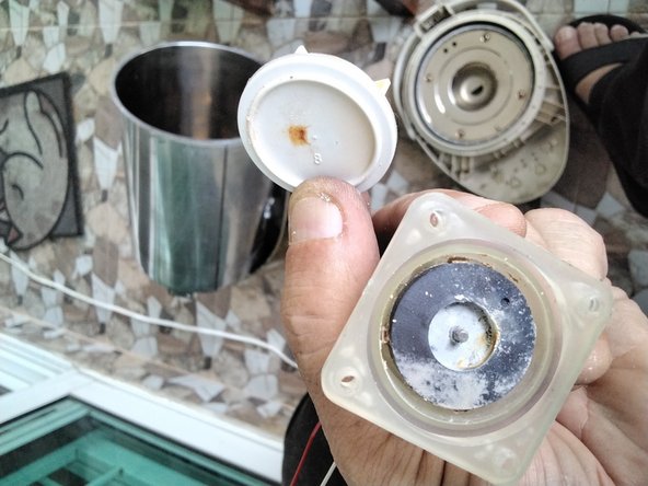

    • water pump is broken, plastic is also degraded and ready to fail soon that encases the impeller
  13. Prolife Airpot Model YTA-538AP  Disassembly Only, other previews: crwdns2935265:013crwdnd2935265:01crwdnd2935265:03crwdne2935265:0 Prolife Airpot Model YTA-538AP  Disassembly Only, other previews: crwdns2935265:013crwdnd2935265:02crwdnd2935265:03crwdne2935265:0 Prolife Airpot Model YTA-538AP  Disassembly Only, other previews: crwdns2935265:013crwdnd2935265:03crwdnd2935265:03crwdne2935265:0
    • thermo-whatsit value from side about halfway up also applied with thermal adhesise?

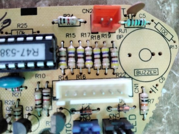

    • circuit board continued on next step

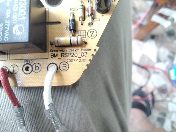

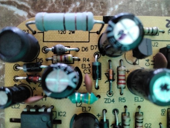

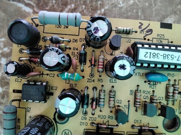

  14. Prolife Airpot Model YTA-538AP  Disassembly Only, more close-ups of main board: crwdns2935265:014crwdnd2935265:01crwdnd2935265:03crwdne2935265:0 Prolife Airpot Model YTA-538AP  Disassembly Only, more close-ups of main board: crwdns2935265:014crwdnd2935265:02crwdnd2935265:03crwdne2935265:0 Prolife Airpot Model YTA-538AP  Disassembly Only, more close-ups of main board: crwdns2935265:014crwdnd2935265:03crwdnd2935265:03crwdne2935265:0
    • circuit board close-ups and pump label

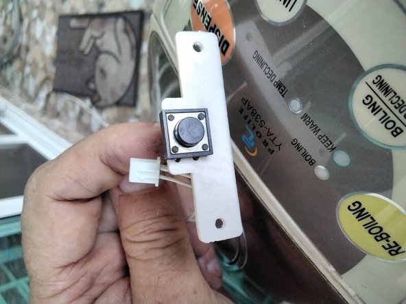

  15. Prolife Airpot Model YTA-538AP  Disassembly Only, cup switch: crwdns2935265:015crwdnd2935265:01crwdnd2935265:01crwdne2935265:0
    • that switches pump on when pressed by cup rim
    • all the major parts are now up, will continue with the disassembly steps.
