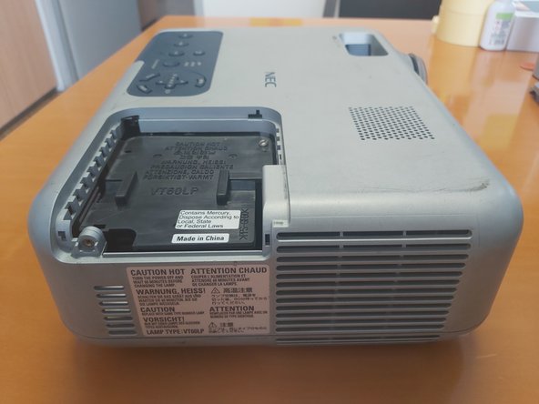

  1. Projector NEC VT660 Disassembly, Remove lamp cover: crwdns2935265:01crwdnd2935265:01crwdnd2935265:02crwdne2935265:0 Projector NEC VT660 Disassembly, Remove lamp cover: crwdns2935265:01crwdnd2935265:02crwdnd2935265:02crwdne2935265:0
    • Unscrew the screw and remove the cover.
  2. Projector NEC VT660 Disassembly, Remove lamp: crwdns2935265:02crwdnd2935265:01crwdnd2935265:02crwdne2935265:0 Projector NEC VT660 Disassembly, Remove lamp: crwdns2935265:02crwdnd2935265:02crwdnd2935265:02crwdne2935265:0
    • Unscrew the two screws that are holding the lamp in place.
    • Pull the lamp out.

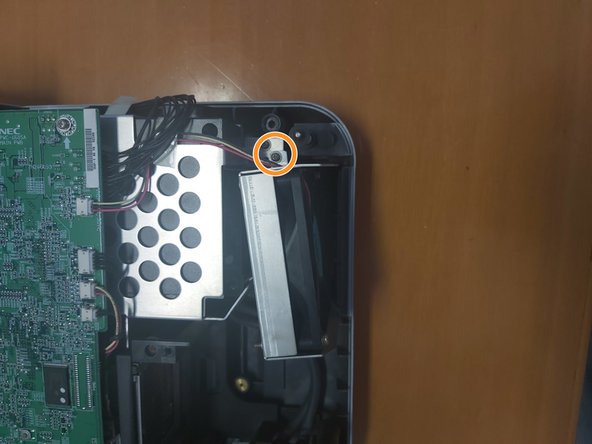

  3. Projector NEC VT660 Disassembly, Housing disassembly: crwdns2935265:03crwdnd2935265:01crwdnd2935265:03crwdne2935265:0 Projector NEC VT660 Disassembly, Housing disassembly: crwdns2935265:03crwdnd2935265:02crwdnd2935265:03crwdne2935265:0 Projector NEC VT660 Disassembly, Housing disassembly: crwdns2935265:03crwdnd2935265:03crwdnd2935265:03crwdne2935265:0
    • Remove 5 screws from the bottom.
    • Remove 1 screw from the back.
    • Slowly lift the upper housing and disconnect the connector.
    • Do not lift the upper housing too quickly as it could damage the connector cable.

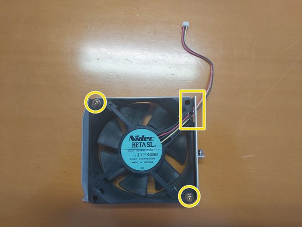

  4. Projector NEC VT660 Disassembly, Removing fan: crwdns2935265:04crwdnd2935265:01crwdnd2935265:03crwdne2935265:0 Projector NEC VT660 Disassembly, Removing fan: crwdns2935265:04crwdnd2935265:02crwdnd2935265:03crwdne2935265:0 Projector NEC VT660 Disassembly, Removing fan: crwdns2935265:04crwdnd2935265:03crwdnd2935265:03crwdne2935265:0
    • After removing the upper housing. Turn the projector to see the fan.
    • Unscrew two screws from each side of the fan holder.
    • Remove the fan from holder by unscrewing the two screws.
    • Carefully take out the fan. Keep an eye on the wires that go through the holder.
