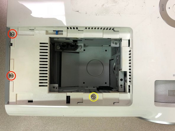

    • First grab a 00 Phillips screwdriver remove the lamp cover.
    • Then loosen the 3 captive screws holding the lamp in the projector with a standard Phillips screwdriver.

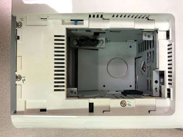

  2. Projector - Vivitek D855ST DMD Chip Board Replacement, Remove the housing: crwdns2935265:02crwdnd2935265:01crwdnd2935265:02crwdne2935265:0 Projector - Vivitek D855ST DMD Chip Board Replacement, Remove the housing: crwdns2935265:02crwdnd2935265:02crwdnd2935265:02crwdne2935265:0
    • Remove the following 8 screws securing the bottom housing.
    • Remove 3 screws securing the top housing.

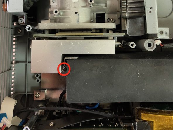

  4. Projector - Vivitek D855ST DMD Chip Board Replacement, Remove top shield: crwdns2935265:04crwdnd2935265:01crwdnd2935265:01crwdne2935265:0
    • Remove the following 8 screws of various sizes on the top shield.
    • Remove the screw in red very last. It's tight and after removing the others, you can swivel the shield enough to loosen that screw without stripping it.

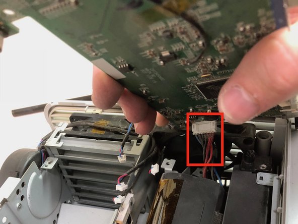

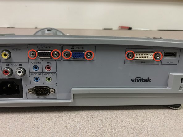

  5. Projector - Vivitek D855ST DMD Chip Board Replacement, Remove main board: crwdns2935265:05crwdnd2935265:01crwdnd2935265:03crwdne2935265:0 Projector - Vivitek D855ST DMD Chip Board Replacement, Remove main board: crwdns2935265:05crwdnd2935265:02crwdnd2935265:03crwdne2935265:0 Projector - Vivitek D855ST DMD Chip Board Replacement, Remove main board: crwdns2935265:05crwdnd2935265:03crwdnd2935265:03crwdne2935265:0
    • Remove one screw and the carefully disconnect 2 ribbon cables and 8 cable connectors from the main board.
    • Remove the 6 video cable standoffs from the rear of the projector. Needle-nose pliers will loosen them enough then a Torx-8 driver fits perfect to loosen them the rest of the way
    • Carefully push the rear of the video ports inward to push the board enough forward and lift up.
    • Lift up and disconnect the cable connector on the bottom of the board to the power supply.

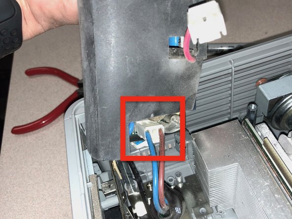

  6. Projector - Vivitek D855ST DMD Chip Board Replacement, Remove power supply: crwdns2935265:06crwdnd2935265:01crwdnd2935265:03crwdne2935265:0 Projector - Vivitek D855ST DMD Chip Board Replacement, Remove power supply: crwdns2935265:06crwdnd2935265:02crwdnd2935265:03crwdne2935265:0 Projector - Vivitek D855ST DMD Chip Board Replacement, Remove power supply: crwdns2935265:06crwdnd2935265:03crwdnd2935265:03crwdne2935265:0
    • Remove 2 screws on the right and left sides toward the bottom securing the power supply to the chassis.
  7. Projector - Vivitek D855ST DMD Chip Board Replacement, Disconnect the power supply: crwdns2935265:07crwdnd2935265:01crwdnd2935265:02crwdne2935265:0 Projector - Vivitek D855ST DMD Chip Board Replacement, Disconnect the power supply: crwdns2935265:07crwdnd2935265:02crwdnd2935265:02crwdne2935265:0
    • Disconnect the cable connectors from the left and right sides under the power supply

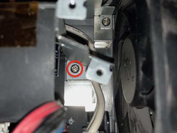

  9. Projector - Vivitek D855ST DMD Chip Board Replacement, Remove the heatsink: crwdns2935265:09crwdnd2935265:01crwdnd2935265:03crwdne2935265:0 Projector - Vivitek D855ST DMD Chip Board Replacement, Remove the heatsink: crwdns2935265:09crwdnd2935265:02crwdnd2935265:03crwdne2935265:0 Projector - Vivitek D855ST DMD Chip Board Replacement, Remove the heatsink: crwdns2935265:09crwdnd2935265:03crwdnd2935265:03crwdne2935265:0
    • Remove one screw and the tension bar holding the heatsink to the DMD Board
    • Pull back the shielding tape from the heatsink to the lens unit.

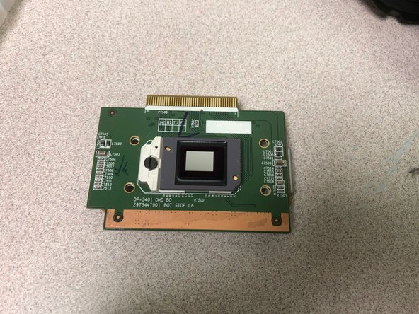

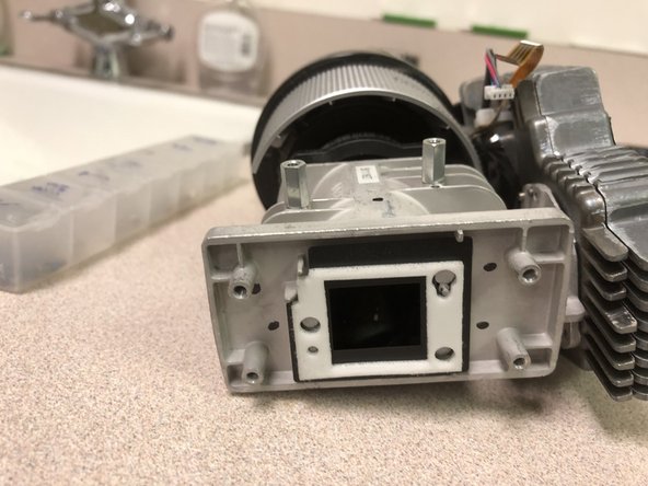

  10. Projector - Vivitek D855ST DMD Chip Board Replacement, Access to DMD board: crwdns2935265:010crwdnd2935265:01crwdnd2935265:03crwdne2935265:0 Projector - Vivitek D855ST DMD Chip Board Replacement, Access to DMD board: crwdns2935265:010crwdnd2935265:02crwdnd2935265:03crwdne2935265:0 Projector - Vivitek D855ST DMD Chip Board Replacement, Access to DMD board: crwdns2935265:010crwdnd2935265:03crwdnd2935265:03crwdne2935265:0
    • Remove 4 screws securing the DMD board to the lens unit
    • Pull it gently apart. It is held by thermal paste.
