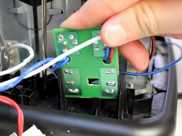

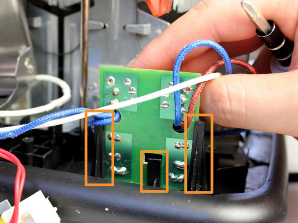

    1. Professional Series PS77401 Chassis Replacement, Chassis: crwdns2935265:05crwdnd2935265:01crwdnd2935265:03crwdne2935265:0 Professional Series PS77401 Chassis Replacement, Chassis: crwdns2935265:05crwdnd2935265:02crwdnd2935265:03crwdne2935265:0 Professional Series PS77401 Chassis Replacement, Chassis: crwdns2935265:05crwdnd2935265:03crwdnd2935265:03crwdne2935265:0
      • Locate the small circuit board attached to the base of the toaster.
      • To remove the circuit board, pull apart the two side tabs while releasing the middle tab simultaneously.
      • Pull the circuit board out of the slot.

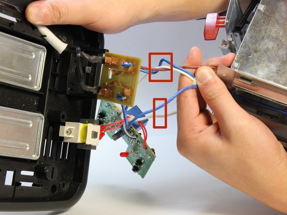

    4. Professional Series PS77401 Chassis Replacement: crwdns2935265:08crwdnd2935265:01crwdnd2935265:02crwdne2935265:0 Professional Series PS77401 Chassis Replacement: crwdns2935265:08crwdnd2935265:02crwdnd2935265:02crwdne2935265:0
      • The following wires must be disconnected to be able to remove the chassis: Blue x2, White x2, Bronze x1
      • Disconnecting the cables in the middle is recommended to be able to reconnect new wires from a new chassis easily.
