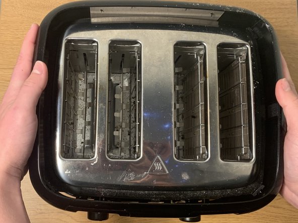

    • Turn the toaster upside down to shake out any excess crumbs and remove any crumbs from the crumb tray, as well.
    • Consider doing this step over the sink or place a sheet under your toaster to collect any crumbs that fall out.

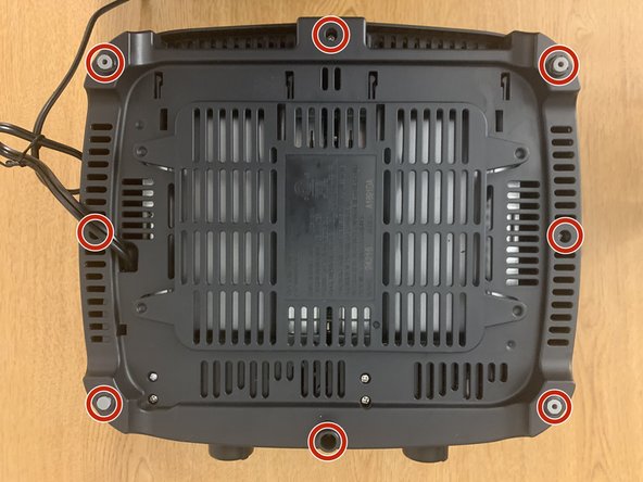

    • Turn the toaster over and using a tweezer, remove the four rubber feet.
    • Using the Phillips #1 screwdriver, remove eight 12.7 mm screws on the bottom perimeter of the toaster.
    • Do NOT remove the 4 other screws as these are connected to the plastic wedge inside of the toaster.
