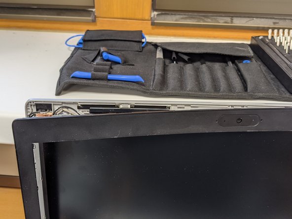

  1. Probook 650 G5 Screen Replacement, Turn of Laptop: crwdns2935265:01crwdnd2935265:01crwdnd2935265:01crwdne2935265:0
    • Turn off your Laptop and open the Lid so that you can access all sides of the Monitor
  2. Probook 650 G5 Screen Replacement, Remove Plastic Cover: crwdns2935265:02crwdnd2935265:01crwdnd2935265:03crwdne2935265:0 Probook 650 G5 Screen Replacement, Remove Plastic Cover: crwdns2935265:02crwdnd2935265:02crwdnd2935265:03crwdne2935265:0 Probook 650 G5 Screen Replacement, Remove Plastic Cover: crwdns2935265:02crwdnd2935265:03crwdnd2935265:03crwdne2935265:0
    • Gently lift the Plastic Cover and move around the Screen doing this

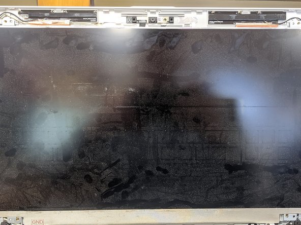

  3. Probook 650 G5 Screen Replacement, Remove Screen: crwdns2935265:03crwdnd2935265:01crwdnd2935265:02crwdne2935265:0 Probook 650 G5 Screen Replacement, Remove Screen: crwdns2935265:03crwdnd2935265:02crwdnd2935265:02crwdne2935265:0
    • Remove the 4 Screws and gently Pull the Screen towards you

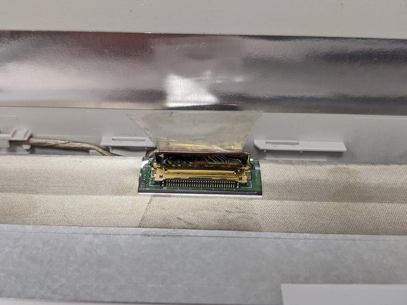

  4. Probook 650 G5 Screen Replacement, Unplug Screen: crwdns2935265:04crwdnd2935265:01crwdnd2935265:03crwdne2935265:0 Probook 650 G5 Screen Replacement, Unplug Screen: crwdns2935265:04crwdnd2935265:02crwdnd2935265:03crwdne2935265:0 Probook 650 G5 Screen Replacement, Unplug Screen: crwdns2935265:04crwdnd2935265:03crwdnd2935265:03crwdne2935265:0
    • Lay the Screen gently on the Keyboard of the Laptop and unplug the Display Cable
    • To unplug the cable you need to pull up the adhesive Foil and lift the little Lever which secures the Display Cable
    • Remove the old screen

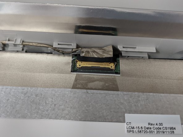

  5. Probook 650 G5 Screen Replacement, Connect new Screen: crwdns2935265:05crwdnd2935265:01crwdnd2935265:01crwdne2935265:0
    • Place the new Screen on the keyboard and align it with the Display Cable
    • Slide the Cable in the Connector and secure it with the Lever and the adhesive foil
