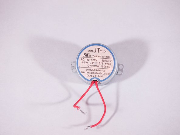

    • Remove the two 14 mm Phillips #2 screws from the motor.
    • Remove the motor from the popper.
    • A spring located in the shaft may force the motor out when the screws are sufficiently loosened.

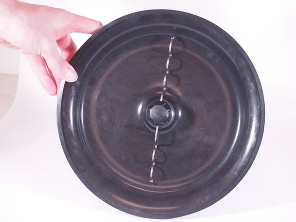

    • This is the nonstick heating pan with the stirrer still attached.
    • The pan surface can be greasy from use.

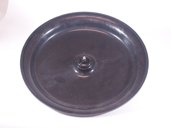

    • The center stirring arm knob can be removed by hand (twisting to the left).
    • The scalloped stirring arm can be directly lifted out from the center mount.
    • During reassembly, note that the scalloped stirring arm is keyed to fit in one direction.

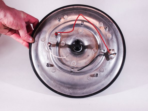

    • Flipping the heating pan over, wires to the thermostat and the plastic motor shaft remain.
  10. Presto Stirring Popper 0520002 Disassembly: crwdns2935265:010crwdnd2935265:01crwdnd2935265:02crwdne2935265:0 Presto Stirring Popper 0520002 Disassembly: crwdns2935265:010crwdnd2935265:02crwdnd2935265:02crwdne2935265:0

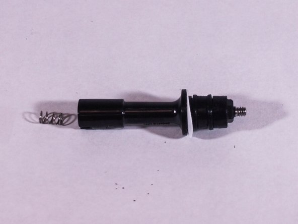

    • Directly pull the motor shaft out.
    • Take care to not misplace the small spring.

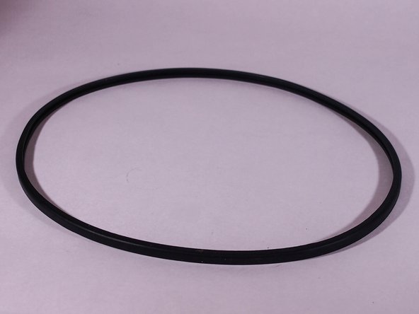

    • This is the heating plate with the rubber gasket removed.
    • During reassembly, be sure to re-attach the gasket around the entire plate before reassembling the bowl.
