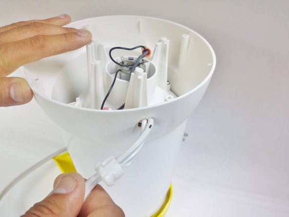

    • Be sure that the popper is unplugged before disassembly.
    • Turn Presto Popper upside down.
  2. Presto PopLite 04820 Power Cord Replacement: crwdns2935265:02crwdnd2935265:01crwdnd2935265:03crwdne2935265:0 Presto PopLite 04820 Power Cord Replacement: crwdns2935265:02crwdnd2935265:02crwdnd2935265:03crwdne2935265:0 Presto PopLite 04820 Power Cord Replacement: crwdns2935265:02crwdnd2935265:03crwdnd2935265:03crwdne2935265:0
    • Remove the four 9 mm Phillips #2 screws from the base.
    • Once all four screws are removed, take the base off.

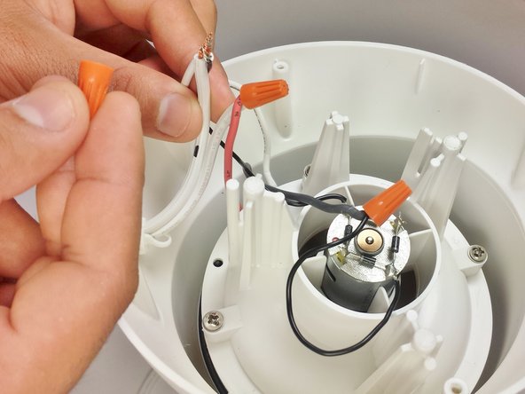

    • Untwist the two orange twist-on wire connectors.
    • Make a note of which wires are in each of the orange caps.

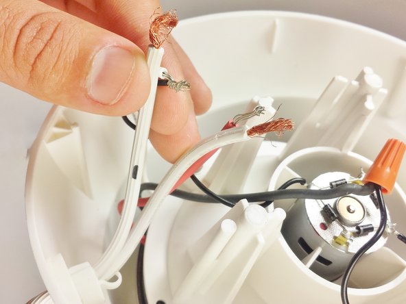

  4. Presto PopLite 04820 Power Cord Replacement: crwdns2935265:04crwdnd2935265:01crwdnd2935265:03crwdne2935265:0 Presto PopLite 04820 Power Cord Replacement: crwdns2935265:04crwdnd2935265:02crwdnd2935265:03crwdne2935265:0 Presto PopLite 04820 Power Cord Replacement: crwdns2935265:04crwdnd2935265:03crwdnd2935265:03crwdne2935265:0

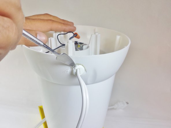

    • Locate the plastic piece holding the power cord in place.
    • Take the metal spudger from the tool kit and pry this piece loose.
    • This plastic piece may take excessive force to pry out, just keep trying until it pops out.
    • Remove the power cord.
