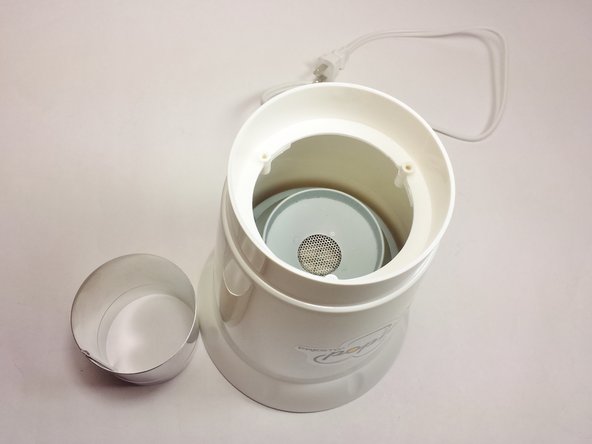

    • Make sure you unplug the device before disassembling.
    • Remove the butter melter/measuring cup.
  2. Presto PopLite 04820 Popping Chamber Shaft Replacement: crwdns2935265:02crwdnd2935265:01crwdnd2935265:01crwdne2935265:0
    • Remove the cover.

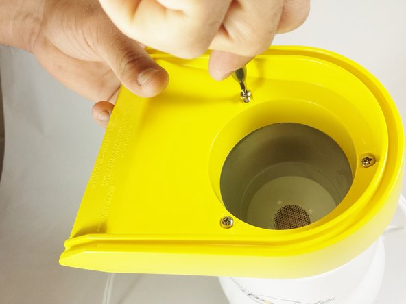

  3. Presto PopLite 04820 Popping Chamber Shaft Replacement: crwdns2935265:03crwdnd2935265:01crwdnd2935265:03crwdne2935265:0 Presto PopLite 04820 Popping Chamber Shaft Replacement: crwdns2935265:03crwdnd2935265:02crwdnd2935265:03crwdne2935265:0 Presto PopLite 04820 Popping Chamber Shaft Replacement: crwdns2935265:03crwdnd2935265:03crwdnd2935265:03crwdne2935265:0
    • Remove the three 49 mm Phillips #2 screws.
    • Once you have removed the screws, remove the chute from popper base.
  4. Presto PopLite 04820 Popping Chamber Shaft Replacement, Popping Chamber Shaft: crwdns2935265:04crwdnd2935265:01crwdnd2935265:01crwdne2935265:0
    • The popping chamber shaft should be located in the popper base once the chute is removed.
  5. Presto PopLite 04820 Popping Chamber Shaft Replacement: crwdns2935265:05crwdnd2935265:01crwdnd2935265:02crwdne2935265:0 Presto PopLite 04820 Popping Chamber Shaft Replacement: crwdns2935265:05crwdnd2935265:02crwdnd2935265:02crwdne2935265:0
    • Reach down the popper base and grab the popping chamber shaft. Begin to remove it from the popper base.
    • Now remove it completely and set it aside for new shaft to be placed.
