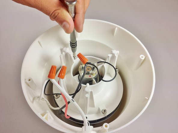

    • Be sure that the popper is unplugged before disassembly.
    • Turn Presto Popper upside down.
  2. Presto PopLite 04820 Popping Chamber Base Replacement: crwdns2935265:02crwdnd2935265:01crwdnd2935265:03crwdne2935265:0 Presto PopLite 04820 Popping Chamber Base Replacement: crwdns2935265:02crwdnd2935265:02crwdnd2935265:03crwdne2935265:0 Presto PopLite 04820 Popping Chamber Base Replacement: crwdns2935265:02crwdnd2935265:03crwdnd2935265:03crwdne2935265:0
    • Remove the four 9 mm Phillips #2 screws from the base.
    • Once all four screws are removed, take the base off.
  3. Presto PopLite 04820 Popping Chamber Base Replacement, Popping Chamber Base: crwdns2935265:03crwdnd2935265:01crwdnd2935265:02crwdne2935265:0 Presto PopLite 04820 Popping Chamber Base Replacement, Popping Chamber Base: crwdns2935265:03crwdnd2935265:02crwdnd2935265:02crwdne2935265:0
    • Remove the four 13 mm Phillips #2 screws.
  4. Presto PopLite 04820 Popping Chamber Base Replacement: crwdns2935265:04crwdnd2935265:01crwdnd2935265:01crwdne2935265:0
    • Remove the entire cavity that holds the motor from the base of the PopLite.
    • Be gentle while taking the motor out of the base to avoid wire damage.

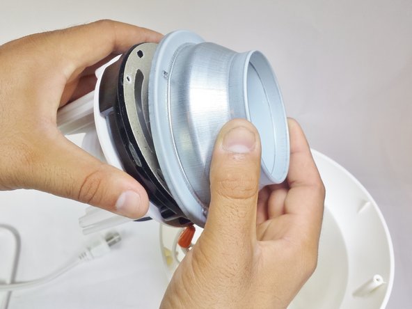

  5. Presto PopLite 04820 Popping Chamber Base Replacement: crwdns2935265:05crwdnd2935265:01crwdnd2935265:02crwdne2935265:0 Presto PopLite 04820 Popping Chamber Base Replacement: crwdns2935265:05crwdnd2935265:02crwdnd2935265:02crwdne2935265:0
    • Turn the popping chamber base sideways.
    • Now remove popping chamber base.
