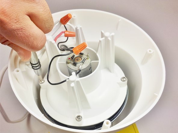

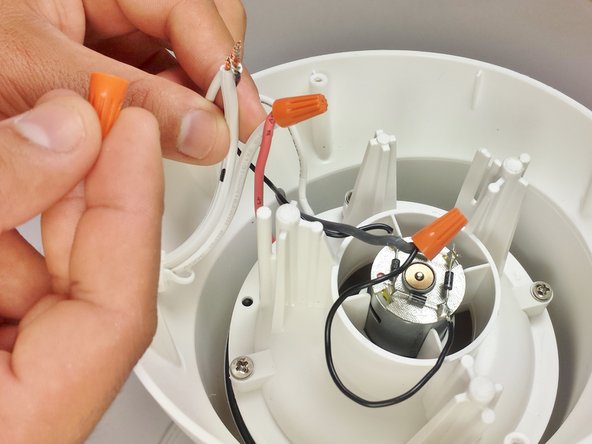

    • Locate the two twist-on wire connectors.
    • Unscrew the two caps and keep track of the wires that wire up together to make it easier in the end to put back together.

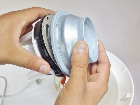

    • Pull the entire cavity out of the popper that holds the motor.
    • Remove the popping chamber base.

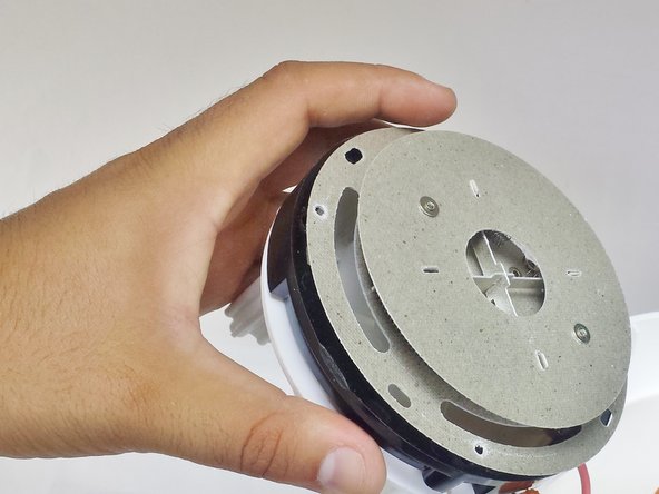

    • Remove circuit board from the motor base holder.
    • Make sure these 3 wires are securely placed inside grooves when reassembling the motor base holder.

    • Remove the orange twist-on wire connector connecting the black wire to the grey wire.

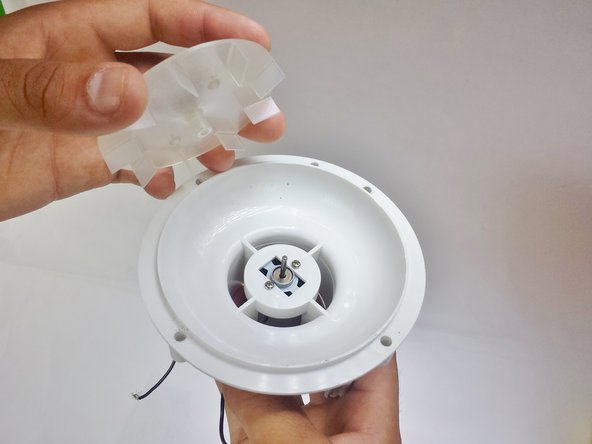

    • Locate the clear plastic motor fan.
    • Grab hold of the motor and pull upwards to pop the motor fan off of the needle that connects to the motor.
    • This may require large amounts of force to pull it off the needle.
