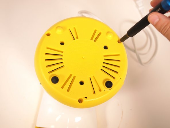

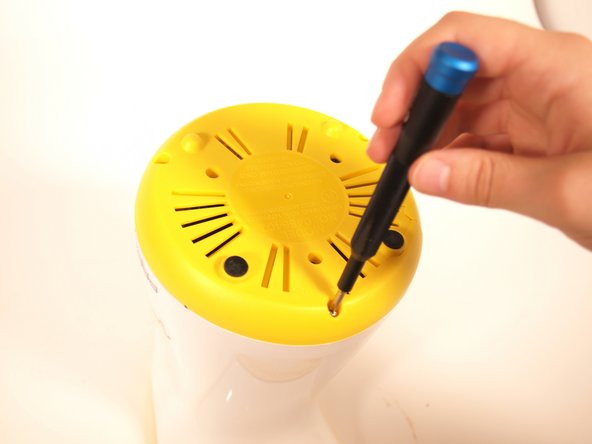

  2. Presto PopLite 04820 Disassembly: crwdns2935265:02crwdnd2935265:01crwdnd2935265:01crwdne2935265:0
    • Turn the machine upside down, exposing the screws on the bottom.
  3. Presto PopLite 04820 Disassembly: crwdns2935265:03crwdnd2935265:01crwdnd2935265:03crwdne2935265:0 Presto PopLite 04820 Disassembly: crwdns2935265:03crwdnd2935265:02crwdnd2935265:03crwdne2935265:0 Presto PopLite 04820 Disassembly: crwdns2935265:03crwdnd2935265:03crwdnd2935265:03crwdne2935265:0
    • Remove the three Phillips screws that secure the base plate.

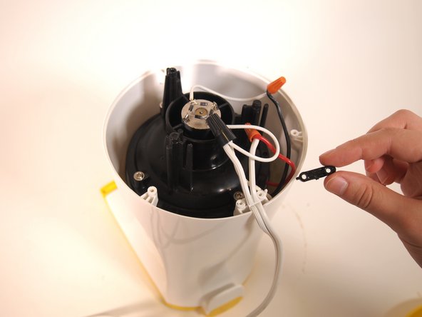

  4. Presto PopLite 04820 Disassembly: crwdns2935265:04crwdnd2935265:01crwdnd2935265:02crwdne2935265:0 Presto PopLite 04820 Disassembly: crwdns2935265:04crwdnd2935265:02crwdnd2935265:02crwdne2935265:0
    • Remove the base plate.
  5. Presto PopLite 04820 Disassembly: crwdns2935265:05crwdnd2935265:01crwdnd2935265:02crwdne2935265:0 Presto PopLite 04820 Disassembly: crwdns2935265:05crwdnd2935265:02crwdnd2935265:02crwdne2935265:0
    • Remove the two Phillips screws securing the main outlet cord.
  6. Presto PopLite 04820 Disassembly: crwdns2935265:06crwdnd2935265:01crwdnd2935265:01crwdne2935265:0
    • Remove the main apparatus from the inside of the popcorn machine body.

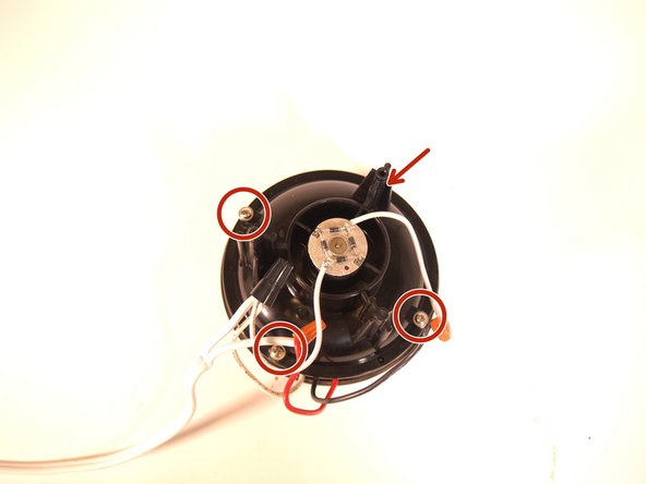

  7. Presto PopLite 04820 Disassembly: crwdns2935265:07crwdnd2935265:01crwdnd2935265:02crwdne2935265:0 Presto PopLite 04820 Disassembly: crwdns2935265:07crwdnd2935265:02crwdnd2935265:02crwdne2935265:0
    • Begin unscrewing the four screws holding the black motor to the heating element.
  8. Presto PopLite 04820 Disassembly: crwdns2935265:08crwdnd2935265:01crwdnd2935265:03crwdne2935265:0 Presto PopLite 04820 Disassembly: crwdns2935265:08crwdnd2935265:02crwdnd2935265:03crwdne2935265:0 Presto PopLite 04820 Disassembly: crwdns2935265:08crwdnd2935265:03crwdnd2935265:03crwdne2935265:0
    • Lift the motor off of the heating plate, exposing the wires connecting the two.
    • The motor powers the fan, marked by the arrow.
