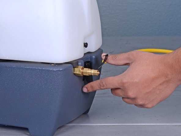

  1. Presto Carpet Extractor 9.840-068.0 2016 Vacuum Motor Replacement, Disconnect the Hose: crwdns2935265:01crwdnd2935265:01crwdnd2935265:03crwdne2935265:0 Presto Carpet Extractor 9.840-068.0 2016 Vacuum Motor Replacement, Disconnect the Hose: crwdns2935265:01crwdnd2935265:02crwdnd2935265:03crwdne2935265:0 Presto Carpet Extractor 9.840-068.0 2016 Vacuum Motor Replacement, Disconnect the Hose: crwdns2935265:01crwdnd2935265:03crwdnd2935265:03crwdne2935265:0
    • Ensure your carpet extractor is unplugged and switched off before starting this procedure.
    • If it is still attached, pull and disconnect the brass quick-connect fitting from the carpet extractor body.
  2. Presto Carpet Extractor 9.840-068.0 2016 Vacuum Motor Replacement: crwdns2935265:02crwdnd2935265:01crwdnd2935265:02crwdne2935265:0 Presto Carpet Extractor 9.840-068.0 2016 Vacuum Motor Replacement: crwdns2935265:02crwdnd2935265:02crwdnd2935265:02crwdne2935265:0
    • If it is still attached, disconnect the black hose from the recovery tank.

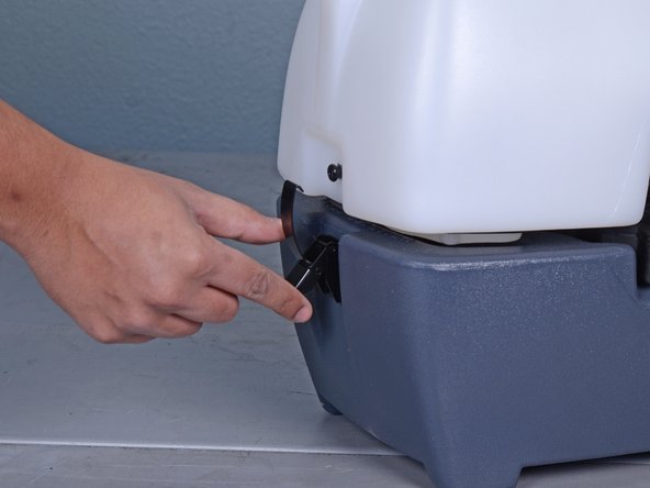

  3. Presto Carpet Extractor 9.840-068.0 2016 Vacuum Motor Replacement, Remove the Recovery Tank: crwdns2935265:03crwdnd2935265:01crwdnd2935265:03crwdne2935265:0 Presto Carpet Extractor 9.840-068.0 2016 Vacuum Motor Replacement, Remove the Recovery Tank: crwdns2935265:03crwdnd2935265:02crwdnd2935265:03crwdne2935265:0 Presto Carpet Extractor 9.840-068.0 2016 Vacuum Motor Replacement, Remove the Recovery Tank: crwdns2935265:03crwdnd2935265:03crwdnd2935265:03crwdne2935265:0
    • Unclasp and release the two black latches on either side of the carpet extractor.
  4. Presto Carpet Extractor 9.840-068.0 2016 Vacuum Motor Replacement: crwdns2935265:04crwdnd2935265:01crwdnd2935265:02crwdne2935265:0 Presto Carpet Extractor 9.840-068.0 2016 Vacuum Motor Replacement: crwdns2935265:04crwdnd2935265:02crwdnd2935265:02crwdne2935265:0
    • Remove the recovery tank.
