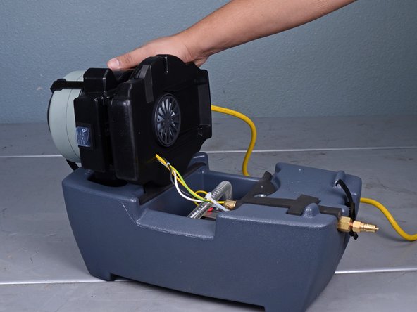

  6. Presto Carpet Extractor 9.840-068.0 2016 Pump Replacement, Open the Pump Housing: crwdns2935265:06crwdnd2935265:01crwdnd2935265:02crwdne2935265:0 Presto Carpet Extractor 9.840-068.0 2016 Pump Replacement, Open the Pump Housing: crwdns2935265:06crwdnd2935265:02crwdnd2935265:02crwdne2935265:0
    • Tilt the vacuum motor and pump housing sideways and let it rest on the side of the extractor.

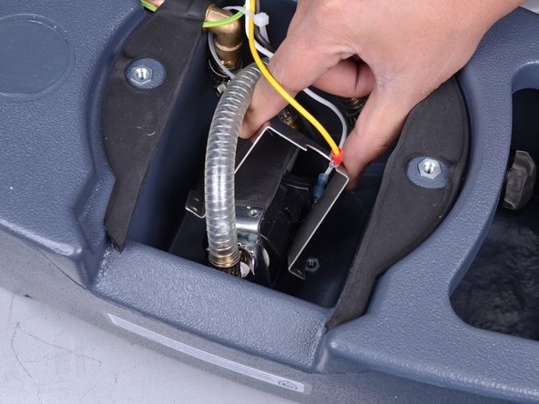

  9. Presto Carpet Extractor 9.840-068.0 2016 Pump Replacement, Remove the Pump Mounting Bracket: crwdns2935265:09crwdnd2935265:01crwdnd2935265:03crwdne2935265:0 Presto Carpet Extractor 9.840-068.0 2016 Pump Replacement, Remove the Pump Mounting Bracket: crwdns2935265:09crwdnd2935265:02crwdnd2935265:03crwdne2935265:0 Presto Carpet Extractor 9.840-068.0 2016 Pump Replacement, Remove the Pump Mounting Bracket: crwdns2935265:09crwdnd2935265:03crwdnd2935265:03crwdne2935265:0
    • Lift and remove the pump mounting bracket.
    • Take care to not snag the sharp edges of the mounting bracket on any wires or hoses as you remove it.

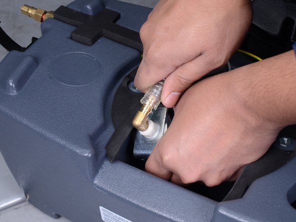

  12. Presto Carpet Extractor 9.840-068.0 2016 Pump Replacement: crwdns2935265:012crwdnd2935265:01crwdnd2935265:03crwdne2935265:0 Presto Carpet Extractor 9.840-068.0 2016 Pump Replacement: crwdns2935265:012crwdnd2935265:02crwdnd2935265:03crwdne2935265:0 Presto Carpet Extractor 9.840-068.0 2016 Pump Replacement: crwdns2935265:012crwdnd2935265:03crwdnd2935265:03crwdne2935265:0
    • Pull the hose straight off of the brass fitting to remove it from the pump.
    • If this is too difficult to do by hand, use a pair of pliers to carefully work the hose off of the fitting until it is free.

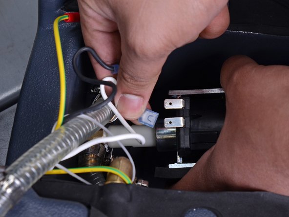

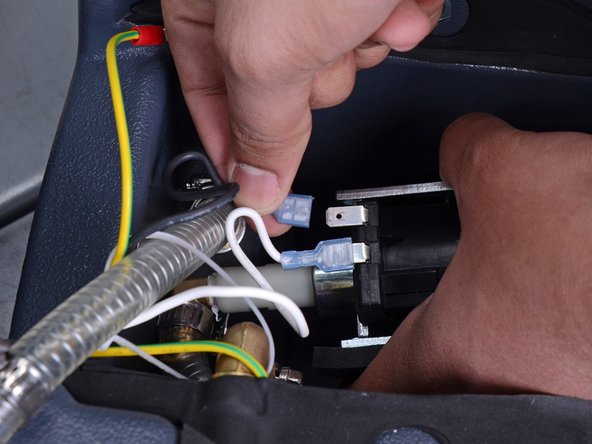

    • Disconnect the two crimp connectors from the pump body.
    • Take note of which wire connects where for reassembly.
    • This may require a significant amount of force; pull and wiggle the connector until it's free.
