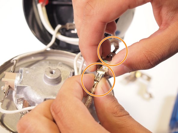

  4. Presto 0282202 Disassembly: crwdns2935265:04crwdnd2935265:01crwdnd2935265:03crwdne2935265:0 Presto 0282202 Disassembly: crwdns2935265:04crwdnd2935265:02crwdnd2935265:03crwdne2935265:0 Presto 0282202 Disassembly: crwdns2935265:04crwdnd2935265:03crwdnd2935265:03crwdne2935265:0
    • Lightly remove the left (side facing) thermal switch from its thermal paste.
    • Be careful as the thermal paste can be quite adhesive.
    • Using your small needle-nose pliers, take off the spade connectors connected to the thermal switch.
    • The easiest way to do this is to hold the thermal switch end with the pliers and tug the spade connector off.
  5. Presto 0282202 Disassembly: crwdns2935265:05crwdnd2935265:01crwdnd2935265:03crwdne2935265:0 Presto 0282202 Disassembly: crwdns2935265:05crwdnd2935265:02crwdnd2935265:03crwdne2935265:0 Presto 0282202 Disassembly: crwdns2935265:05crwdnd2935265:03crwdnd2935265:03crwdne2935265:0
    • Remove the two spade connectors connected to the heating element.
    • The easiest way to do this is to hold the heating element end with the pliers and tug the spade connector off.
  6. Presto 0282202 Disassembly: crwdns2935265:06crwdnd2935265:01crwdnd2935265:03crwdne2935265:0 Presto 0282202 Disassembly: crwdns2935265:06crwdnd2935265:02crwdnd2935265:03crwdne2935265:0 Presto 0282202 Disassembly: crwdns2935265:06crwdnd2935265:03crwdnd2935265:03crwdne2935265:0
    • Remove the two spade connectors connected to the power connector.
    • The easiest way to do this is to hold the power connector end with the pliers and tug the spade connector off.
    • The final wire removed contains the small heating wire (the thick braided wire) and the signal light.
