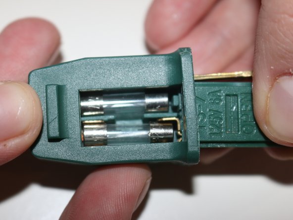

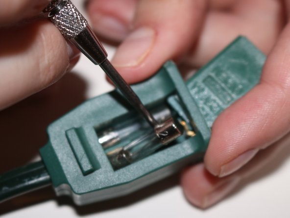

    • Open the fuse cover, then use a small flathead screwdriver or spudger to carefully remove the fuse.

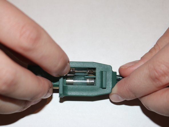

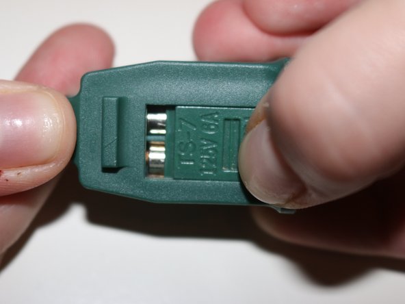

    • Carefully insert the working fuse back into the tree plug, and put the cover on.
