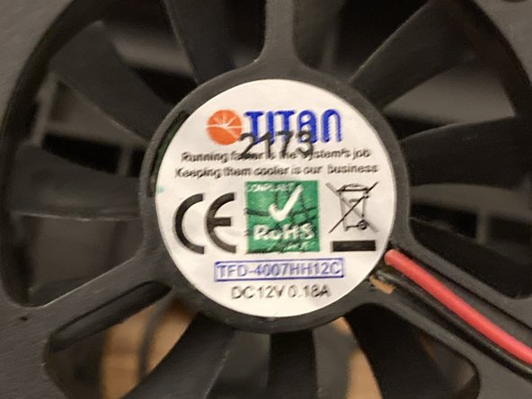

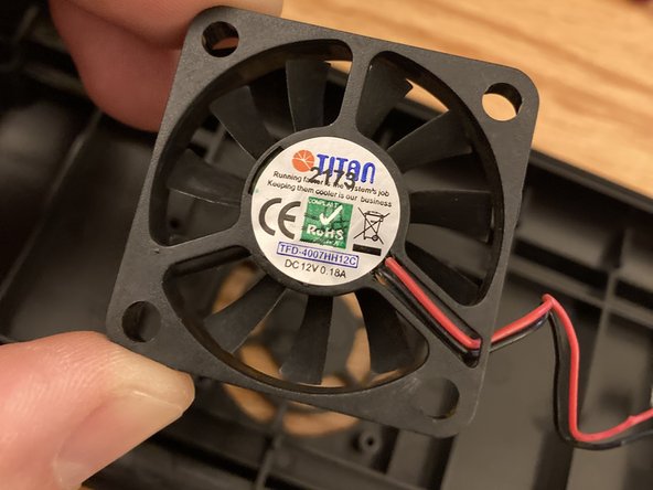

  3. Powerex MH-C980 Disassembly, Fan removal: crwdns2935265:03crwdnd2935265:01crwdnd2935265:03crwdne2935265:0 Powerex MH-C980 Disassembly, Fan removal: crwdns2935265:03crwdnd2935265:02crwdnd2935265:03crwdne2935265:0 Powerex MH-C980 Disassembly, Fan removal: crwdns2935265:03crwdnd2935265:03crwdnd2935265:03crwdne2935265:0
    • Remove fan by removing the adhesive tape from the fan cable. Then remove the 4-rubber feet stickers holding the fan into the bottom case. Then pull the fan out. Fan PN is FD-4007HH12C. Made by Titan.
    • Fan measures 40x40x7mm. Takes 12V at 0.18A. 2.16 Watts. RPM of 6500. 7.68 CFM. 0.11 INCH-H2O. <28.7 NOISE (DBA).
    • There is not room for a 10mm tall fan due to the electrical contacts that come out of the bottom of the board. The only other fan that might work is a 6mm tall fan from Orion Fans (PN OD4006-12HSS)
    • Charger seems to work just fine without the fan installed, but then the components and your batteries may get hotter than the OEM intended. (fan was too loud for me).
