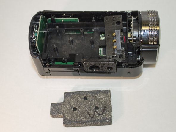

  5. PowerLead Puto PLD003 Zoom Button Replacement, Zoom Button: crwdns2935265:05crwdnd2935265:01crwdnd2935265:02crwdne2935265:0 PowerLead Puto PLD003 Zoom Button Replacement, Zoom Button: crwdns2935265:05crwdnd2935265:02crwdnd2935265:02crwdne2935265:0
    • Remove the 4 mm Phillips #1 screws holding the weight.
    • Remove the weight.

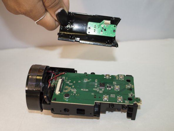

    • Remove the three 4 mm Phillips #1 screws holding the top panel in place.
  11. PowerLead Puto PLD003 Zoom Button Replacement: crwdns2935265:011crwdnd2935265:01crwdnd2935265:02crwdne2935265:0 PowerLead Puto PLD003 Zoom Button Replacement: crwdns2935265:011crwdnd2935265:02crwdnd2935265:02crwdne2935265:0
    • Push upward on the top panel to remove it from the body of the camera.

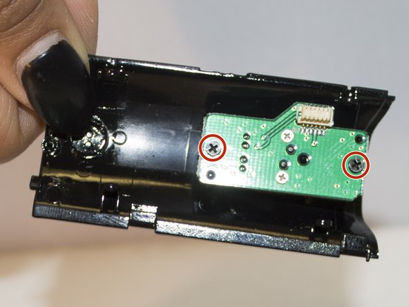

  12. PowerLead Puto PLD003 Zoom Button Replacement: crwdns2935265:012crwdnd2935265:01crwdnd2935265:02crwdne2935265:0 PowerLead Puto PLD003 Zoom Button Replacement: crwdns2935265:012crwdnd2935265:02crwdnd2935265:02crwdne2935265:0
    • Remove the two 4 mm Phillips #1 screws holding the circuit board in place.
    • Do not remove the silver screws.

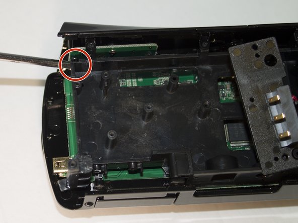

  13. PowerLead Puto PLD003 Zoom Button Replacement: crwdns2935265:013crwdnd2935265:01crwdnd2935265:01crwdne2935265:0
    • Lift the circuit board out of the plastic casing.
    • Gently pull on the zoom button to remove it from the circuit board.
