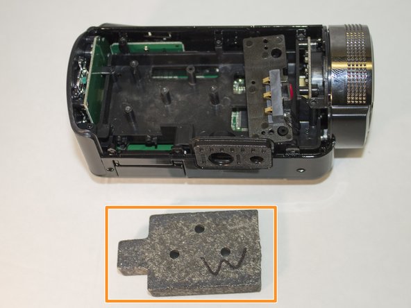

  5. PowerLead Puto PLD003 Screen Replacement, Screen: crwdns2935265:05crwdnd2935265:01crwdnd2935265:02crwdne2935265:0 PowerLead Puto PLD003 Screen Replacement, Screen: crwdns2935265:05crwdnd2935265:02crwdnd2935265:02crwdne2935265:0
    • Remove the three 4 mm Phillips #1 screws holding the weight.
    • Remove the weight.

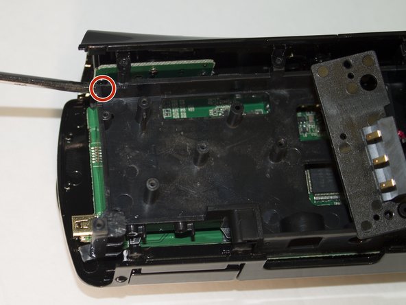

  8. PowerLead Puto PLD003 Screen Replacement: crwdns2935265:08crwdnd2935265:01crwdnd2935265:02crwdne2935265:0 PowerLead Puto PLD003 Screen Replacement: crwdns2935265:08crwdnd2935265:02crwdnd2935265:02crwdne2935265:0
    • Set aside back panel for now.
    • Remove the final 4 mm Phillips #1 screw holding the screen in place. It is very small and hard to see.

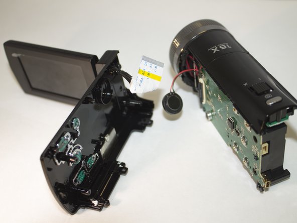

  10. PowerLead Puto PLD003 Screen Replacement: crwdns2935265:010crwdnd2935265:01crwdnd2935265:02crwdne2935265:0 PowerLead Puto PLD003 Screen Replacement: crwdns2935265:010crwdnd2935265:02crwdnd2935265:02crwdne2935265:0
    • Lift the black clip upward.
    • With the clip up, pull the white cord to the left. This will detach the screen from the body.
