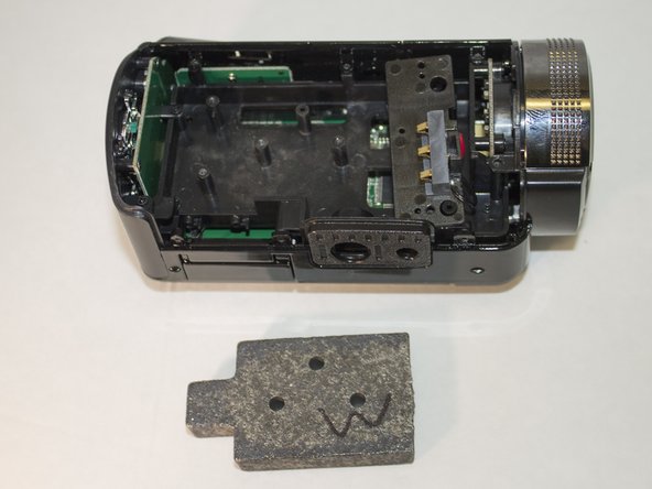

  5. PowerLead Puto PLD003 Lens Replacement, Lens: crwdns2935265:05crwdnd2935265:01crwdnd2935265:02crwdne2935265:0 PowerLead Puto PLD003 Lens Replacement, Lens: crwdns2935265:05crwdnd2935265:02crwdnd2935265:02crwdne2935265:0
    • Remove the three 4 mm Phillips #1 screws holding the weight.
    • Remove the weight.
