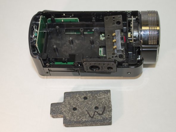

    • Remove the three 4 mm Phillips #1 screws holding the weight.
    • Remove the weight.

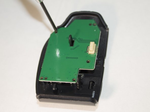

    • Place the back panel so the buttons are facing down and the circuit board is facing up.
    • Remove the three 4 mm Phillips #1 screws holding the circuit board in place.
  9. PowerLead Puto PLD003 Back Buttons Replacement: crwdns2935265:09crwdnd2935265:01crwdnd2935265:01crwdne2935265:0
    • Set aside the circuit board.
    • These nubs are what is currently holding the buttons in place.
    • Carefully apply pressure and remove the set of buttons from the nubs.
