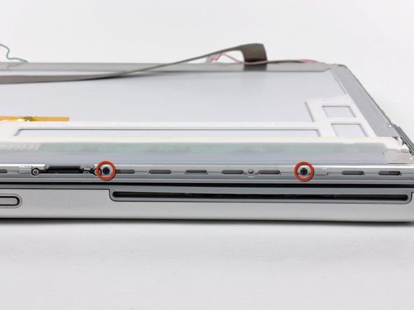

  1. PowerBook G4 Aluminum 17" 1-1.67 GHz LCD Replacement, Rear Display Bezel: crwdns2935265:01crwdnd2935265:01crwdnd2935265:02crwdne2935265:0 PowerBook G4 Aluminum 17" 1-1.67 GHz LCD Replacement, Rear Display Bezel: crwdns2935265:01crwdnd2935265:02crwdnd2935265:02crwdne2935265:0
    • Remove the two 6.3 mm Phillips screws near the lower left and right corners of the display.
    • Removing these two screws may be difficult. It is helpful to open the display as much as possible for clearance to use a screwdriver. Also, a combination of #00 Phillips and small flathead screwdrivers along with a pair of tweezers may aid in removal.

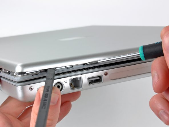

  3. PowerBook G4 Aluminum 17" 1-1.67 GHz LCD Replacement: crwdns2935265:03crwdnd2935265:01crwdnd2935265:03crwdne2935265:0 PowerBook G4 Aluminum 17" 1-1.67 GHz LCD Replacement: crwdns2935265:03crwdnd2935265:02crwdnd2935265:03crwdne2935265:0 PowerBook G4 Aluminum 17" 1-1.67 GHz LCD Replacement: crwdns2935265:03crwdnd2935265:03crwdnd2935265:03crwdne2935265:0
    • Insert the flat end of a spudger between the rear display bezel and the plastic rim attached to the front display bezel near the lower right corner of the display.
    • Do not try to insert the spudger between the front display bezel and its plastic surround.
    • While carefully prying the rear display bezel away from the display assembly, use a small flathead screwdriver to pry the small steel clip nearest the bottom right corner of the display away from the edge of the front display bezel.
    • Repeat the above procedure until you've released all the clips along the right side of the display.

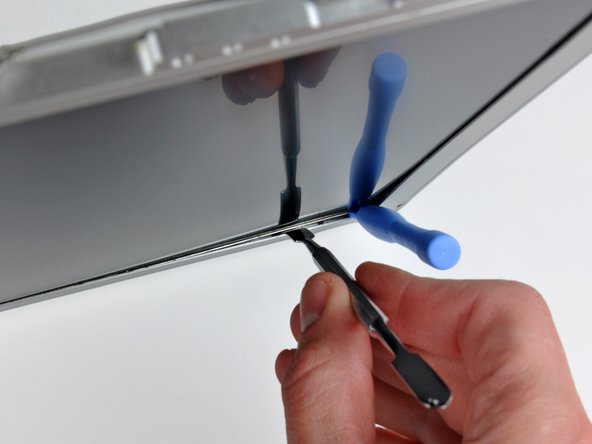

  5. PowerBook G4 Aluminum 17" 1-1.67 GHz LCD Replacement: crwdns2935265:05crwdnd2935265:01crwdnd2935265:02crwdne2935265:0 PowerBook G4 Aluminum 17" 1-1.67 GHz LCD Replacement: crwdns2935265:05crwdnd2935265:02crwdnd2935265:02crwdne2935265:0
    • Insert the flat end of a spudger between the rear display bezel and the plastic surround of the front display bezel near the lower left corner of the display.
    • Carefully pry the rear display bezel away from the front display bezel to expose the metal clips along the left side of the display.
    • Repeat the previous procedure to release the clips along the left side of the rear display bezel.

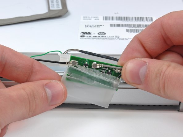

  16. PowerBook G4 Aluminum 17" 1-1.67 GHz LCD Replacement: crwdns2935265:016crwdnd2935265:01crwdnd2935265:02crwdne2935265:0 PowerBook G4 Aluminum 17" 1-1.67 GHz LCD Replacement: crwdns2935265:016crwdnd2935265:02crwdnd2935265:02crwdne2935265:0
    • Carefully peel the protective translucent shield off the antenna board.
    • If you damage this during disassembly, be sure to tape over any tears or cracks to avoid unintended shorting.

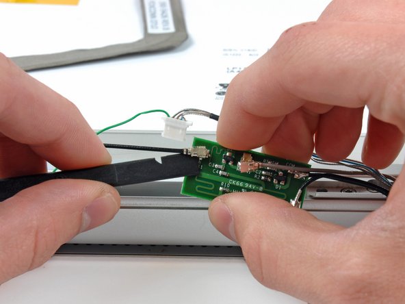

  17. PowerBook G4 Aluminum 17" 1-1.67 GHz LCD Replacement: crwdns2935265:017crwdnd2935265:01crwdnd2935265:02crwdne2935265:0 PowerBook G4 Aluminum 17" 1-1.67 GHz LCD Replacement: crwdns2935265:017crwdnd2935265:02crwdnd2935265:02crwdne2935265:0
    • Use the flat end of a spudger to pry the the antenna cables straight up off their sockets.

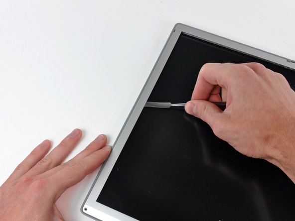

  24. PowerBook G4 Aluminum 17" 1-1.67 GHz LCD Replacement: crwdns2935265:024crwdnd2935265:01crwdnd2935265:02crwdne2935265:0 PowerBook G4 Aluminum 17" 1-1.67 GHz LCD Replacement: crwdns2935265:024crwdnd2935265:02crwdnd2935265:02crwdne2935265:0
    • Insert a plastic opening tool between the metal LCD frame and the front bezel.
    • Be sure you are prying between the metal LCD frame and the front bezel, not between the metal LCD frame and the LCD.
    • It may be necessary to reheat this area until the adhesive yields enough to insert the edge of a tool.
    • Use the flat end of a metal spudger to gently pry up the adhesive securing the metal LCD frame to the front bezel, taking special care not to scratch the LCD panel.

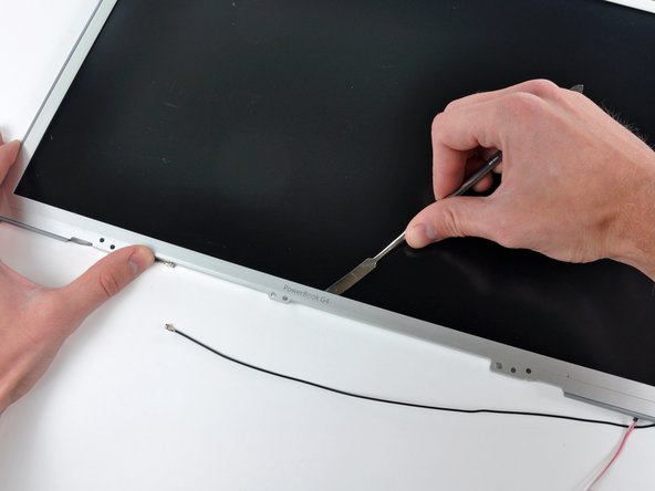

  26. PowerBook G4 Aluminum 17" 1-1.67 GHz LCD Replacement: crwdns2935265:026crwdnd2935265:01crwdnd2935265:03crwdne2935265:0 PowerBook G4 Aluminum 17" 1-1.67 GHz LCD Replacement: crwdns2935265:026crwdnd2935265:02crwdnd2935265:03crwdne2935265:0 PowerBook G4 Aluminum 17" 1-1.67 GHz LCD Replacement: crwdns2935265:026crwdnd2935265:03crwdnd2935265:03crwdne2935265:0
    • Continue running the edge of your metal spudger between the LCD frame and the front bezel until the right, bottom, and left sides of the LCD are free.
