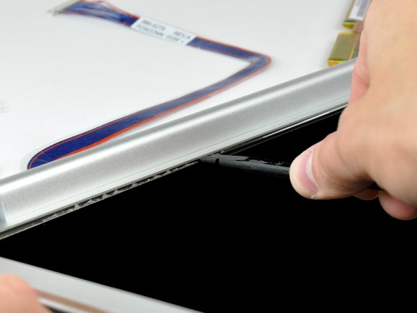

    • Insert the flat end of a spudger between the front display bezel and the plastic rim attached to the rear bezel near the lower left corner of the display.
    • Do not insert the spudger between the plastic rim of the rear display bezel and the aluminum rear display bezel plate.
  22. PowerBook G4 Aluminum 15" 1.67 GHz Front Display Bezel Replacement: crwdns2935265:022crwdnd2935265:01crwdnd2935265:02crwdne2935265:0 PowerBook G4 Aluminum 15" 1.67 GHz Front Display Bezel Replacement: crwdns2935265:022crwdnd2935265:02crwdnd2935265:02crwdne2935265:0
    • With your spudger still inserted under the front display bezel, run it around the lower left corner of the display.
    • Rotate the spudger away from yourself to pry the rear display bezel off the aluminum tabs on the front display bezel.
    • Work your way down the side of the display until the rear display bezel has been separated from the front display bezel.

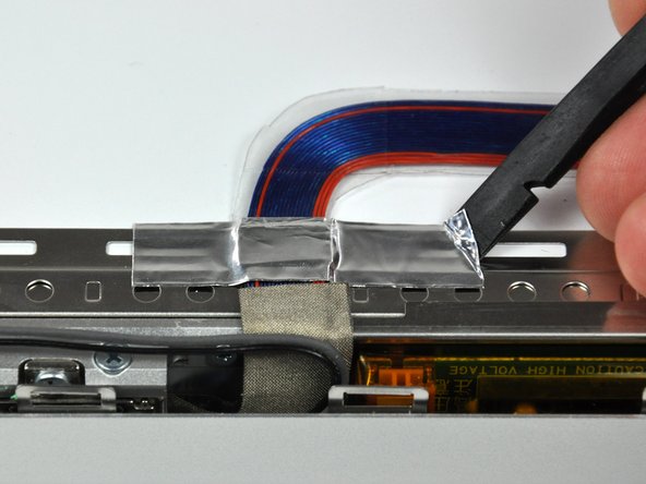

  27. PowerBook G4 Aluminum 15" 1.67 GHz Front Display Bezel Replacement, Front Display Bezel: crwdns2935265:027crwdnd2935265:01crwdnd2935265:02crwdne2935265:0 PowerBook G4 Aluminum 15" 1.67 GHz Front Display Bezel Replacement, Front Display Bezel: crwdns2935265:027crwdnd2935265:02crwdnd2935265:02crwdne2935265:0
    • If necessary, remove the pieces of tape covering the two inverter leads.
    • Use the flat end of a spudger to remove the piece of foil tape securing the display data cable to the LCD frame.

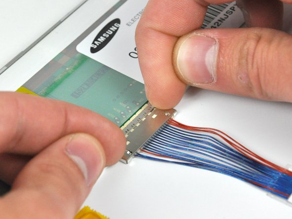

  28. PowerBook G4 Aluminum 15" 1.67 GHz Front Display Bezel Replacement: crwdns2935265:028crwdnd2935265:01crwdnd2935265:02crwdne2935265:0 PowerBook G4 Aluminum 15" 1.67 GHz Front Display Bezel Replacement: crwdns2935265:028crwdnd2935265:02crwdnd2935265:02crwdne2935265:0
    • If necessary, remove the piece of tape covering the display data cable connector.
    • Pull the display data cable connector away from its socket to disconnect it from the LCD.

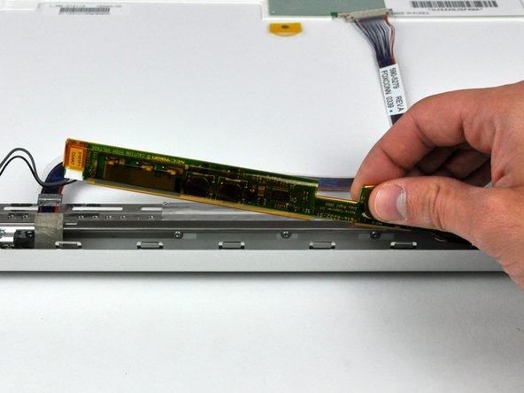

  31. PowerBook G4 Aluminum 15" 1.67 GHz Front Display Bezel Replacement: crwdns2935265:031crwdnd2935265:01crwdnd2935265:02crwdne2935265:0 PowerBook G4 Aluminum 15" 1.67 GHz Front Display Bezel Replacement: crwdns2935265:031crwdnd2935265:02crwdnd2935265:02crwdne2935265:0
    • The inverter is an extremely thin circuit board that is very delicate and easily cracked. Take care when handling.
    • Use a spudger to raise the end of the inverter out from the clutch cover.
    • Lift the inverter enough to access both cable connectors.

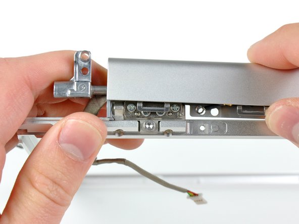

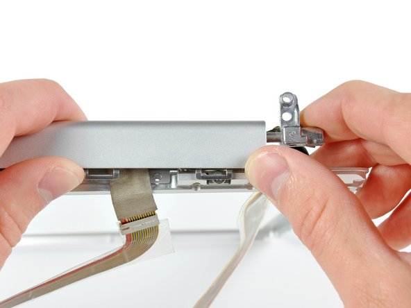

  37. PowerBook G4 Aluminum 15" 1.67 GHz Front Display Bezel Replacement: crwdns2935265:037crwdnd2935265:01crwdnd2935265:03crwdne2935265:0 PowerBook G4 Aluminum 15" 1.67 GHz Front Display Bezel Replacement: crwdns2935265:037crwdnd2935265:02crwdnd2935265:03crwdne2935265:0 PowerBook G4 Aluminum 15" 1.67 GHz Front Display Bezel Replacement: crwdns2935265:037crwdnd2935265:03crwdnd2935265:03crwdne2935265:0
    • The clutch cover is constructed from aluminum and is held on to the clutch hinges with metal clips that require a good deal of force to remove. Proceed with caution.
    • Use your thumbs to push the clutch cover away from the clutch hinges.
    • While pressing with your thumbs, rotate the clutch cover toward yourself about its long edge to pop it off the clutch hinge.
    • It may be necessary to wiggle the clutch cover while pressing it away from the clutch hinges to release the retaining clips.
    • Repeat this process for the other side of the clutch cover. Once the clutch cover is completely free from the clutch hinges, lift it off the front display bezel.

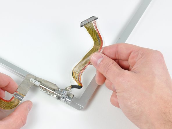

  38. PowerBook G4 Aluminum 15" 1.67 GHz Front Display Bezel Replacement: crwdns2935265:038crwdnd2935265:01crwdnd2935265:02crwdne2935265:0 PowerBook G4 Aluminum 15" 1.67 GHz Front Display Bezel Replacement: crwdns2935265:038crwdnd2935265:02crwdnd2935265:02crwdne2935265:0
    • De-route the inverter and display data cables from the clutch hinges and set them aside.

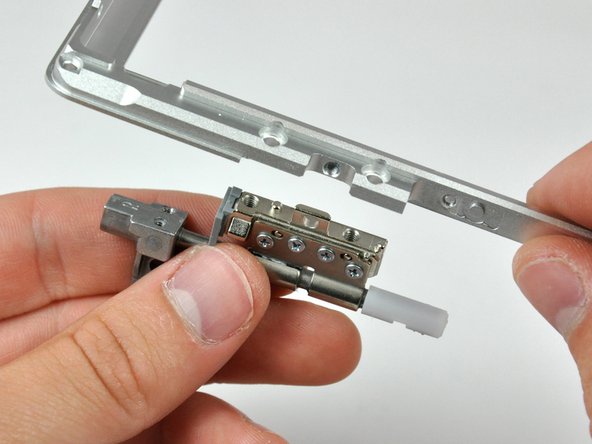

    • Remove the three T8 Torx screws securing the right clutch hinge to the front display bezel.
    • Remove the right clutch hinge and set it aside.

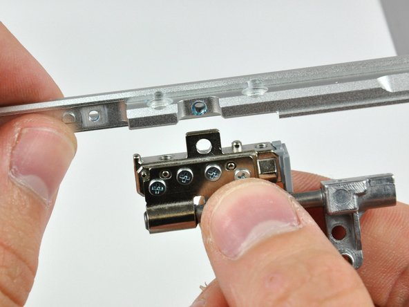

  40. PowerBook G4 Aluminum 15" 1.67 GHz Front Display Bezel Replacement: crwdns2935265:040crwdnd2935265:01crwdnd2935265:02crwdne2935265:0 PowerBook G4 Aluminum 15" 1.67 GHz Front Display Bezel Replacement: crwdns2935265:040crwdnd2935265:02crwdnd2935265:02crwdne2935265:0
    • Remove the three T8 Torx screws securing the left clutch hinge to the front bezel.
    • Remove the left clutch hinge and set it aside.
