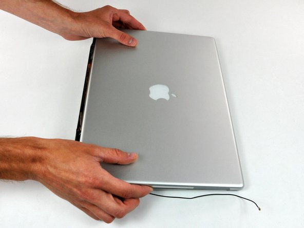

  18. PowerBook G4 Aluminum 15" 1.67 GHz Display Data Cable Replacement: crwdns2935265:018crwdnd2935265:01crwdnd2935265:01crwdne2935265:0
    • Support the display with one hand as you remove the remaining T8 screws.
    • Remove the upper two full thread 10 mm T8 Torx screws from each side of the display, then the two lower shanked 13 mm screws (four screws total).
    • When replacing the display, make sure that the correct screw pins down the ground loop from the display data cable.
    • Disconnect the two antenna cables from the airport/bluetooth card (shown in yellow circles), as well as the display cable (wide connector right hand upper corner) and the cable on top left corner of the logic board (shown in blue square).
  19. PowerBook G4 Aluminum 15" 1.67 GHz Display Data Cable Replacement: crwdns2935265:019crwdnd2935265:01crwdnd2935265:01crwdne2935265:0
    • Lift the display assembly off the lower case.

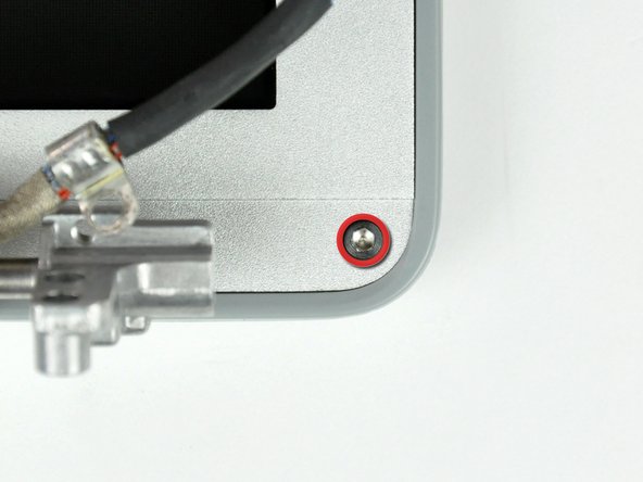

  20. PowerBook G4 Aluminum 15" 1.67 GHz Display Data Cable Replacement, Rear Display Bezel: crwdns2935265:020crwdnd2935265:01crwdnd2935265:02crwdne2935265:0 PowerBook G4 Aluminum 15" 1.67 GHz Display Data Cable Replacement, Rear Display Bezel: crwdns2935265:020crwdnd2935265:02crwdnd2935265:02crwdne2935265:0
    • Remove the two 6mm long, 1.5 mm hex screws near the lower left and right corners of the display.
    • A T6 Torx screwdriver works just fine.

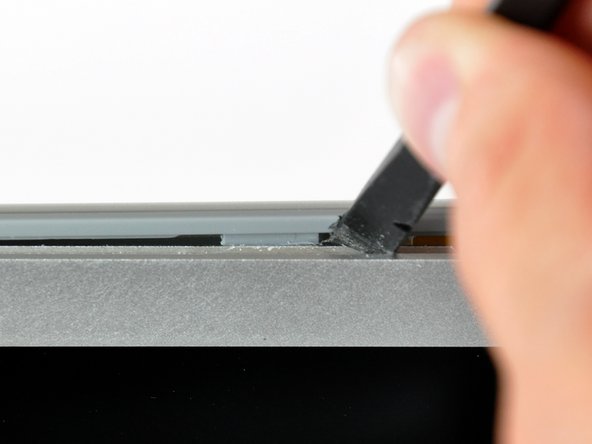

  21. PowerBook G4 Aluminum 15" 1.67 GHz Display Data Cable Replacement: crwdns2935265:021crwdnd2935265:01crwdnd2935265:01crwdne2935265:0
    • Insert the flat end of a spudger between the front display bezel and the plastic rim attached to the rear bezel near the lower left corner of the display.
    • Do not insert the spudger between the plastic rim of the rear display bezel and the aluminum rear display bezel plate.

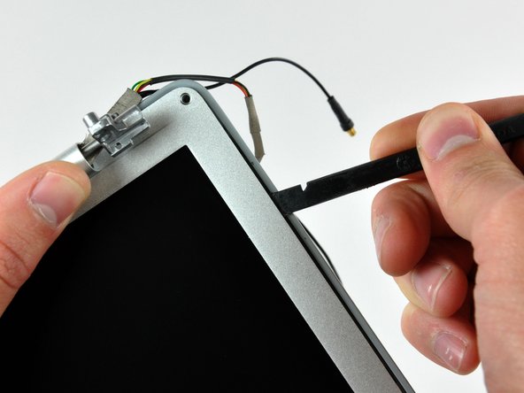

  22. PowerBook G4 Aluminum 15" 1.67 GHz Display Data Cable Replacement: crwdns2935265:022crwdnd2935265:01crwdnd2935265:02crwdne2935265:0 PowerBook G4 Aluminum 15" 1.67 GHz Display Data Cable Replacement: crwdns2935265:022crwdnd2935265:02crwdnd2935265:02crwdne2935265:0
    • With your spudger still inserted under the front display bezel, run it around the lower left corner of the display.
    • Rotate the spudger away from yourself to pry the rear display bezel off the aluminum tabs on the front display bezel.
    • Work your way down the side of the display until the rear display bezel has been separated from the front display bezel.

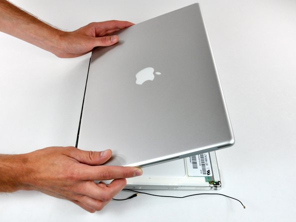

  26. PowerBook G4 Aluminum 15" 1.67 GHz Display Data Cable Replacement: crwdns2935265:026crwdnd2935265:01crwdnd2935265:01crwdne2935265:0
    • Disconnect both antenna cables from the rear display bezel.
    • Remove the rear display bezel and set it aside.

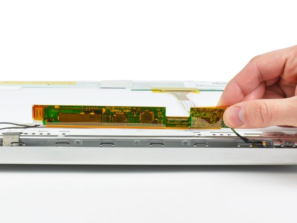

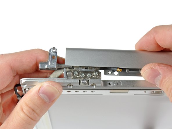

  27. PowerBook G4 Aluminum 15" 1.67 GHz Display Data Cable Replacement, Clutch Cover: crwdns2935265:027crwdnd2935265:01crwdnd2935265:02crwdne2935265:0 PowerBook G4 Aluminum 15" 1.67 GHz Display Data Cable Replacement, Clutch Cover: crwdns2935265:027crwdnd2935265:02crwdnd2935265:02crwdne2935265:0
    • The inverter is an extremely thin circuit board that is very delicate and easily cracked. Take care when handling.
    • Use a spudger to raise the end of the inverter out from the clutch cover.
    • Lift the inverter enough to access both cable connectors.

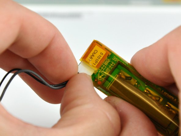

  28. PowerBook G4 Aluminum 15" 1.67 GHz Display Data Cable Replacement: crwdns2935265:028crwdnd2935265:01crwdnd2935265:02crwdne2935265:0 PowerBook G4 Aluminum 15" 1.67 GHz Display Data Cable Replacement: crwdns2935265:028crwdnd2935265:02crwdnd2935265:02crwdne2935265:0
    • Disconnect both inverter cables by pulling their connectors away from the sockets on the inverter.
    • Remove the inverter from your display and set it aside.

    • The clutch cover is constructed from aluminum and is held on to the clutch hinges with metal clips that require a good deal of force to remove. Proceed with caution.
    • Use your thumbs to push the clutch cover away from the clutch hinges.
    • While pressing with your thumbs, rotate the clutch cover toward yourself about its long edge to pop it off the clutch hinge.
    • It may be necessary to wiggle the clutch cover while pressing it away from the clutch hinges to release the retaining clips.
  31. PowerBook G4 Aluminum 15" 1.67 GHz Display Data Cable Replacement: crwdns2935265:031crwdnd2935265:01crwdnd2935265:01crwdne2935265:0
    • Repeat this process for the other side of the clutch cover. Once the clutch cover is completely free from the clutch hinges, lift it off the front display bezel.
