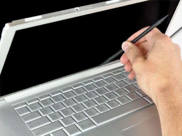

  21. PowerBook G4 Aluminum 15" 1-1.5 GHz LCD Replacement: crwdns2935265:021crwdnd2935265:01crwdnd2935265:02crwdne2935265:0 PowerBook G4 Aluminum 15" 1-1.5 GHz LCD Replacement: crwdns2935265:021crwdnd2935265:02crwdnd2935265:02crwdne2935265:0
    • Lift the LCD off the front bezel enough to insert the flat end of a spudger between the metal LCD frame and the front display bezel.
    • Trying to insert your spudger between the LCD glass and the inner metal LCD frame will surely damage your LCD.
    • Run your spudger along the lower edge of the front display bezel to separate the adhesive from the LCD frame.

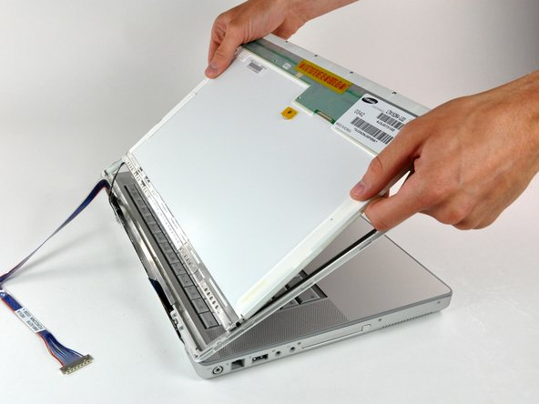

  22. PowerBook G4 Aluminum 15" 1-1.5 GHz LCD Replacement: crwdns2935265:022crwdnd2935265:01crwdnd2935265:02crwdne2935265:0 PowerBook G4 Aluminum 15" 1-1.5 GHz LCD Replacement: crwdns2935265:022crwdnd2935265:02crwdnd2935265:02crwdne2935265:0
    • Pull the LCD toward the top edge of the front display bezel, minding any cables that may get caught.
    • If you are replacing the LCD, make sure the replacement has the lid-closure sleep-switch magnet in the correct position, or transfer the magnet from the old display. The magnet is the 4mm disc near the top center of the LCD, held in place by clear yellow tape in this image.
