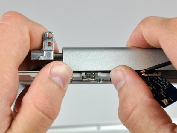

    • Insert the flat end of a spudger between the rear display bezel and the clutch cover.
    • Twist the spudger to unclip the rear bezel from the clutch cover.

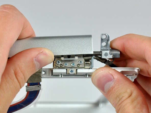

  29. PowerBook G4 Aluminum 15" 1-1.5 GHz Front Display Bezel Replacement: crwdns2935265:029crwdnd2935265:01crwdnd2935265:02crwdne2935265:0 PowerBook G4 Aluminum 15" 1-1.5 GHz Front Display Bezel Replacement: crwdns2935265:029crwdnd2935265:02crwdnd2935265:02crwdne2935265:0
    • Repeat the previous steps to separate the right side of the rear display bezel from the display.
    • Use your spudger to pry the plastic retaining clips on the rear display bezel over the raised aluminum tabs on the front display bezel.
    • At this point, the clips on the left and right edges of the rear display bezel should be free from the raised aluminum tabs on the front display bezel. If they are not, use a spudger to pry them past the front display bezel.

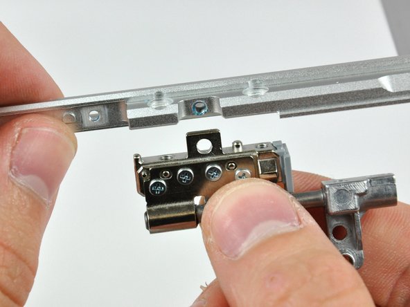

  30. PowerBook G4 Aluminum 15" 1-1.5 GHz Front Display Bezel Replacement: crwdns2935265:030crwdnd2935265:01crwdnd2935265:03crwdne2935265:0 PowerBook G4 Aluminum 15" 1-1.5 GHz Front Display Bezel Replacement: crwdns2935265:030crwdnd2935265:02crwdnd2935265:03crwdne2935265:0 PowerBook G4 Aluminum 15" 1-1.5 GHz Front Display Bezel Replacement: crwdns2935265:030crwdnd2935265:03crwdnd2935265:03crwdne2935265:0
    • Slightly lift the lower edge of the rear display bezel and push it toward the top edge of the display, releasing the clips along the top edge of the rear display bezel.
    • Rotate the rear display bezel toward yourself and lay it flat on the table.

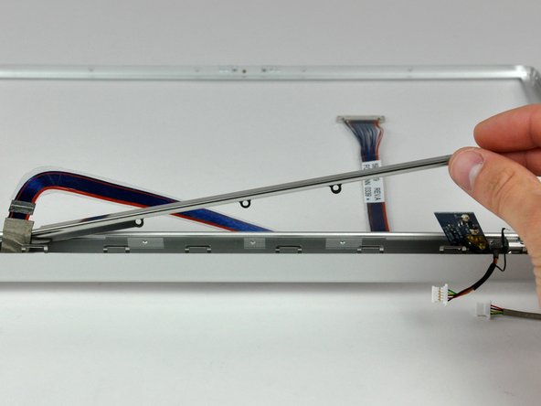

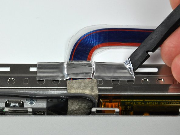

  34. PowerBook G4 Aluminum 15" 1-1.5 GHz Front Display Bezel Replacement, Front Display Bezel: crwdns2935265:034crwdnd2935265:01crwdnd2935265:02crwdne2935265:0 PowerBook G4 Aluminum 15" 1-1.5 GHz Front Display Bezel Replacement, Front Display Bezel: crwdns2935265:034crwdnd2935265:02crwdnd2935265:02crwdne2935265:0
    • If necessary, remove the pieces of tape covering the two inverter leads.
    • Use the flat end of a spudger to remove the piece of foil tape securing the display data cable to the LCD frame.

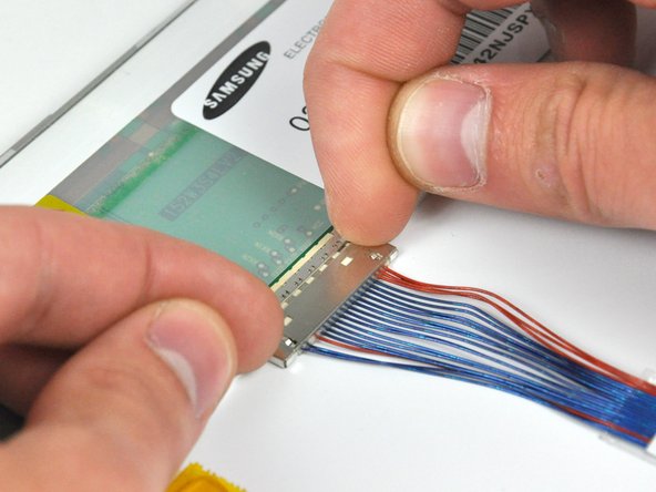

  35. PowerBook G4 Aluminum 15" 1-1.5 GHz Front Display Bezel Replacement: crwdns2935265:035crwdnd2935265:01crwdnd2935265:02crwdne2935265:0 PowerBook G4 Aluminum 15" 1-1.5 GHz Front Display Bezel Replacement: crwdns2935265:035crwdnd2935265:02crwdnd2935265:02crwdne2935265:0
    • If necessary, remove the piece of tape covering the display data cable connector.
    • Pull the display data cable connector away from its socket to disconnect it from the LCD.

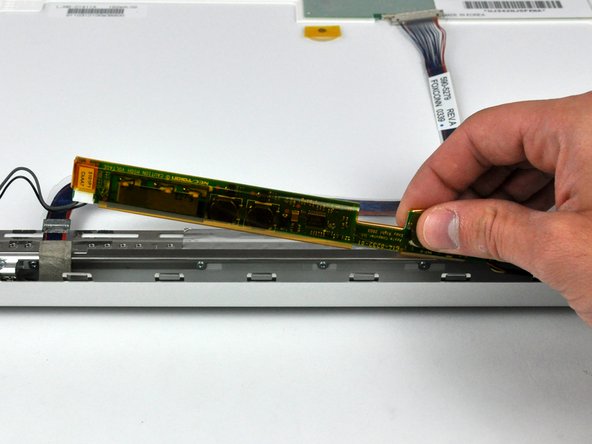

  38. PowerBook G4 Aluminum 15" 1-1.5 GHz Front Display Bezel Replacement: crwdns2935265:038crwdnd2935265:01crwdnd2935265:02crwdne2935265:0 PowerBook G4 Aluminum 15" 1-1.5 GHz Front Display Bezel Replacement: crwdns2935265:038crwdnd2935265:02crwdnd2935265:02crwdne2935265:0
    • The inverter is an extremely thin circuit board that is very delicate and easily cracked. Take care when handling.
    • Use a spudger to raise the end of the inverter out from the clutch cover.
    • Lift the inverter enough to access both cable connectors.
  39. PowerBook G4 Aluminum 15" 1-1.5 GHz Front Display Bezel Replacement: crwdns2935265:039crwdnd2935265:01crwdnd2935265:01crwdne2935265:0
    • Disconnect the inverter cable by pulling its connector away from the socket on the inverter board.

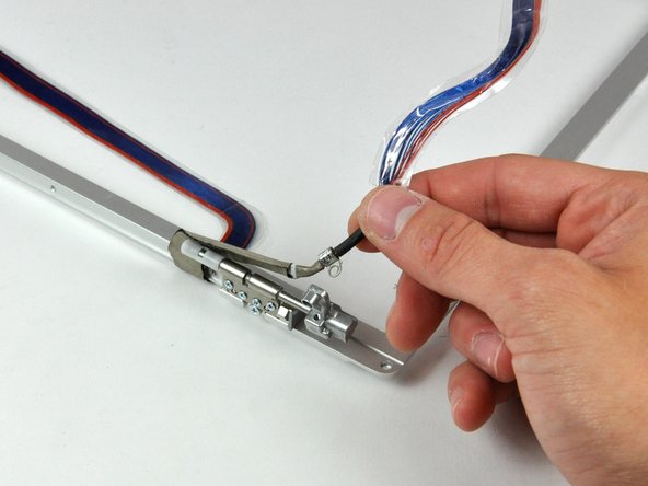

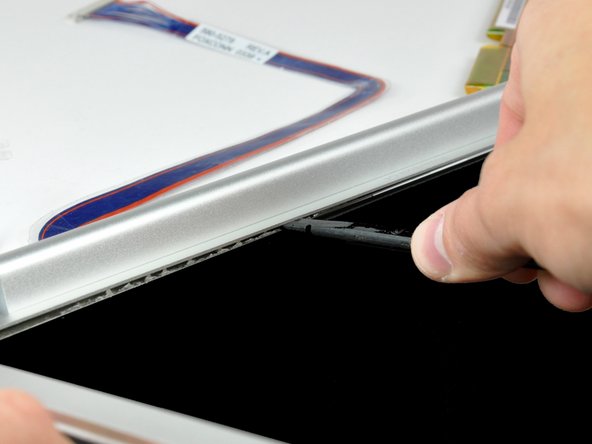

    • Flip your display over so the front bezel is facing up.
    • Lift the front bezel off the LCD enough to insert the flat end of a spudger between the metal LCD frame and the front display bezel.
    • Trying to insert your spudger between the LCD glass and the metal LCD frame will surely damage your LCD.
    • Run your spudger along the lower edge of the front display bezel to separate the adhesive from the LCD frame.

    • Pull the LCD toward the top edge of the front display bezel, minding any cables that may get caught.
  42. PowerBook G4 Aluminum 15" 1-1.5 GHz Front Display Bezel Replacement: crwdns2935265:042crwdnd2935265:01crwdnd2935265:01crwdne2935265:0
    • If necessary, lift the inverter out from the clutch cover.

    • Remove the five Phillips screws securing the LCD retaining bracket to the front display bezel.
    • Lift the LCD retaining bracket off the front display bezel.
    • Some machines do not have this bracket. If your machine is missing the bracket, remove the five screws and proceed to the next step.

    • The clutch cover is constructed from aluminum and is held on to the clutch hinges with metal clips that require a good deal of force to remove. Proceed with caution.
    • Use your thumbs to push the clutch cover away from the clutch hinges.
    • While pressing with your thumbs, rotate the clutch cover toward yourself about its long edge to pop it off the clutch hinge.
    • It may be necessary to wiggle the clutch cover while pressing it away from the clutch hinges to release the retaining clips.
    • Repeat this process for the other side of the clutch cover. Once the clutch cover is completely free from the clutch hinges, lift it off the front display bezel.

    • De-route the inverter and display data cables from the clutch hinges and set them aside.

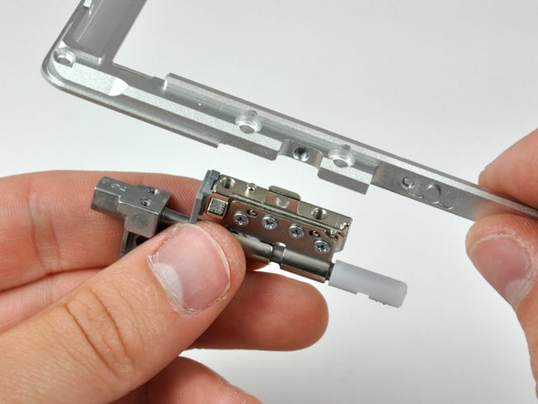

  46. PowerBook G4 Aluminum 15" 1-1.5 GHz Front Display Bezel Replacement: crwdns2935265:046crwdnd2935265:01crwdnd2935265:02crwdne2935265:0 PowerBook G4 Aluminum 15" 1-1.5 GHz Front Display Bezel Replacement: crwdns2935265:046crwdnd2935265:02crwdnd2935265:02crwdne2935265:0
    • Remove the three Phillips screws securing the right clutch hinge to the front display bezel.
    • Remove the right clutch hinge and set it aside.
  47. PowerBook G4 Aluminum 15" 1-1.5 GHz Front Display Bezel Replacement: crwdns2935265:047crwdnd2935265:01crwdnd2935265:02crwdne2935265:0 PowerBook G4 Aluminum 15" 1-1.5 GHz Front Display Bezel Replacement: crwdns2935265:047crwdnd2935265:02crwdnd2935265:02crwdne2935265:0
    • Remove the three Phillips screws securing the left clutch hinge to the front bezel.
    • Remove the left clutch hinge and set it aside.
