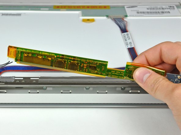

  13. PowerBook G4 Aluminum 15" 1-1.5 GHz Display Inverter Replacement, Display Inverter: crwdns2935265:013crwdnd2935265:01crwdnd2935265:02crwdne2935265:0 PowerBook G4 Aluminum 15" 1-1.5 GHz Display Inverter Replacement, Display Inverter: crwdns2935265:013crwdnd2935265:02crwdnd2935265:02crwdne2935265:0
    • The inverter is an extremely thin circuit board that is very delicate and easily cracked. Take care when handling.
    • Using the tip of a spudger, raise the inverter out from the clutch cover.
    • Lift the inverter enough to reveal both cable connectors.

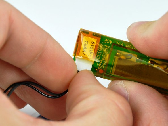

  14. PowerBook G4 Aluminum 15" 1-1.5 GHz Display Inverter Replacement: crwdns2935265:014crwdnd2935265:01crwdnd2935265:02crwdne2935265:0 PowerBook G4 Aluminum 15" 1-1.5 GHz Display Inverter Replacement: crwdns2935265:014crwdnd2935265:02crwdnd2935265:02crwdne2935265:0
    • Disconnect both inverter cables by pulling their connectors away from the sockets on the inverter board.
    • Remove the inverter from the display.
