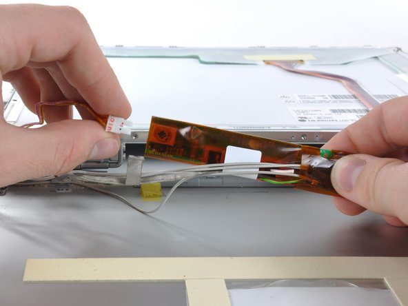

  74. PowerBook G4 Aluminum 12" 867 MHz Right Clutch Hinge Replacement, LCD: crwdns2935265:076crwdnd2935265:01crwdnd2935265:02crwdne2935265:0 PowerBook G4 Aluminum 12" 867 MHz Right Clutch Hinge Replacement, LCD: crwdns2935265:076crwdnd2935265:02crwdnd2935265:02crwdne2935265:0
    • Disconnect the inverter cable by pulling the connector away from the socket on the inverter board.
