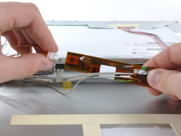

  46. PowerBook G4 Aluminum 12" 867 MHz Display Inverter Replacement, Logic Board: crwdns2935265:046crwdnd2935265:01crwdnd2935265:01crwdne2935265:0
    • Remove the two Phillips screws from the bottom right of the logic board.
    • Do not lift the logic board out without disconnecting the DC-In connector underneath the logic board.
  47. PowerBook G4 Aluminum 12" 867 MHz Display Inverter Replacement: crwdns2935265:047crwdnd2935265:01crwdnd2935265:01crwdne2935265:0
    • Lift the logic board partly up from the optical side.
  48. PowerBook G4 Aluminum 12" 867 MHz Display Inverter Replacement: crwdns2935265:048crwdnd2935265:01crwdnd2935265:01crwdne2935265:0
    • Disconnect the DC-In connector from the underside of the logic board.
  49. PowerBook G4 Aluminum 12" 867 MHz Display Inverter Replacement, DC-In Board: crwdns2935265:049crwdnd2935265:01crwdnd2935265:01crwdne2935265:0
    • There may be black tape covering the screw in the following step, remove it if necessary.
    • Remove the single Phillips screw that attaches the DC-In board to the lower case.

  74. PowerBook G4 Aluminum 12" 867 MHz Display Inverter Replacement, Display Inverter: crwdns2935265:076crwdnd2935265:01crwdnd2935265:02crwdne2935265:0 PowerBook G4 Aluminum 12" 867 MHz Display Inverter Replacement, Display Inverter: crwdns2935265:076crwdnd2935265:02crwdnd2935265:02crwdne2935265:0
    • Disconnect the inverter cable by pulling the connector away from the socket on the inverter board.
  75. PowerBook G4 Aluminum 12" 867 MHz Display Inverter Replacement: crwdns2935265:077crwdnd2935265:01crwdnd2935265:01crwdne2935265:0
    • Starting at the two tape tabs, peel the tape away from the display inverter to expose the antenna board.
    • Separate the antenna board from the display inverter.
    • Remove the display inverter.
