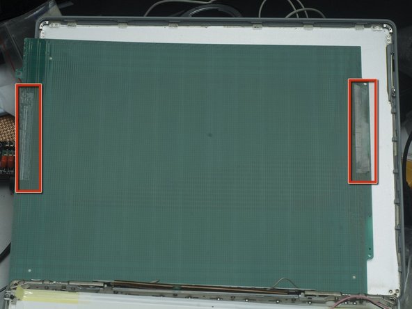

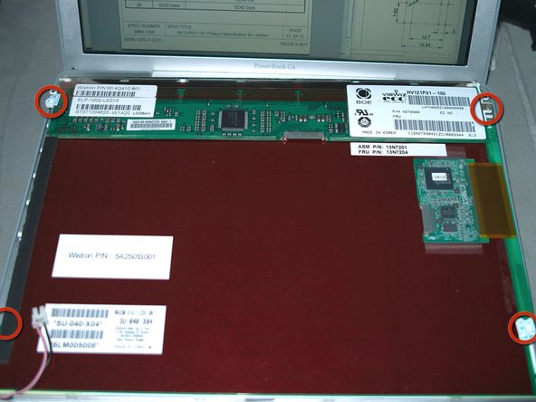

  13. PowerBook G4 Aluminum 12" 1-1.5 GHz LCD panel upgrade, LCD panel upgrade: crwdns2935265:013crwdnd2935265:01crwdnd2935265:03crwdne2935265:0 PowerBook G4 Aluminum 12" 1-1.5 GHz LCD panel upgrade, LCD panel upgrade: crwdns2935265:013crwdnd2935265:02crwdnd2935265:03crwdne2935265:0 PowerBook G4 Aluminum 12" 1-1.5 GHz LCD panel upgrade, LCD panel upgrade: crwdns2935265:013crwdnd2935265:03crwdnd2935265:03crwdne2935265:0
    • Some HV121P01 are IBM/Lenovo/Thinkpad parts. Comes with Wacom Digitizer and front shield. Remove the Wacom Digitizer first.
    • 1. remove the 4 philips screws in red circles.
    • 2. use some thin object, like a knife, to separate the 2 double sided tapes in red rectangles from the white plastic back.
    • The front shield can protect the screen during the following steps, remove it only after anything else are done!

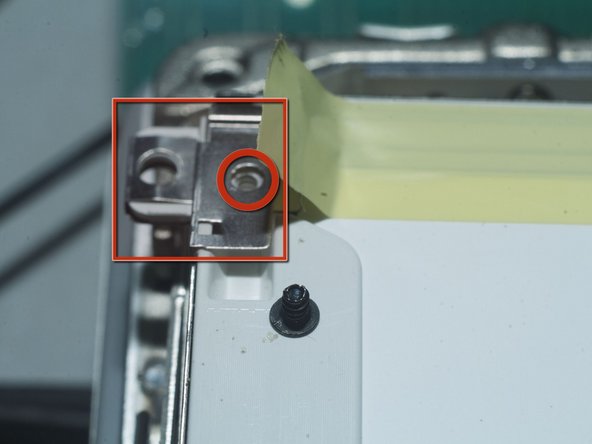

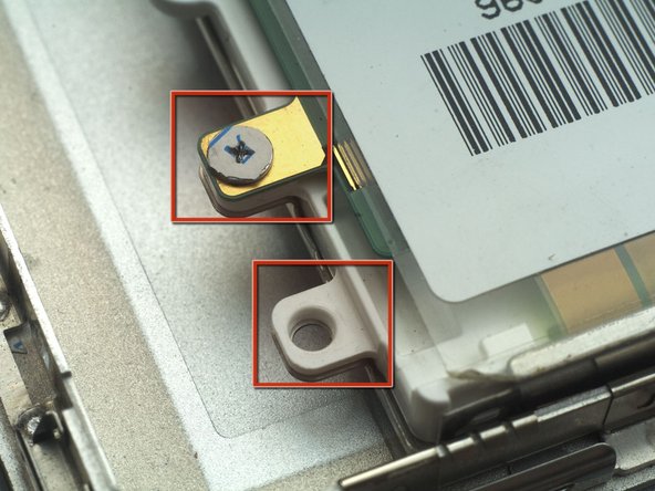

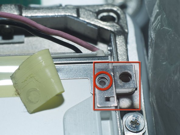

  14. PowerBook G4 Aluminum 12" 1-1.5 GHz LCD panel upgrade: crwdns2935265:014crwdnd2935265:01crwdnd2935265:03crwdne2935265:0 PowerBook G4 Aluminum 12" 1-1.5 GHz LCD panel upgrade: crwdns2935265:014crwdnd2935265:02crwdnd2935265:03crwdne2935265:0 PowerBook G4 Aluminum 12" 1-1.5 GHz LCD panel upgrade: crwdns2935265:014crwdnd2935265:03crwdnd2935265:03crwdne2935265:0
    • Lift 2 ends of tape,at the CCFL side, and remove 2 black philips screws in the red circles.
    • Remove the 2 small metal parts in the red rectangles.

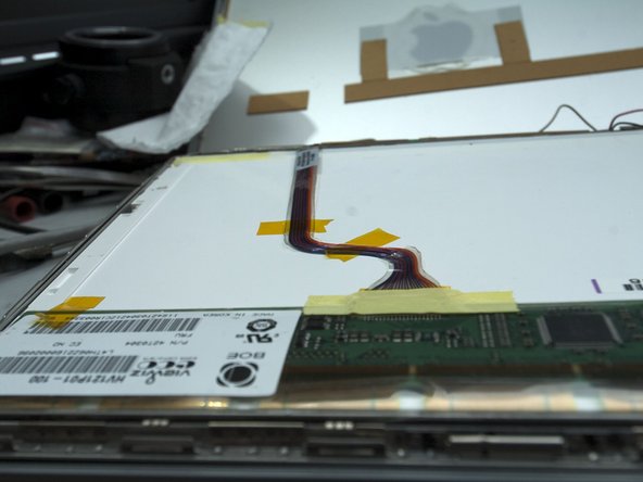

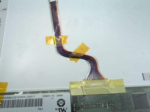

  15. PowerBook G4 Aluminum 12" 1-1.5 GHz LCD panel upgrade: crwdns2935265:015crwdnd2935265:01crwdnd2935265:01crwdne2935265:0
    • You need to extend the CCFL High Voltage cable, if it is not long enough to reach the inverter. You'd better get a electronics friend to help you. Should be very easy for him. If it's done wrong. Leakage or shock may happen.
    • Please measure and calculate the cable length precisely. There is not enough space for wires which are too long. In this pic, they ARE 25mm/1" longer than needed. Reworking them is painful.

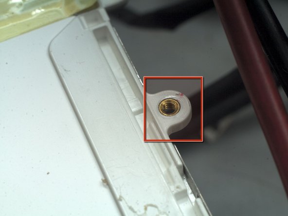

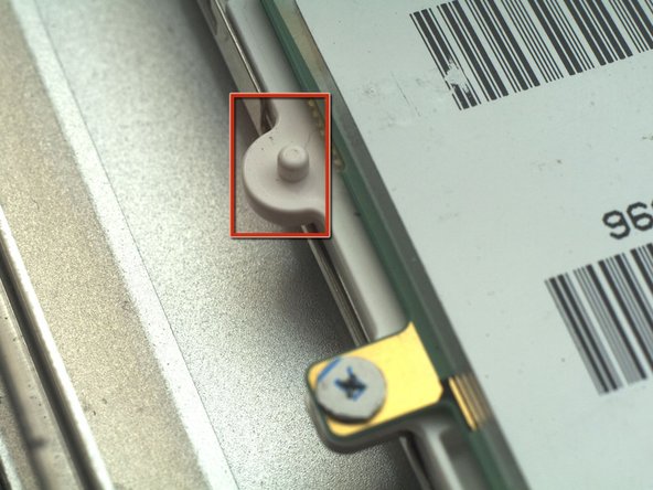

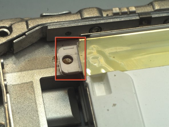

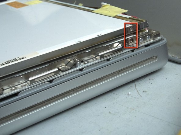

  19. PowerBook G4 Aluminum 12" 1-1.5 GHz LCD panel upgrade: crwdns2935265:019crwdnd2935265:01crwdnd2935265:02crwdne2935265:0 PowerBook G4 Aluminum 12" 1-1.5 GHz LCD panel upgrade: crwdns2935265:019crwdnd2935265:02crwdnd2935265:02crwdne2935265:0
    • Drill four 1.5mm~2mm(1/16"~5/64") diameter, 3mm(1/8") deep holes at the left and right side of panel at the position corresponding to original LCD panel. Do NOT drill the glass!!.
    • 2 will be drilled on metal and then plastic, 2 on plastic. As said before, the metal is very hard! use high quality drill and be patient and avoid overheating, or you'll burn your hand or the plastic and LCD glass.
    • In these pics, the upper LCD is the original one, the bottom one is HV121P01.
