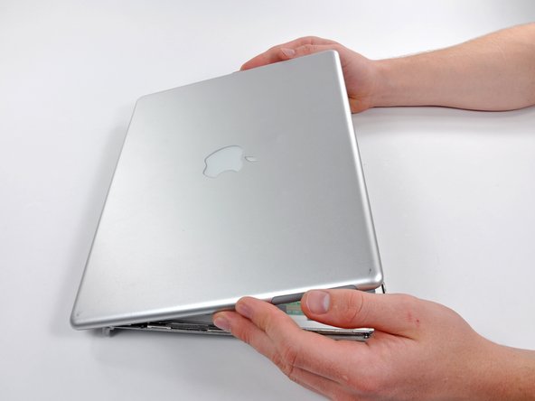

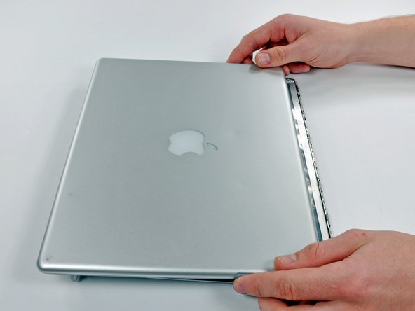

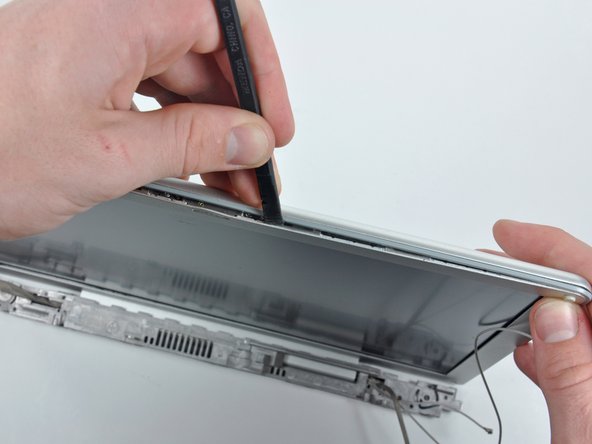

    7. PowerBook G4 Aluminum 12" 1-1.5 GHz Display Data Cable Replacement: crwdns2935265:018crwdnd2935265:01crwdnd2935265:01crwdne2935265:0
      • Starting at one of the upper corners near the screen, work around the frame, separating the upper case from the lower case.
    8. PowerBook G4 Aluminum 12" 1-1.5 GHz Display Data Cable Replacement: crwdns2935265:019crwdnd2935265:01crwdnd2935265:01crwdne2935265:0
      • Using a screw driver, gently release the two grey plastic clips inside the battery compartment in order to remove the right part of the upper case.
      • There are two more grey plastic clips holding the left part of the upper case. They are not easy to release as they are hidden from view prior to disassembly. They are in the same position as the two in the battery compartment, but on the opposite side of the trackpad. Try to stick a flat pry tool into the clip holes and push the clips inward (toward to screen) so they disengage and release the left part of the upper case.
      • Lift the upper case off the computer.

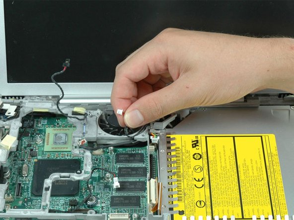

      • Peel up the Bluetooth cable on the right side of the fan.
    4. PowerBook G4 Aluminum 12" 1-1.5 GHz Display Data Cable Replacement: crwdns2935265:023crwdnd2935265:01crwdnd2935265:01crwdne2935265:0
      • Lift up the inverter cable with one hand, and carefully thread it around the heat sink. The inverter cable is still attached to the logic board, so be careful not to put too much strain on the cable.

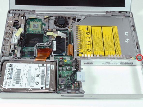

    1. PowerBook G4 Aluminum 12" 1-1.5 GHz Display Data Cable Replacement, Metal Framework: crwdns2935265:025crwdnd2935265:01crwdnd2935265:01crwdne2935265:0

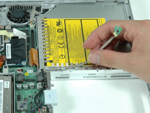

      • Remove the single Phillips screw securing the hall effect sensor board to the optical drive.
    2. PowerBook G4 Aluminum 12" 1-1.5 GHz Display Data Cable Replacement: crwdns2935265:026crwdnd2935265:01crwdnd2935265:01crwdne2935265:0
      • Deroute the cable connecting the hall effect sensor board to the DC-to-DC board.
    3. PowerBook G4 Aluminum 12" 1-1.5 GHz Display Data Cable Replacement: crwdns2935265:027crwdnd2935265:01crwdnd2935265:01crwdne2935265:0
      • Use a spudger or the tip of your finger to disconnect the hall effect sensor cable from the DC-to-DC board.

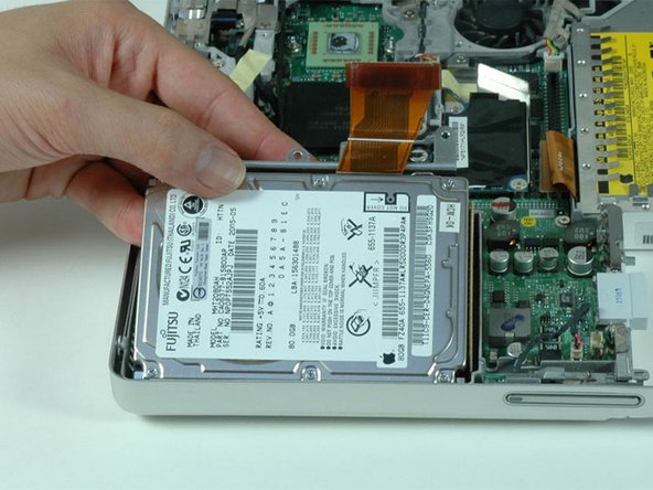

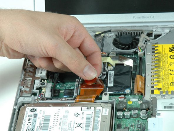

    4. PowerBook G4 Aluminum 12" 1-1.5 GHz Display Data Cable Replacement: crwdns2935265:028crwdnd2935265:01crwdnd2935265:01crwdne2935265:0

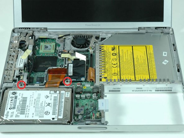

      • Use the orange plastic loop to disconnect the hard drive cable from the logic board.
    5. PowerBook G4 Aluminum 12" 1-1.5 GHz Display Data Cable Replacement: crwdns2935265:029crwdnd2935265:01crwdnd2935265:01crwdne2935265:0
      • Remove the two Phillips screws securing the hard drive bracket to the metal framework.
    6. PowerBook G4 Aluminum 12" 1-1.5 GHz Display Data Cable Replacement: crwdns2935265:030crwdnd2935265:01crwdnd2935265:01crwdne2935265:0
      • Lift the hard drive up and out of the computer.

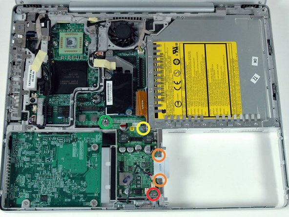

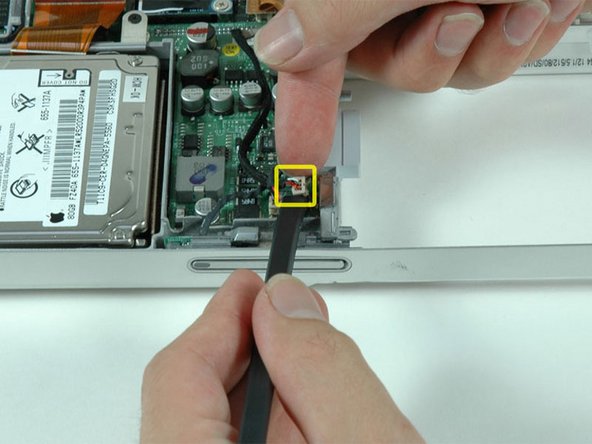

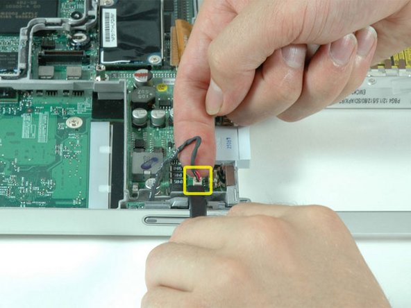

      • Use a spudger or the tip of your finger to disconnect the sleep light cable from the DC-to-DC board.
    8. PowerBook G4 Aluminum 12" 1-1.5 GHz Display Data Cable Replacement: crwdns2935265:032crwdnd2935265:01crwdnd2935265:01crwdne2935265:0
      • Remove the following five secrews/standoffs from the DC-to-DC board:
      • One 3.5 mm Phillips in the lower right corner.
      • Two 3 mm Phillips on either side of the battery contacts.
      • One 10 mm Phillips in the upper right corner.
      • One 14 mm long 4 mm standoff in the upper left corner. You can remove this standoff either with a 4 mm nut driver or needlenose pliers.

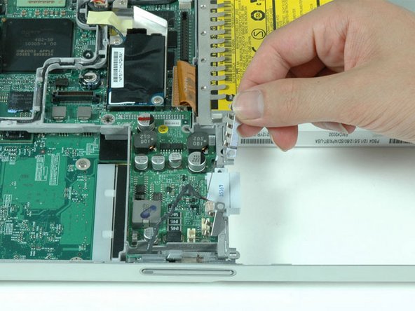

    9. PowerBook G4 Aluminum 12" 1-1.5 GHz Display Data Cable Replacement: crwdns2935265:033crwdnd2935265:01crwdnd2935265:01crwdne2935265:0
      • Remove the silver EMI fingers located near the battery contacts.

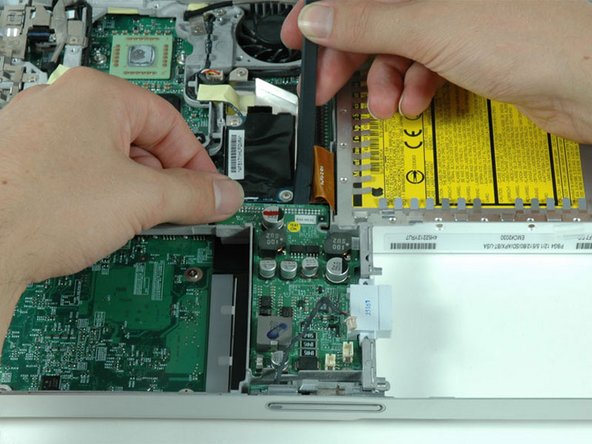

    10. PowerBook G4 Aluminum 12" 1-1.5 GHz Display Data Cable Replacement: crwdns2935265:034crwdnd2935265:01crwdnd2935265:01crwdne2935265:0
      • Use a spudger to pry up the end of the DC-to-DC board closest to the display and remove the board from the computer.

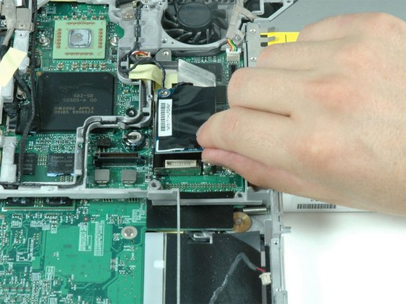

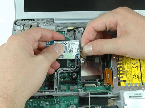

      • Remove the three Phillips screws securing the modem and modem shield to the logic board.
    12. PowerBook G4 Aluminum 12" 1-1.5 GHz Display Data Cable Replacement: crwdns2935265:036crwdnd2935265:01crwdnd2935265:01crwdne2935265:0
      • Disconnect the modem from the logic board by lifting the bottom edge of the modem. Don't remove the modem entirely just yet as it is still connected to the RJ-11 board.
    13. PowerBook G4 Aluminum 12" 1-1.5 GHz Display Data Cable Replacement: crwdns2935265:037crwdnd2935265:01crwdnd2935265:01crwdne2935265:0
      • Turn the modem over and disconnect the RJ-11 cable.

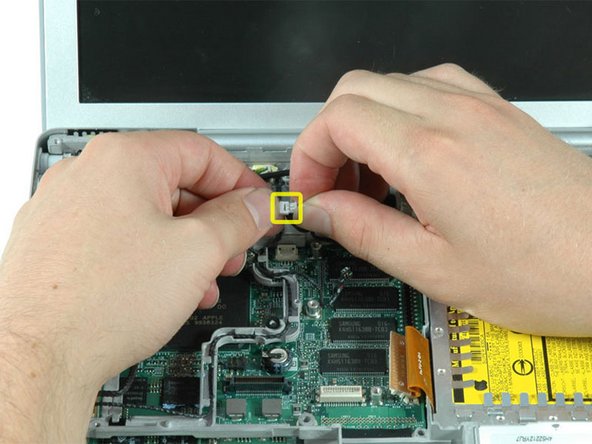

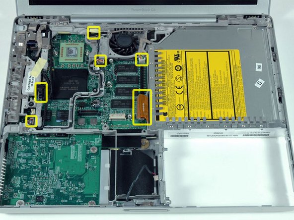

      • The connectors at the ends of the cables are often attached very firmly to the sockets on the logic board. Pulling directly on the cable will either separate the cable from its connector or the socket from the logic board.
      • Carefully disconnect six indicated connectors from the logic board. To disconnect the four white connectors, use your fingernails or a dental pick to carefully pry the connectors from their sockets. Make sure you're pulling only on the connector and not on the socket.

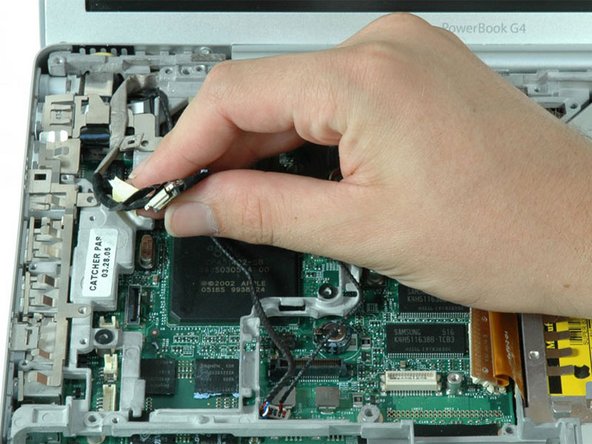

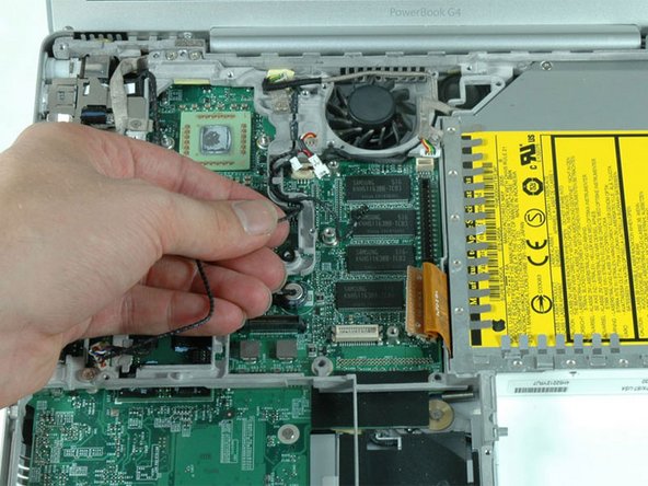

      • Lift up middle speaker cable from the lower left corner of the fan, and disconnect the two sections of the cable.
    16. PowerBook G4 Aluminum 12" 1-1.5 GHz Display Data Cable Replacement: crwdns2935265:040crwdnd2935265:01crwdnd2935265:01crwdne2935265:0
      • Deroute the microphone cable from its channel in the metal framework.

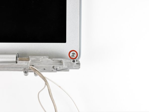

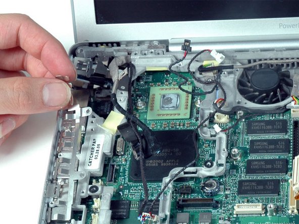

    18. PowerBook G4 Aluminum 12" 1-1.5 GHz Display Data Cable Replacement: crwdns2935265:042crwdnd2935265:01crwdnd2935265:01crwdne2935265:0

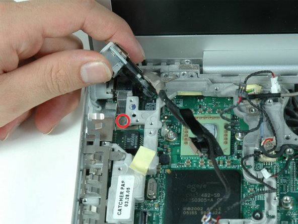

      • Peel up the yellow tape securing the display data cable to the metal framework, and deroute the display data cable from its slot in the framework.
    19. PowerBook G4 Aluminum 12" 1-1.5 GHz Display Data Cable Replacement: crwdns2935265:043crwdnd2935265:01crwdnd2935265:01crwdne2935265:0

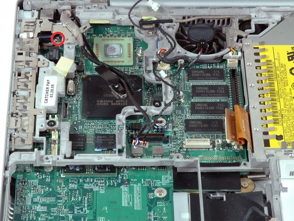

      • Remove the newly revealed Phillips screw near the RJ-11 board.
      • Some computers may have two Phillips screws securing the RJ-11 board to the metal framework.

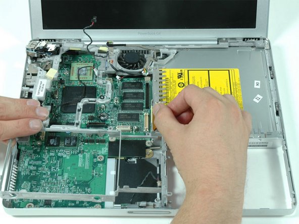

    20. PowerBook G4 Aluminum 12" 1-1.5 GHz Display Data Cable Replacement: crwdns2935265:044crwdnd2935265:01crwdnd2935265:01crwdne2935265:0
      • Lift the RJ-11 board up from the left side, and remove the single Phillips screw hidden beneath.
      • You may have to remove the metal shield above the RJ-11 board before you can lift it up.
    21. PowerBook G4 Aluminum 12" 1-1.5 GHz Display Data Cable Replacement: crwdns2935265:045crwdnd2935265:01crwdnd2935265:01crwdne2935265:0
      • Lift up and remove the silver EMI fingers located above the ports on the left side of the computer.
    22. PowerBook G4 Aluminum 12" 1-1.5 GHz Display Data Cable Replacement: crwdns2935265:046crwdnd2935265:01crwdnd2935265:01crwdne2935265:0
      • Pull back on the orange optical drive cable with one hand, and use your other hand to lift the front section of the metal framework over the optical drive cable.
    23. PowerBook G4 Aluminum 12" 1-1.5 GHz Display Data Cable Replacement: crwdns2935265:047crwdnd2935265:01crwdnd2935265:01crwdne2935265:0

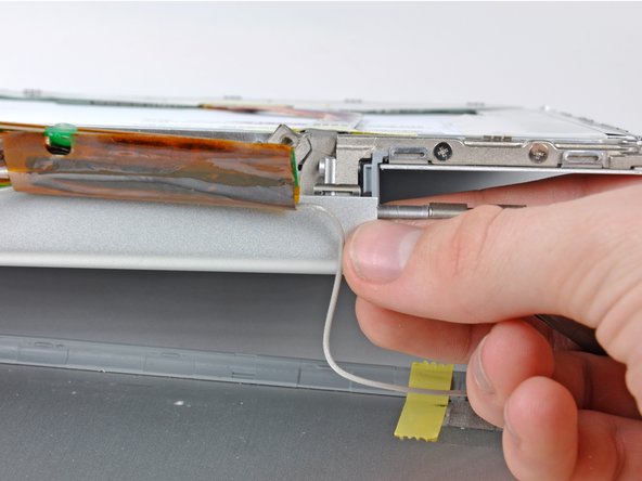

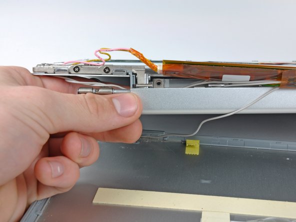

      • Deroute the microphone cable from its channel in the upper right corner of the framework.
      • The metal framework should now be free can be removed from the computer. Be careful when removing the metal framework that none of the cables get caught on the framework.
      • When reassembling the laptop, make sure that two wires come through the loop of metal on the frame on the upper right-hand side - a silver wire at right angles and the skinny black microphone channel. The third wire from underneath the frame is routed over the fan. The fourth wire from this corner is directly attached to the frame.

      • Remove the two Phillips screws from the bottom right of the logic board.
      • When reassembling, take note of the plastic piece immediately to the right of the screws. Make sure you do not neglect to put it in place before screwing down the logic board.
    2. PowerBook G4 Aluminum 12" 1-1.5 GHz Display Data Cable Replacement: crwdns2935265:049crwdnd2935265:01crwdnd2935265:01crwdne2935265:0
      • Do not lift the logic board out completely without first disconnecting the DC-In connector underneath the logic board.
      • Lift the logic board partly up from the optical side.
    3. PowerBook G4 Aluminum 12" 1-1.5 GHz Display Data Cable Replacement: crwdns2935265:050crwdnd2935265:01crwdnd2935265:01crwdne2935265:0
      • Disconnect the DC-In connector from the underside of the logic board.
    1. PowerBook G4 Aluminum 12" 1-1.5 GHz Display Data Cable Replacement, Optical Drive: crwdns2935265:051crwdnd2935265:01crwdnd2935265:01crwdne2935265:0
      • Remove the two 6mm Phillips screws from the upper right corner of the computer.
      • Remove the newly-liberated small metal bracket.
    2. PowerBook G4 Aluminum 12" 1-1.5 GHz Display Data Cable Replacement: crwdns2935265:052crwdnd2935265:01crwdnd2935265:01crwdne2935265:0
      • Remove the two recessed Phillips screws on the right side of the optical drive.
    3. PowerBook G4 Aluminum 12" 1-1.5 GHz Display Data Cable Replacement: crwdns2935265:053crwdnd2935265:01crwdnd2935265:01crwdne2935265:0
      • Lift the optical drive up by its front left corner and pull it out of the computer.
      • If you have a CD or any other object jammed in your optical drive, we have an optical drive repair guide.
    1. PowerBook G4 Aluminum 12" 1-1.5 GHz Display Data Cable Replacement, Bluetooth: crwdns2935265:054crwdnd2935265:01crwdnd2935265:01crwdne2935265:0
      • Disconnect the multicolor connector by sliding it to the left.
    2. PowerBook G4 Aluminum 12" 1-1.5 GHz Display Data Cable Replacement: crwdns2935265:055crwdnd2935265:01crwdnd2935265:01crwdne2935265:0
      • Disconnect the silver bluetooth cable by pulling directly up.
    3. PowerBook G4 Aluminum 12" 1-1.5 GHz Display Data Cable Replacement: crwdns2935265:056crwdnd2935265:01crwdnd2935265:01crwdne2935265:0
      • Remove the single Phillips screw from the right side of the board.
      • Lift the bluetooth board out of the computer.

    1. PowerBook G4 Aluminum 12" 1-1.5 GHz Display Data Cable Replacement, Display: crwdns2935265:059crwdnd2935265:01crwdnd2935265:01crwdne2935265:0
      • Deroute the Airport Extreme antenna from the card slot and lower case, removing tape as necessary.
    2. PowerBook G4 Aluminum 12" 1-1.5 GHz Display Data Cable Replacement: crwdns2935265:060crwdnd2935265:01crwdnd2935265:01crwdne2935265:0
      • Place a cloth between the screen and the bottom case.
      • Close the bottom case and turn the laptop over.
      • Remove the two Phillips screws from the bottom case.
    3. PowerBook G4 Aluminum 12" 1-1.5 GHz Display Data Cable Replacement: crwdns2935265:061crwdnd2935265:01crwdnd2935265:01crwdne2935265:0

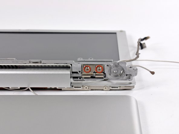

      • Remove the two Phillips screws from either side of the display hinge.
    4. PowerBook G4 Aluminum 12" 1-1.5 GHz Display Data Cable Replacement: crwdns2935265:062crwdnd2935265:01crwdnd2935265:01crwdne2935265:0
      • Grasp the lower case and push down on the hinge side while rotating the other end of the case toward you until it pops free, then remove it entirely (leaving the display).
      • You have effectively removed the computer from the display.

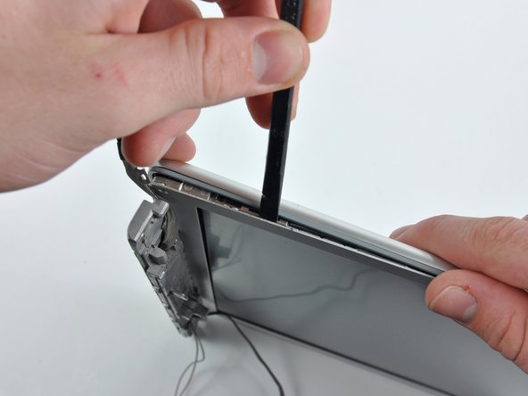

      • Insert the spudger between the left edge of the front display bezel and the plastic strip attached to the rear bezel, with the edge of the tool angled toward the LCD.
      • Rotate the tool away from the LCD to pop the rear bezel off the tabs on the front display bezel.
      • Work along the left edge of the display until the rear bezel is evenly separated from the front bezel.
    3. PowerBook G4 Aluminum 12" 1-1.5 GHz Display Data Cable Replacement: crwdns2935265:065crwdnd2935265:01crwdnd2935265:02crwdne2935265:0 PowerBook G4 Aluminum 12" 1-1.5 GHz Display Data Cable Replacement: crwdns2935265:065crwdnd2935265:02crwdnd2935265:02crwdne2935265:0

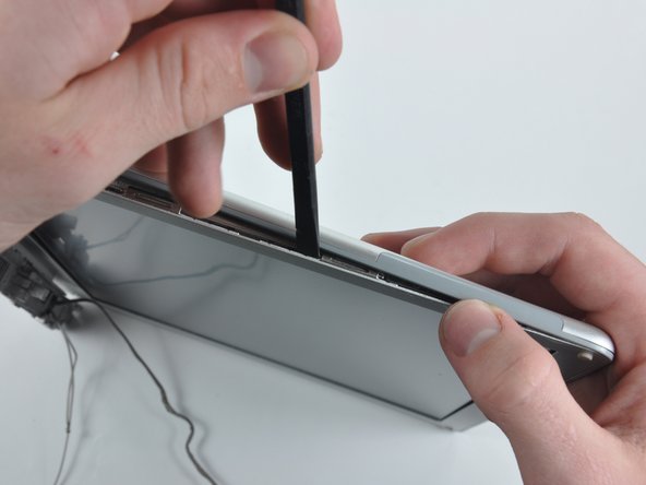

      • Insert a spudger between the right edge of the front display bezel and the plastic strip attached to the rear bezel, with the edge of the tool angled toward the LCD.
      • Work along the right edge of the display until the rear bezel is evenly separated from the front bezel.
