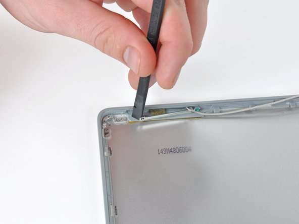

  25. PowerBook G4 Aluminum 12" 1-1.5 GHz Antenna Board and Cables Replacement, Metal Framework: crwdns2935265:025crwdnd2935265:01crwdnd2935265:01crwdne2935265:0
    • Remove the single Phillips screw securing the hall effect sensor board to the optical drive.
  26. PowerBook G4 Aluminum 12" 1-1.5 GHz Antenna Board and Cables Replacement: crwdns2935265:026crwdnd2935265:01crwdnd2935265:01crwdne2935265:0
    • Deroute the cable connecting the hall effect sensor board to the DC-to-DC board.
  27. PowerBook G4 Aluminum 12" 1-1.5 GHz Antenna Board and Cables Replacement: crwdns2935265:027crwdnd2935265:01crwdnd2935265:01crwdne2935265:0
    • Use a spudger or the tip of your finger to disconnect the hall effect sensor cable from the DC-to-DC board.
  28. PowerBook G4 Aluminum 12" 1-1.5 GHz Antenna Board and Cables Replacement: crwdns2935265:028crwdnd2935265:01crwdnd2935265:01crwdne2935265:0
    • Use the orange plastic loop to disconnect the hard drive cable from the logic board.
  29. PowerBook G4 Aluminum 12" 1-1.5 GHz Antenna Board and Cables Replacement: crwdns2935265:029crwdnd2935265:01crwdnd2935265:01crwdne2935265:0
    • Remove the two Phillips screws securing the hard drive bracket to the metal framework.
  30. PowerBook G4 Aluminum 12" 1-1.5 GHz Antenna Board and Cables Replacement: crwdns2935265:030crwdnd2935265:01crwdnd2935265:01crwdne2935265:0
    • Lift the hard drive up and out of the computer.
  31. PowerBook G4 Aluminum 12" 1-1.5 GHz Antenna Board and Cables Replacement: crwdns2935265:031crwdnd2935265:01crwdnd2935265:01crwdne2935265:0
    • Use a spudger or the tip of your finger to disconnect the sleep light cable from the DC-to-DC board.
  32. PowerBook G4 Aluminum 12" 1-1.5 GHz Antenna Board and Cables Replacement: crwdns2935265:032crwdnd2935265:01crwdnd2935265:01crwdne2935265:0
    • Remove the following five secrews/standoffs from the DC-to-DC board:
    • One 3.5 mm Phillips in the lower right corner.
    • Two 3 mm Phillips on either side of the battery contacts.
    • One 10 mm Phillips in the upper right corner.
    • One 14 mm long 4 mm standoff in the upper left corner. You can remove this standoff either with a 4 mm nut driver or needlenose pliers.
  33. PowerBook G4 Aluminum 12" 1-1.5 GHz Antenna Board and Cables Replacement: crwdns2935265:033crwdnd2935265:01crwdnd2935265:01crwdne2935265:0
    • Remove the silver EMI fingers located near the battery contacts.
  34. PowerBook G4 Aluminum 12" 1-1.5 GHz Antenna Board and Cables Replacement: crwdns2935265:034crwdnd2935265:01crwdnd2935265:01crwdne2935265:0
    • Use a spudger to pry up the end of the DC-to-DC board closest to the display and remove the board from the computer.
  35. PowerBook G4 Aluminum 12" 1-1.5 GHz Antenna Board and Cables Replacement: crwdns2935265:035crwdnd2935265:01crwdnd2935265:01crwdne2935265:0
    • Remove the three Phillips screws securing the modem and modem shield to the logic board.
  36. PowerBook G4 Aluminum 12" 1-1.5 GHz Antenna Board and Cables Replacement: crwdns2935265:036crwdnd2935265:01crwdnd2935265:01crwdne2935265:0
    • Disconnect the modem from the logic board by lifting the bottom edge of the modem. Don't remove the modem entirely just yet as it is still connected to the RJ-11 board.
  37. PowerBook G4 Aluminum 12" 1-1.5 GHz Antenna Board and Cables Replacement: crwdns2935265:037crwdnd2935265:01crwdnd2935265:01crwdne2935265:0
    • Turn the modem over and disconnect the RJ-11 cable.
  38. PowerBook G4 Aluminum 12" 1-1.5 GHz Antenna Board and Cables Replacement: crwdns2935265:038crwdnd2935265:01crwdnd2935265:01crwdne2935265:0
    • The connectors at the ends of the cables are often attached very firmly to the sockets on the logic board. Pulling directly on the cable will either separate the cable from its connector or the socket from the logic board.
    • Carefully disconnect six indicated connectors from the logic board. To disconnect the four white connectors, use your fingernails or a dental pick to carefully pry the connectors from their sockets. Make sure you're pulling only on the connector and not on the socket.
  39. PowerBook G4 Aluminum 12" 1-1.5 GHz Antenna Board and Cables Replacement: crwdns2935265:039crwdnd2935265:01crwdnd2935265:01crwdne2935265:0
    • Lift up middle speaker cable from the lower left corner of the fan, and disconnect the two sections of the cable.
  40. PowerBook G4 Aluminum 12" 1-1.5 GHz Antenna Board and Cables Replacement: crwdns2935265:040crwdnd2935265:01crwdnd2935265:01crwdne2935265:0
    • Deroute the microphone cable from its channel in the metal framework.
  41. PowerBook G4 Aluminum 12" 1-1.5 GHz Antenna Board and Cables Replacement: crwdns2935265:041crwdnd2935265:01crwdnd2935265:01crwdne2935265:0
    • Remove the following nine screws:
    • Four 3 mm Phillips allong the left edge and near the fan.
    • One 4 mm Phillips in the bottom left corner.
    • Two 6 mm Phillips near the left hinge.
    • One 9 mm Phillips in the top left corner of the fan.
    • One 12 mm Phillips just above where the hard drive was located.
  42. PowerBook G4 Aluminum 12" 1-1.5 GHz Antenna Board and Cables Replacement: crwdns2935265:042crwdnd2935265:01crwdnd2935265:01crwdne2935265:0
    • Peel up the yellow tape securing the display data cable to the metal framework, and deroute the display data cable from its slot in the framework.
  43. PowerBook G4 Aluminum 12" 1-1.5 GHz Antenna Board and Cables Replacement: crwdns2935265:043crwdnd2935265:01crwdnd2935265:01crwdne2935265:0
    • Remove the newly revealed Phillips screw near the RJ-11 board.
    • Some computers may have two Phillips screws securing the RJ-11 board to the metal framework.
  44. PowerBook G4 Aluminum 12" 1-1.5 GHz Antenna Board and Cables Replacement: crwdns2935265:044crwdnd2935265:01crwdnd2935265:01crwdne2935265:0
    • Lift the RJ-11 board up from the left side, and remove the single Phillips screw hidden beneath.
    • You may have to remove the metal shield above the RJ-11 board before you can lift it up.
  45. PowerBook G4 Aluminum 12" 1-1.5 GHz Antenna Board and Cables Replacement: crwdns2935265:045crwdnd2935265:01crwdnd2935265:01crwdne2935265:0
    • Lift up and remove the silver EMI fingers located above the ports on the left side of the computer.
  46. PowerBook G4 Aluminum 12" 1-1.5 GHz Antenna Board and Cables Replacement: crwdns2935265:046crwdnd2935265:01crwdnd2935265:01crwdne2935265:0
    • Pull back on the orange optical drive cable with one hand, and use your other hand to lift the front section of the metal framework over the optical drive cable.
  47. PowerBook G4 Aluminum 12" 1-1.5 GHz Antenna Board and Cables Replacement: crwdns2935265:047crwdnd2935265:01crwdnd2935265:01crwdne2935265:0
    • Deroute the microphone cable from its channel in the upper right corner of the framework.
    • The metal framework should now be free can be removed from the computer. Be careful when removing the metal framework that none of the cables get caught on the framework.
    • When reassembling the laptop, make sure that two wires come through the loop of metal on the frame on the upper right-hand side - a silver wire at right angles and the skinny black microphone channel. The third wire from underneath the frame is routed over the fan. The fourth wire from this corner is directly attached to the frame.

  78. PowerBook G4 Aluminum 12" 1-1.5 GHz Antenna Board and Cables Replacement: crwdns2935265:078crwdnd2935265:01crwdnd2935265:02crwdne2935265:0 PowerBook G4 Aluminum 12" 1-1.5 GHz Antenna Board and Cables Replacement: crwdns2935265:078crwdnd2935265:02crwdnd2935265:02crwdne2935265:0
    • The antenna is attached to the rear display bezel via adhesive. To remove it, place the flat end of a spudger behind the top edge of the antenna, and carefully twist the spudger to pop the antenna off.
  79. PowerBook G4 Aluminum 12" 1-1.5 GHz Antenna Board and Cables Replacement: crwdns2935265:079crwdnd2935265:01crwdnd2935265:01crwdne2935265:0
    • Place the pointed end of the spudger behind the lower part of the antenna and carefully rotate the spudger to free the antenna from the rear display bezel.
  80. PowerBook G4 Aluminum 12" 1-1.5 GHz Antenna Board and Cables Replacement: crwdns2935265:080crwdnd2935265:01crwdnd2935265:01crwdne2935265:0
