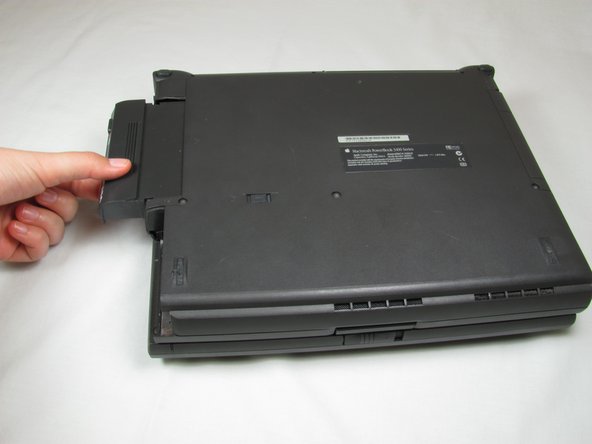

    • Close the screen and turn the PowerBook over, orienting the computer upside down, using the label to guide you.
  2. PowerBook 3400 M3553 Floppy Disk Drive Replacement: crwdns2935265:02crwdnd2935265:01crwdnd2935265:02crwdne2935265:0 PowerBook 3400 M3553 Floppy Disk Drive Replacement: crwdns2935265:02crwdnd2935265:02crwdnd2935265:02crwdne2935265:0
    • Hold the button on the front left side and slide the battery out.
  3. PowerBook 3400 M3553 Floppy Disk Drive Replacement, Floppy Disk Drive: crwdns2935265:03crwdnd2935265:01crwdnd2935265:02crwdne2935265:0 PowerBook 3400 M3553 Floppy Disk Drive Replacement, Floppy Disk Drive: crwdns2935265:03crwdnd2935265:02crwdnd2935265:02crwdne2935265:0
    • First, slide the switch on the back of the computer to the left.
    • Then pull the floppy drive out of the computer.
