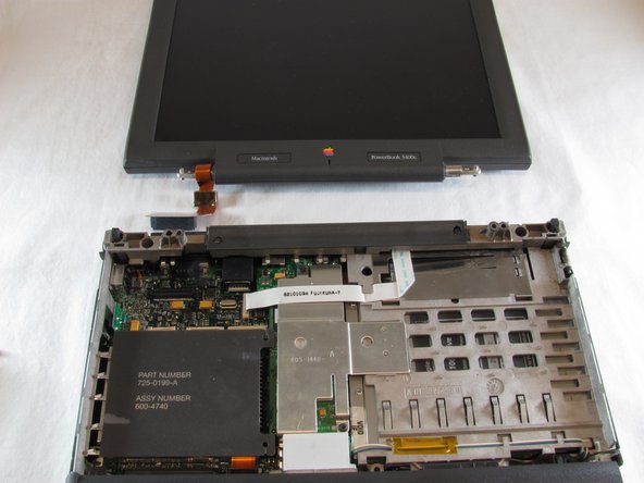

  11. PowerBook 3400 M3553 Display Replacement, Display: crwdns2935265:011crwdnd2935265:01crwdnd2935265:01crwdne2935265:0
    • Remove the panels on either side by gently but firmly pulling up on them with both hands.
  12. PowerBook 3400 M3553 Display Replacement: crwdns2935265:012crwdnd2935265:01crwdnd2935265:02crwdne2935265:0 PowerBook 3400 M3553 Display Replacement: crwdns2935265:012crwdnd2935265:02crwdnd2935265:02crwdne2935265:0

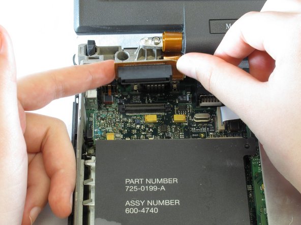

    • Gently pull up on the ribbon cable connection that connects the screen to the logic board.
  13. PowerBook 3400 M3553 Display Replacement: crwdns2935265:013crwdnd2935265:01crwdnd2935265:02crwdne2935265:0 PowerBook 3400 M3553 Display Replacement: crwdns2935265:013crwdnd2935265:02crwdnd2935265:02crwdne2935265:0
    • The two T8 13 mm torx screws hold the display screen in place. Be sure to remove the screws while supporting the screen or else it will fall.
    • Remove the two T8 13 mm long torx screws on either side of the display, located under the side panels.
    • Gently pull the display free of the computer.
To replace the display, follow these instructions in reverse order.
