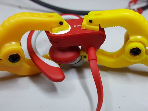

  5. PowerBeats2 Wireless Headphones by Dr. Dre Battery Replacement, Reattach Battery Cover/Casing: crwdns2935265:05crwdnd2935265:01crwdnd2935265:02crwdne2935265:0 PowerBeats2 Wireless Headphones by Dr. Dre Battery Replacement, Reattach Battery Cover/Casing: crwdns2935265:05crwdnd2935265:02crwdnd2935265:02crwdne2935265:0
    • After battery is replaced, apply super glue to the border of the inside of the battery cover/casing and put it back in place.
    • Use small clamps/binder clip to hold the housing in place while the super glue dries up.
