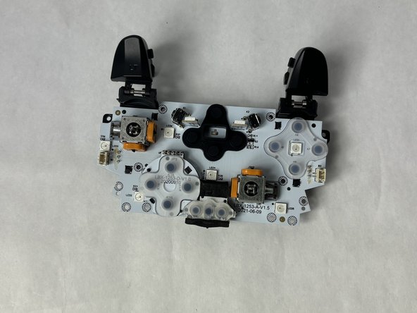

  4. PowerA Spectra Infinity Enhanced Vibration Motors Replacement: crwdns2935265:04crwdnd2935265:01crwdnd2935265:01crwdne2935265:0
    • Remove the two 10 mm screws connecting the motherboard to the faceplate using a Phillips #0 screwdriver.
  5. PowerA Spectra Infinity Enhanced Vibration Motors Replacement: crwdns2935265:05crwdnd2935265:01crwdnd2935265:02crwdne2935265:0 PowerA Spectra Infinity Enhanced Vibration Motors Replacement: crwdns2935265:05crwdnd2935265:02crwdnd2935265:02crwdne2935265:0
    • Use your hand to separate the motherboard from the face plate.

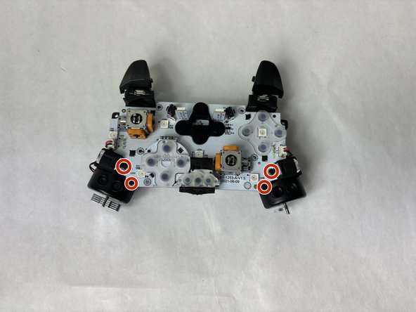

  6. PowerA Spectra Infinity Enhanced Vibration Motors Replacement, Vibration Motors: crwdns2935265:06crwdnd2935265:01crwdnd2935265:02crwdne2935265:0 PowerA Spectra Infinity Enhanced Vibration Motors Replacement, Vibration Motors: crwdns2935265:06crwdnd2935265:02crwdnd2935265:02crwdne2935265:0
    • Remove the four 7.9 mm screws using a Phillips #0 screwdriver.

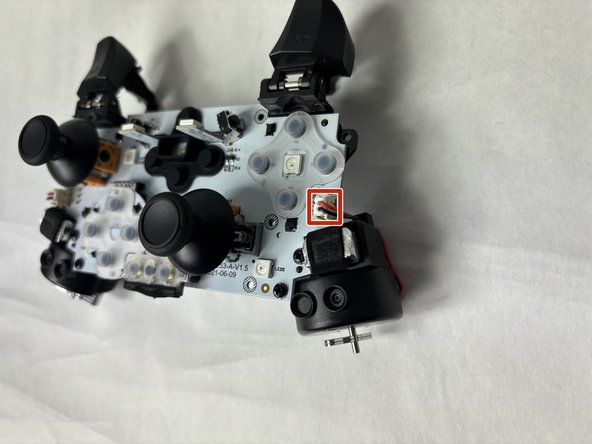

  7. PowerA Spectra Infinity Enhanced Vibration Motors Replacement: crwdns2935265:07crwdnd2935265:01crwdnd2935265:02crwdne2935265:0 PowerA Spectra Infinity Enhanced Vibration Motors Replacement: crwdns2935265:07crwdnd2935265:02crwdnd2935265:02crwdne2935265:0
    • Use tweezers to unplug the small plug connecting the motors to the motherboard.
    • A firm grip may be necessary for this step.

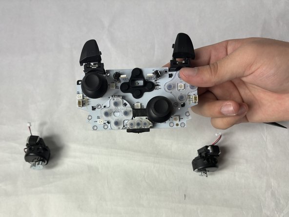

  8. PowerA Spectra Infinity Enhanced Vibration Motors Replacement: crwdns2935265:08crwdnd2935265:01crwdnd2935265:03crwdne2935265:0 PowerA Spectra Infinity Enhanced Vibration Motors Replacement: crwdns2935265:08crwdnd2935265:02crwdnd2935265:03crwdne2935265:0 PowerA Spectra Infinity Enhanced Vibration Motors Replacement: crwdns2935265:08crwdnd2935265:03crwdnd2935265:03crwdne2935265:0
    • Remove the completely freed vibration motor from the motherboard.
