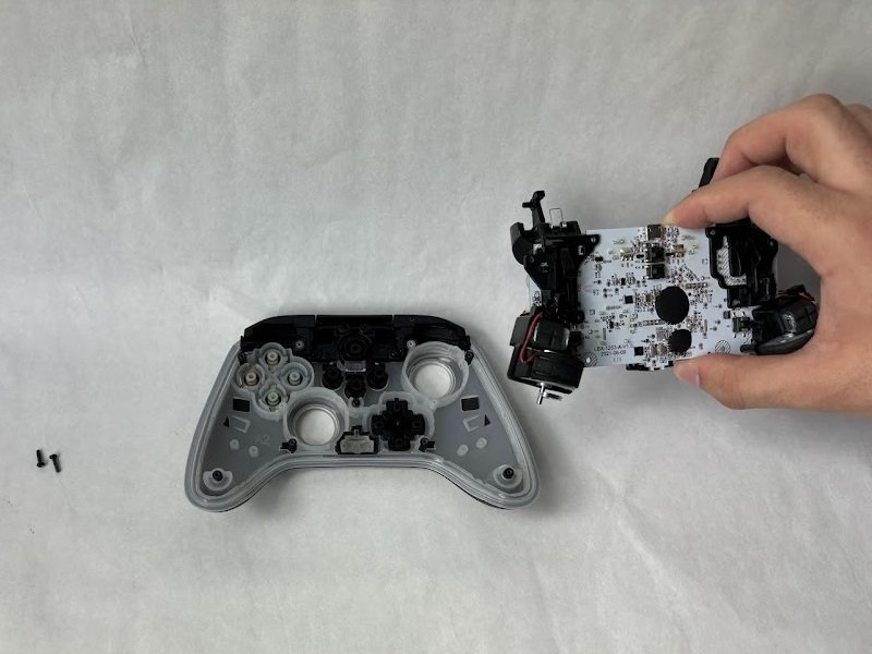

If your PowerA Spectra Infinity Enhanced (model number 1522360-01) isn't producing clear audio or no audio at all and/or your triggers are not taking inputs, use this guide to replace the motherboard.
You may need to replace the motherboard if you have broken triggers or audio port since they are soldered onto the motherboard. Please ensure that the controller is unplugged before disassembling.
    1. PowerA Spectra Infinity Enhanced Motherboard Replacement, Motherboard: crwdns2935265:01crwdnd2935265:01crwdnd2935265:02crwdne2935265:0 PowerA Spectra Infinity Enhanced Motherboard Replacement, Motherboard: crwdns2935265:01crwdnd2935265:02crwdnd2935265:02crwdne2935265:0
      • Flip the controller so the back is facing up.
    2. PowerA Spectra Infinity Enhanced Motherboard Replacement: crwdns2935265:02crwdnd2935265:01crwdnd2935265:01crwdne2935265:0
      • Remove the eight 10 mm screws from the back of the controller using a Phillips #0 screwdriver.
    3. PowerA Spectra Infinity Enhanced Motherboard Replacement: crwdns2935265:03crwdnd2935265:01crwdnd2935265:02crwdne2935265:0 PowerA Spectra Infinity Enhanced Motherboard Replacement: crwdns2935265:03crwdnd2935265:02crwdnd2935265:02crwdne2935265:0
      • Unlock the trigger locks before removing the backplate.
      • This will make taking the plate off easier.
      • Use your fingers and carefully remove the backplate.
    4. PowerA Spectra Infinity Enhanced Motherboard Replacement: crwdns2935265:04crwdnd2935265:01crwdnd2935265:01crwdne2935265:0
      • Remove the two 10 mm screws connecting the motherboard to the faceplate using a Phillips #0 screwdriver.
    5. PowerA Spectra Infinity Enhanced Motherboard Replacement: crwdns2935265:05crwdnd2935265:01crwdnd2935265:02crwdne2935265:0 PowerA Spectra Infinity Enhanced Motherboard Replacement: crwdns2935265:05crwdnd2935265:02crwdnd2935265:02crwdne2935265:0
      • Use your hand to separate the motherboard from the face plate.
