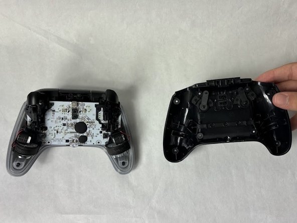

      • Flip the controller so the back is facing up.
    2. PowerA Spectra Infinity Enhanced Joysticks Replacement: crwdns2935265:02crwdnd2935265:01crwdnd2935265:01crwdne2935265:0
      • Remove the eight 10 mm screws from the back of the controller using a Phillips #0 screwdriver.
    3. PowerA Spectra Infinity Enhanced Joysticks Replacement: crwdns2935265:03crwdnd2935265:01crwdnd2935265:02crwdne2935265:0 PowerA Spectra Infinity Enhanced Joysticks Replacement: crwdns2935265:03crwdnd2935265:02crwdnd2935265:02crwdne2935265:0
      • Unlock the trigger locks before removing the backplate.
      • This will make taking the plate off easier.
      • Use your fingers and carefully remove the backplate.
    4. PowerA Spectra Infinity Enhanced Joysticks Replacement: crwdns2935265:04crwdnd2935265:01crwdnd2935265:01crwdne2935265:0

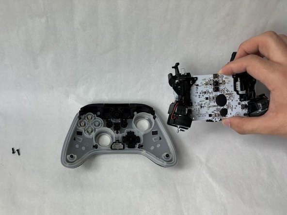

      • Remove the two 10 mm screws connecting the motherboard to the faceplate using a Phillips #0 screwdriver.
    5. PowerA Spectra Infinity Enhanced Joysticks Replacement: crwdns2935265:05crwdnd2935265:01crwdnd2935265:02crwdne2935265:0 PowerA Spectra Infinity Enhanced Joysticks Replacement: crwdns2935265:05crwdnd2935265:02crwdnd2935265:02crwdne2935265:0
      • Use your hand to separate the motherboard from the face plate.

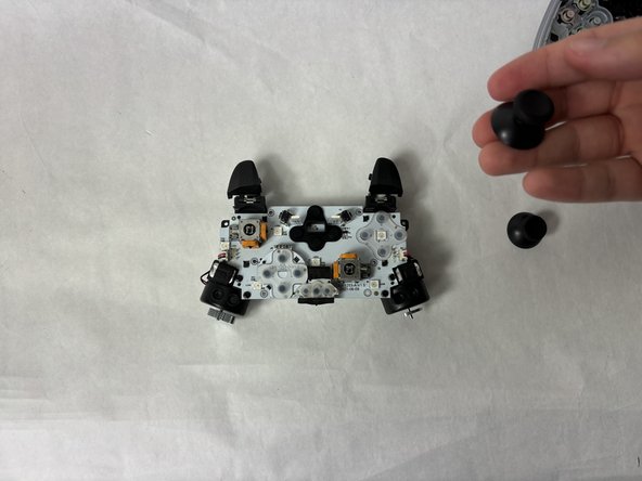

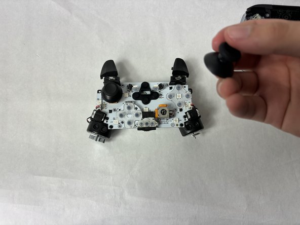

    1. PowerA Spectra Infinity Enhanced Joysticks Replacement, Joysticks: crwdns2935265:06crwdnd2935265:01crwdnd2935265:01crwdne2935265:0
      • Take the motherboard and place it with the joysticks facing upward.
    2. PowerA Spectra Infinity Enhanced Joysticks Replacement: crwdns2935265:07crwdnd2935265:01crwdnd2935265:03crwdne2935265:0 PowerA Spectra Infinity Enhanced Joysticks Replacement: crwdns2935265:07crwdnd2935265:02crwdnd2935265:03crwdne2935265:0 PowerA Spectra Infinity Enhanced Joysticks Replacement: crwdns2935265:07crwdnd2935265:03crwdnd2935265:03crwdne2935265:0
      • Use your hand to carefully remove the joysticks from the motherboard.
