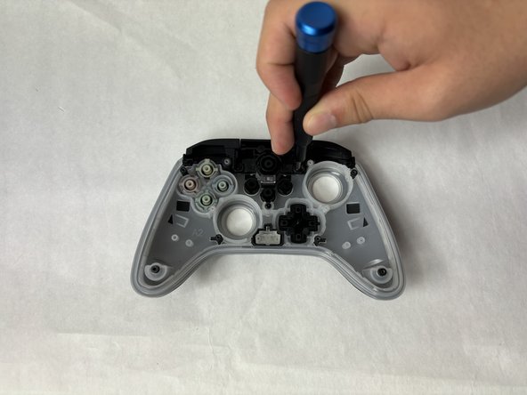

  7. PowerA Spectra Infinity Enhanced Faceplate Replacement: crwdns2935265:07crwdnd2935265:01crwdnd2935265:01crwdne2935265:0
    • Remove two 10 mm screws holding the bumper to the faceplate using a Phillips #0 screwdriver.
  8. PowerA Spectra Infinity Enhanced Faceplate Replacement: crwdns2935265:08crwdnd2935265:01crwdnd2935265:02crwdne2935265:0 PowerA Spectra Infinity Enhanced Faceplate Replacement: crwdns2935265:08crwdnd2935265:02crwdnd2935265:02crwdne2935265:0
    • Remove the single 7.9 mm screw holding the bumpers to the faceplate using a Phillips #0 screwdriver.
  9. PowerA Spectra Infinity Enhanced Faceplate Replacement: crwdns2935265:09crwdnd2935265:01crwdnd2935265:01crwdne2935265:0
    • Use your hand to separate the faceplate from the bumpers.
