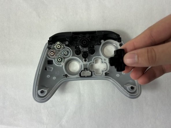

If your PowerA Spectra Infinity Enhanced (model number 1522360-01) D-pad is unresponsive, use this guide to replace the D-pad.
You may also want to replace your D-pad with a different customized D-pad in which case you can also use this guide to do! Please ensure that the controller is not plugged in while disassembling it.
    1. PowerA Spectra Infinity Enhanced D-pad Replacement, Motherboard: crwdns2935265:01crwdnd2935265:01crwdnd2935265:02crwdne2935265:0 PowerA Spectra Infinity Enhanced D-pad Replacement, Motherboard: crwdns2935265:01crwdnd2935265:02crwdnd2935265:02crwdne2935265:0
      • Flip the controller so the back is facing up.
    2. PowerA Spectra Infinity Enhanced D-pad Replacement: crwdns2935265:02crwdnd2935265:01crwdnd2935265:01crwdne2935265:0
      • Remove the eight 10 mm screws from the back of the controller using a Phillips #0 screwdriver.
    3. PowerA Spectra Infinity Enhanced D-pad Replacement: crwdns2935265:03crwdnd2935265:01crwdnd2935265:02crwdne2935265:0 PowerA Spectra Infinity Enhanced D-pad Replacement: crwdns2935265:03crwdnd2935265:02crwdnd2935265:02crwdne2935265:0
      • Unlock the trigger locks before removing the backplate.
      • This will make taking the plate off easier.
      • Use your fingers and carefully remove the backplate.
    4. PowerA Spectra Infinity Enhanced D-pad Replacement: crwdns2935265:04crwdnd2935265:01crwdnd2935265:01crwdne2935265:0
      • Remove the two 10 mm screws connecting the motherboard to the faceplate using a Phillips #0 screwdriver.
    5. PowerA Spectra Infinity Enhanced D-pad Replacement: crwdns2935265:05crwdnd2935265:01crwdnd2935265:02crwdne2935265:0 PowerA Spectra Infinity Enhanced D-pad Replacement: crwdns2935265:05crwdnd2935265:02crwdnd2935265:02crwdne2935265:0
      • Use your hand to separate the motherboard from the face plate.
    1. PowerA Spectra Infinity Enhanced D-pad Replacement, D-pad: crwdns2935265:06crwdnd2935265:01crwdnd2935265:02crwdne2935265:0 PowerA Spectra Infinity Enhanced D-pad Replacement, D-pad: crwdns2935265:06crwdnd2935265:02crwdnd2935265:02crwdne2935265:0
      • Remove the D-pad.
      • The buttons will fall out easily if you flip the faceplate over. You can raise the faceplate off the surface and push the D-Pad out from underneath.
