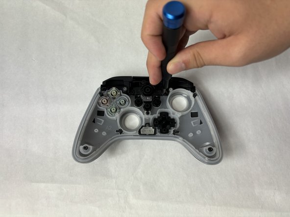

    1. PowerA Spectra Infinity Enhanced Bumpers Replacement, Bumpers: crwdns2935265:06crwdnd2935265:01crwdnd2935265:01crwdne2935265:0
      • Remove two 10 mm screws holding the bumper to the faceplate using a Phillips #0 screwdriver.
    2. PowerA Spectra Infinity Enhanced Bumpers Replacement: crwdns2935265:07crwdnd2935265:01crwdnd2935265:02crwdne2935265:0 PowerA Spectra Infinity Enhanced Bumpers Replacement: crwdns2935265:07crwdnd2935265:02crwdnd2935265:02crwdne2935265:0
      • Remove the single 7.9 mm screw holding the bumpers to the faceplate using a Phillips #0 screwdriver.
    3. PowerA Spectra Infinity Enhanced Bumpers Replacement: crwdns2935265:08crwdnd2935265:01crwdnd2935265:01crwdne2935265:0
      • Remove the freed bumpers from the faceplate.
