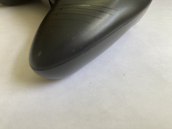

  1. PowerA Moga Rebel MFI iPhone controller Teardown, Turn Off Controller: crwdns2935265:01crwdnd2935265:01crwdnd2935265:02crwdne2935265:0 PowerA Moga Rebel MFI iPhone controller Teardown, Turn Off Controller: crwdns2935265:01crwdnd2935265:02crwdnd2935265:02crwdne2935265:0
    • Lift the phone mount from the bottom. It swivels on a hinge at the top of the controller.
    • Turn the switch to the left "OFF" position, so that red is showing.

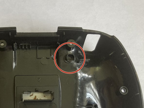

  3. PowerA Moga Rebel MFI iPhone controller Teardown, Lift Back Case: crwdns2935265:03crwdnd2935265:01crwdnd2935265:03crwdne2935265:0 PowerA Moga Rebel MFI iPhone controller Teardown, Lift Back Case: crwdns2935265:03crwdnd2935265:02crwdnd2935265:03crwdne2935265:0 PowerA Moga Rebel MFI iPhone controller Teardown, Lift Back Case: crwdns2935265:03crwdnd2935265:03crwdnd2935265:03crwdne2935265:0
    • Make sure the phone mounting arm is up, and then separate the back cover along the visible seem.
    • The triggers (L2 and R2) can be pushed in to help lift the back case.
    • No cables or other internal parts are attached to the back, but the reset button may fall out when lifting it.
    • The third image and red circle show where the reset button goes from the inside of the controller.
