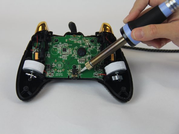

  3. PowerA Fusion Controller For Xbox One Headphone Jack Replacement: crwdns2935265:03crwdnd2935265:01crwdnd2935265:02crwdne2935265:0 PowerA Fusion Controller For Xbox One Headphone Jack Replacement: crwdns2935265:03crwdnd2935265:02crwdnd2935265:02crwdne2935265:0
    • Desolder the soldered joints that are connecting the headphone jack to the motherboard (Circled in red).
    • This guide will show you how to solder and desolder connections.
    • Remove the headphone jack and put it aside.
