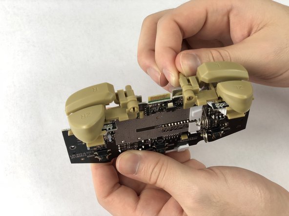

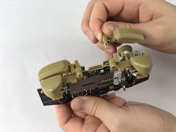

  5. PowerA Enhanced Wireless Controller L and R buttons Replacement, L and R buttons: crwdns2935265:05crwdnd2935265:01crwdnd2935265:03crwdne2935265:0 PowerA Enhanced Wireless Controller L and R buttons Replacement, L and R buttons: crwdns2935265:05crwdnd2935265:02crwdnd2935265:03crwdne2935265:0 PowerA Enhanced Wireless Controller L and R buttons Replacement, L and R buttons: crwdns2935265:05crwdnd2935265:03crwdnd2935265:03crwdne2935265:0
    • Lift the two white latches using the iFixit opening tool.
    • Lift the white covering off.
  6. PowerA Enhanced Wireless Controller L and R buttons Replacement: crwdns2935265:06crwdnd2935265:01crwdnd2935265:03crwdne2935265:0 PowerA Enhanced Wireless Controller L and R buttons Replacement: crwdns2935265:06crwdnd2935265:02crwdnd2935265:03crwdne2935265:0 PowerA Enhanced Wireless Controller L and R buttons Replacement: crwdns2935265:06crwdnd2935265:03crwdnd2935265:03crwdne2935265:0
    • Squeeze the buttons with rubber tweezers and push them in.
    • Grab it from the back and pull it out.
